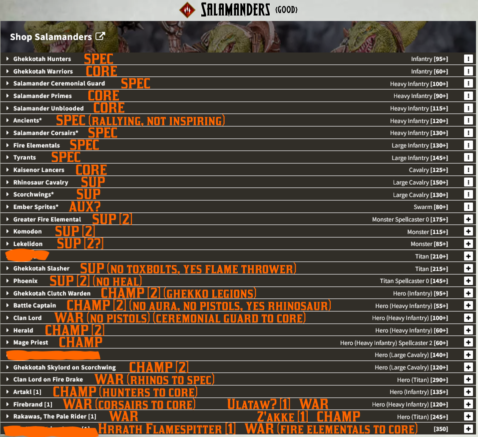

And here’s Salamanders:
Easily the most slot modifiers we’ve seen, and I’m shocked we can take fire elementals as core! (Also had to guess at Ulataw’s spelling :P) I’m guessing all the modifiers and the many heroes reflect them being in the first campaign book?
With warlord being the most restricted slot in an army, we’re seeing some real tradeoffs with Sallies. Are you modifying the battalion to fit in units you want? Or are you taking a total beatstick like Rakwas or Ulataw or Zakke? You’re probably doing two of these things in larger games, but even then, that’s only 2 warlords and I doubt Sallies are aiming for 3 battalions …
I think Salamanders with Fire Elementals in core are going to be the cheapest possible entry army into Kings of War, at least until we see if Nature can do the same.

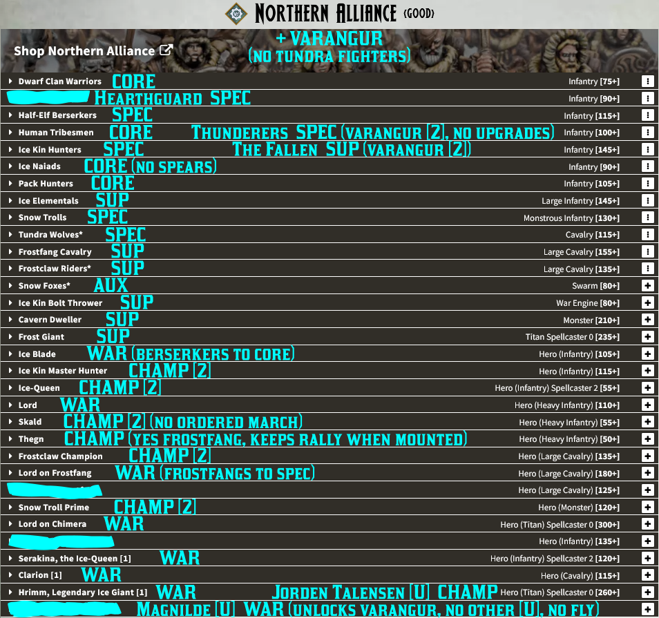

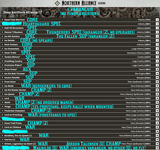

Nerve Check dropped the Northern Alliance / Varangur preview tonight: 25-032: 4th Edition Northern Alliance | Nerve Check
Here’s my breakdown:
The pod got a little chaotic - I expected to hear about more slot modifiers given the nature of the Alliance but there was a lot of commentary about the army being very infantry heavy now so maybe the warlords really are mostly face beaters? And yes, Magnilde is the only way to get Varangur units, and even then you can only take two cav units and two fallen in her battalion and that’s it ![]()
Nerve Check has Halflings coming up next, another of the Invasion armies, so expect it to be especially rich with heroes and commands.
