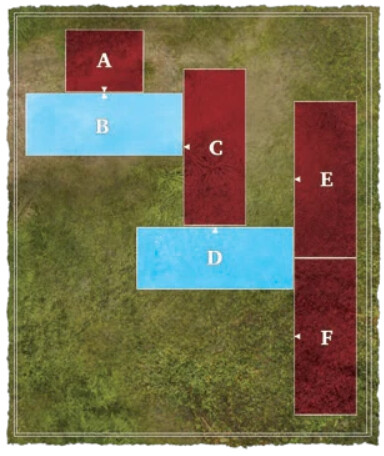

Particularly I’m looking at the example “A Larger, Multiple Combat” on page 75, which states: “In the Turn of the Blue army, the Blue player first decides how their units will allocate their attacks, before rolling any dice.”

I see where you’re coming from, but I feel the example on page 75 suggests that no, they’re part of the same combat. It shows a great big conga-line of units and says “In this situation, six units are fighting in a single multiple Combat”. I think from that we’re meant to conclude that as long as there’s a contiguous chain of engagement then it’s all the same combat.
