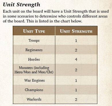

At the start of the scenario rules non-scoring units are mentioned. They either have a unit strength of 0 or are described in the scenario.
But there is no unit with US 0. Even individuals and war machines do have at least 1. And I didn’t find a scenario declaring them as non-scoring yet (but haven’t looked at all scenarios in detail so far).
So everything counts for scoring, may it be a cheap gobbo individual or a war machine far away from anything else?
And the latest restrictions for the amount of Loot counters a unit can have is gone too. So even a war machine or a swift and nimble individual (not debating about how useful this is) could have 4 loot counters?
Only champions and Warlords gain the unit strength. There are 2 heroes that it can remember being in the support slot. Steel juggernaut in dwarves and hex caster in abyssal dwarves. The hex caster has the US1 special ability but the steel juggernaut does not. So I think the steel juggernaut might be the only unit with no unit strength currently.

No value for US is not 0. It is a fault.
There are several units more without a value, like the Treeherder.
Currently there are 3 units in the game that have a US of 0, Steel Juggernaut and 2x Treeherder (Elves and FoN)
The wording on the rules is likely a holdover from a previous version, possibly before they intended on all units having at least US1. There are a bunch of cases where there is wording for a provision that doesn’t exist, such as an Order affecting only Infantry and Heavy Infantry when the Faction’s units don’t include any Heavy Infantry units.

Tree Herder should have unit strength 2 though since it is a Hero/Mon as per the US
Nothing currently in the rules gives the Steel Juggernaut unit strength. It is not a warlord, champion, and does not have the Unit Strength special ability like the Hex Caster.

Even if no value would be seen as 0 - the exception of units with US0 would be useless. There are so far 3 units out of at least more than 200. This would not justify such a lengthy description.
I would agree that this is former version and they didn’t see this mistake but had something different in mind.
