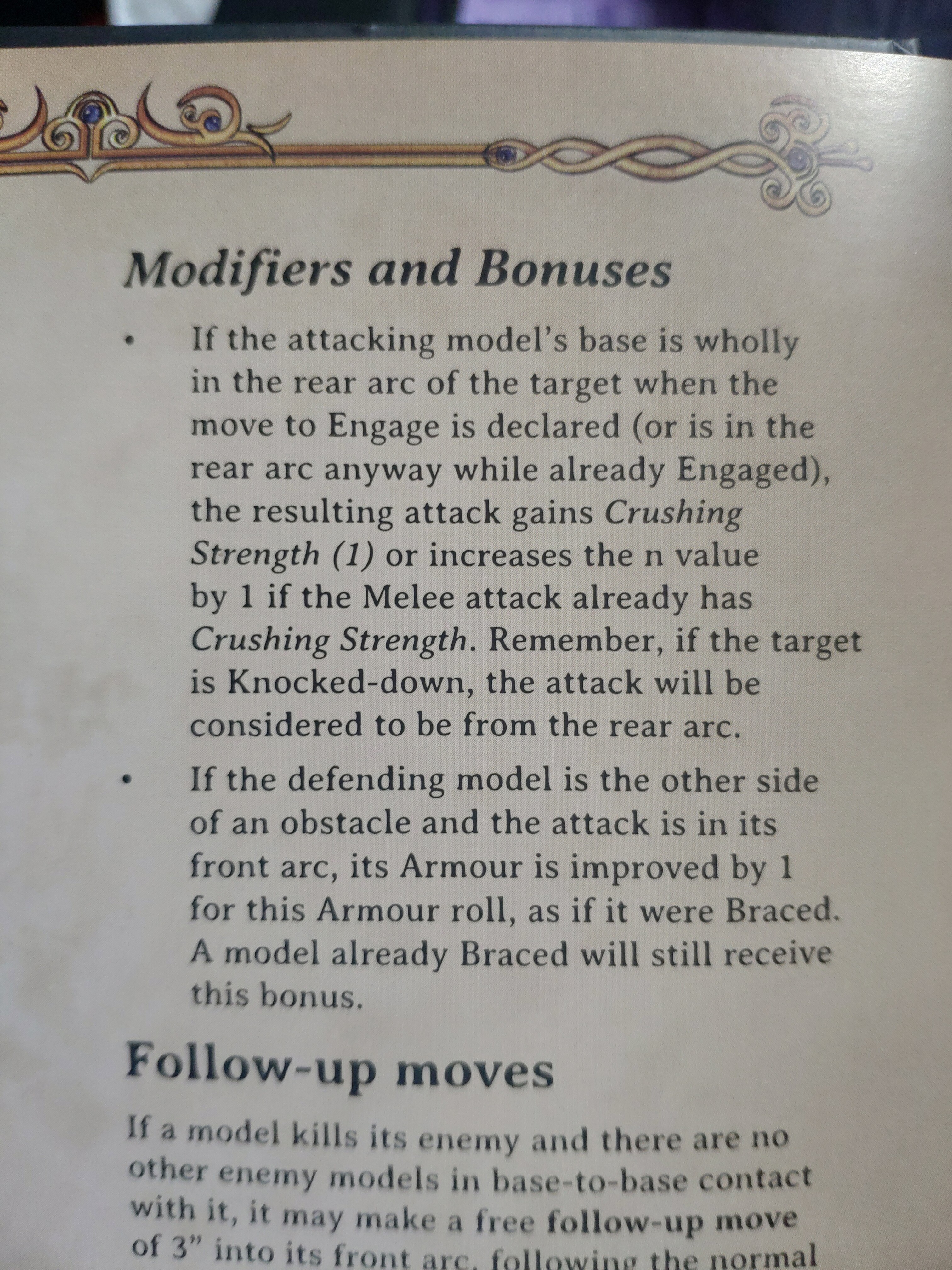

Shooting is incredibly hard to balance in Vanguard and can be pretty OP. I know why they made melee and shooting work differently - they wanted shooting to be about disrupting and degrading the enemy, but the actual feel of the game should be dramatic melee battles. It’s hard to get right, and lots of games struggle with it…
That wasn’t one of the things we cleaned up in 1.1 :slight_smile: rear attacks have always been like that, since the Kickstarter hardcover
Back from the Grave only works on STANDING models. If you knock them down (whether through shooting or otherwise), if you shoot them and wound them, they still have to take a nerve check and can be removed if they fail.
