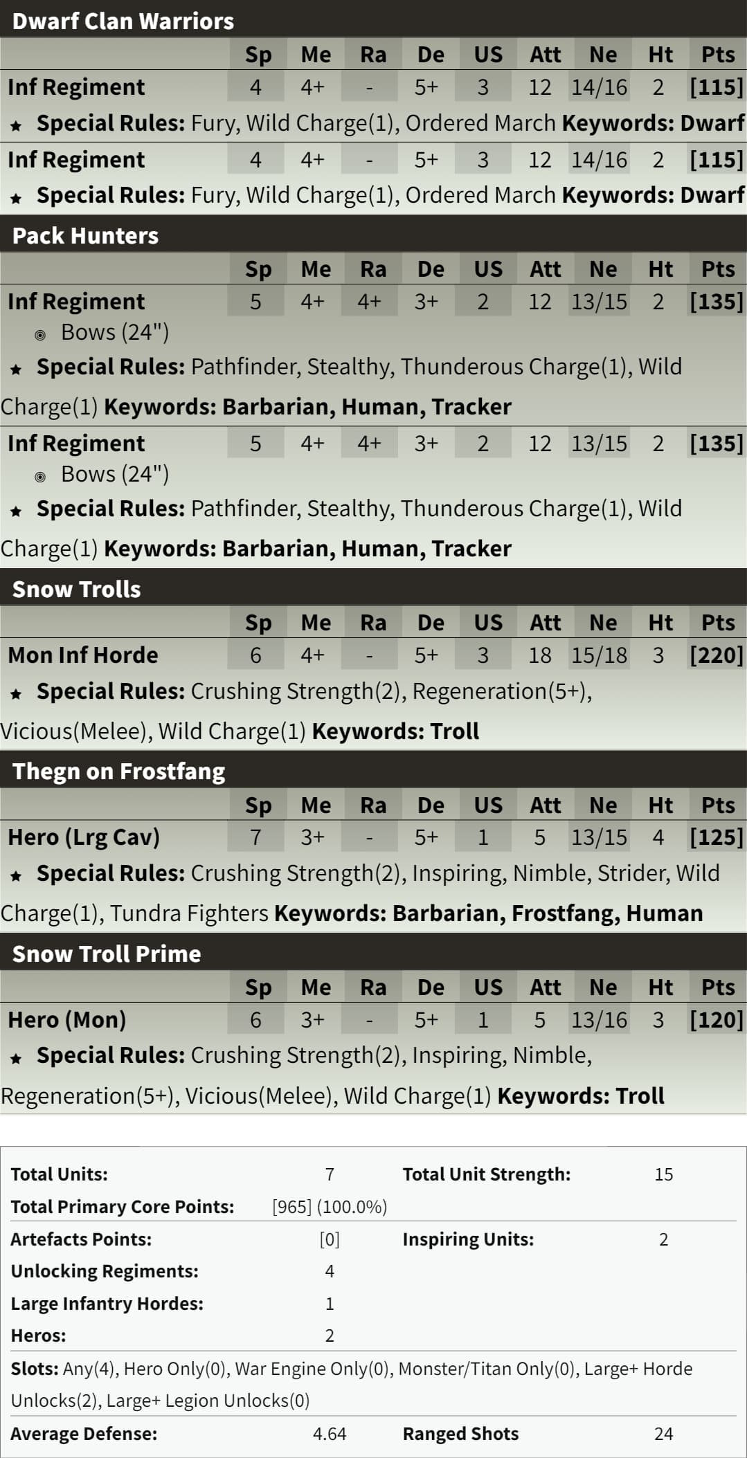

You have 35 points or so to customize (Chalice of Wrath, Trickster’s Wand…) Speaking from experience, I think you use your Pack Hunters (and Ice Kin Hunters) particularly well, so you would do well to include them. Likewise, the Dwarf Clan Warriors tend to do well in scenario play for you, or just delaying and holding things up since they come with Fury. And then with Regeneration, the Trolls tend to survive unless they get multi-charged by multiple hammers.

so my suggestion is to bring half a of a combined arms list. Using Northern alliance, I would go heavy infantry. Huscarls, snow trolls (challice of wrath) supported by a lord on frostfang and slow troll prime. Conclude the army with some slow foxes and timber wolves as chaff/light cavalry and you have half of a hard hitting force.

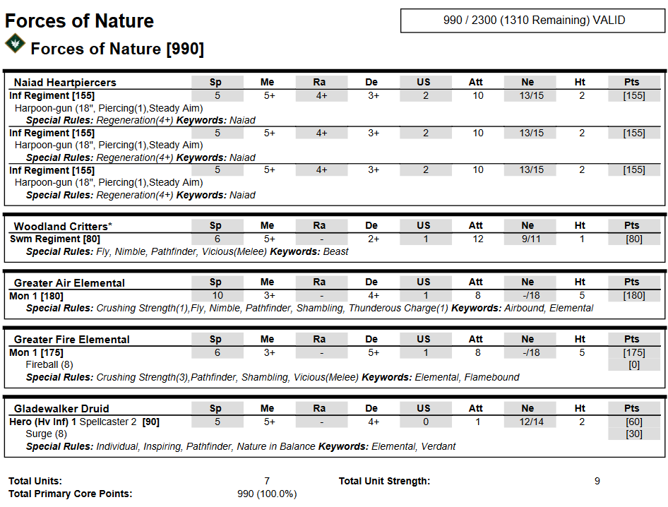

Instead, I would use (for instance) a Force of Nature list centered on heartpiercers supported by surged elementals such as:
This powerful enough and will supplement a lot of other builds.

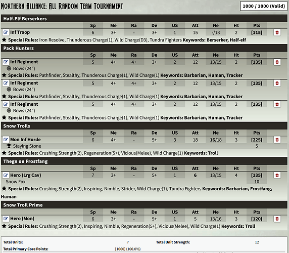

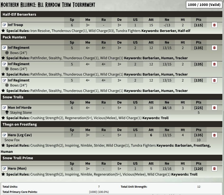

Here’s something between @TastyBagel and @Vince :
Shooting skew to make something happen, troll anvil, your allotment of excellent nimble value squares, and I decided to go with Berserkers over Tundra Wolves because they’re unique to NA and can really lift if ignored. That said, a wolf troop would also be cool as dedicated chaff and a decently threatening nimble, pathfinding flanker.
