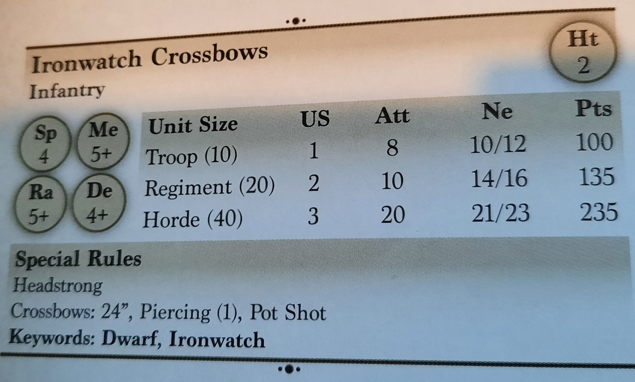

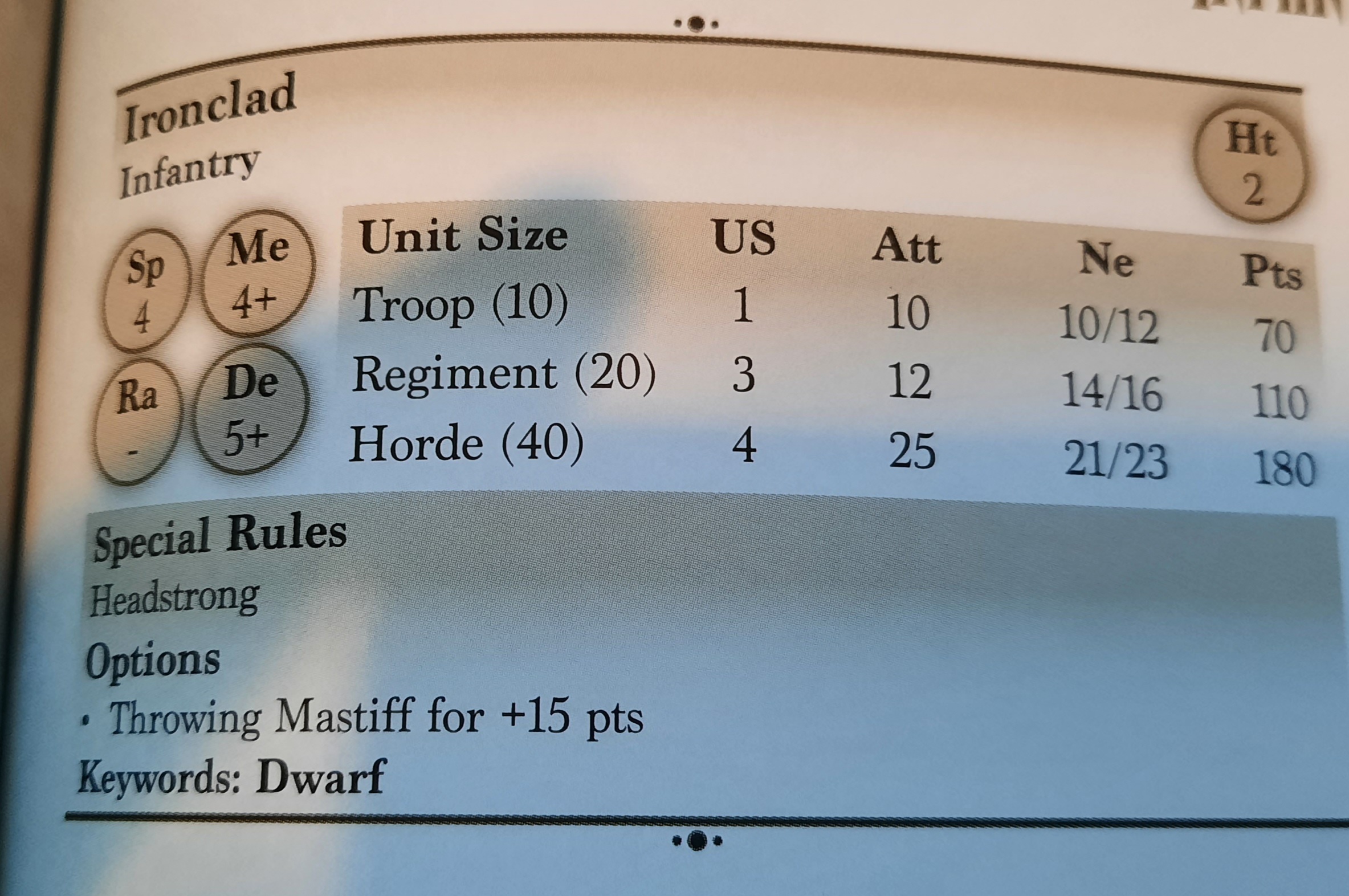

I think this demonstrates the issue.
The Ironwatch should have no less attacks in melee than a unit of Ironclad.
Taken as a Horde the Ironwatch for an extra 55pts over a horde of Ironclad, they get less Unit strength, less attacks, worse Melee stat, worse Defence stat. While piercing (1) at 24" is nice hitting on 5+, statically that is 4 hits from 20 attacks. Where as the Ironclad are getting 12.5 hits from their 25 attacks.
This is before terrain, Ensnare, Stealthy, etc are factored in. The Ironwatch may be able to attack from range, but they can be shut down very easy. A fast unit (mounted Hero) can engage within 2 turns, and only needs to do a single point of damage (which with their Def of 4 is not out of the realms of possibility) and the Ironwatch are disrupted and can not shoot in their next turn.
Now if the Ironwatch unit retained the same number of attacks as Ironclad, but had the current number of attacks on just their crossbows it wouldn’t feel as bad an investment. As they currently stand, it feels like a player is paying a substantial amount of points to make their unit worse.

And 5+ with 20 attacks is 6.66 hits, not 4? And those hits have a better wounding chance than the ironclad hits and at range. So against armour 4, they do 4.4 wounds at 24", while the ironclads do 6.3 in melee, with the difference reducing as the defence increases (both do just over 2 wounds against defence 6). Not so great a difference. The Ironwatch will also still do 3.33 wounds in melee.
I’m not saying the ironwatch are the best option, I agree they are overcosted somewhat and a slight reduction in points seems the best solution to me. But my mate uses two hordes of them (one of x-bow, one of rifles) pretty well. Combined with a few war machines and warsmith it can make a mess of high defence opponents, and if you commit enough to kill it you risk being overwhelmed by four more hordes of melee troops. And looking at damage output is only one factor to consider with these too. It’s also a big bunch of unit strength that needs quite a lot of resources to actually kill.

Both units used in the example have the same number of models, and aren’t elite options within the faction they belong to. They are both bog standard units for their faction and both have hand weapons as their melee weapon. Hence why they should have the same number of attacks, the Ironclad should (and do) have a better melee score, this reflects that they are a melee unit, where as the Ironwatch with their bad melee score reflects that they are not a melee unit.
I did my maths wrong, I was doing 1 in 5 hits, 20 divided by 5 is 4. Even running with your more favourable 6.66 is nothing to write home about, piercing (1) does help those attacks change into damage a lot easier. However such a unit hasn’t got many turns shooting, due to again how easy it is to shut them down. A cheap mounted hero is a threat the unit can not contend with. They drop to hitting on 6’s (again before terrain) due to the individual rule. The hero due to being an individual has a 360 charge arc and a threat range of 16"., this allows said hero to get into their flank where they can not attack from.The Ironwatch can not afford to pivot and shoot as that will reduce their already limited damage potential. A single point of damage from the hero in melee and the unit is shut down.
I did factor in Unit Strength, hence why I pointed out that the Ironwatch lose a point of Unit Strength compared to the Ironclad. Also, Ironwatch units are not going to be doing much movement towards objectives, so their Unit Strength isn’t that useful. They are a static ranged attack unit that is a bad choice.
A horde of Ironclad with diadem of dragonkind is a far better ranged attack unit. It can move and fire with no negative impact, has better melee, ranged, defence and unit strength stats. Oh, and the unit is still cheaper by 25pts, even with the magical artifact. It has less range, lacks piercing (1), and less ranged attack dice. However due to have a Ra 4+ and steady aim, it has a lot more flexibility with its ranged attack. Pivot move 4" and fire.
