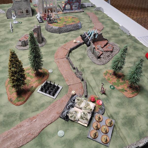

Ruins are a set made with foamboard, sprue bricks and kitty litter. And 3D printed windows. Oh and special wallpaper I imported from england because someone made scale rock wall wallpaper for some reason. You can see some bigger ruins marking the edge of the Ambush battlefield.
Road is calk put down on flexible vinyl flooring. Trees are some railroad pine trees I had laying around mounted on washers. The forest bases have 3D printed sabots that fit those washers and magnets but I don’t think I installed the magnets which are really needed for top heavy trees.
Wall is 3D printed. There is a set of 1" and 2" xps foam hills. I tried the rock texture applied to foam method but I should have gone with that metal ruler method instead I think.
Not in the picture are some hedges made with gutter leaf filters and flocking. I mean cavalry are having enough trouble in out Ambush games without even more obstacles.

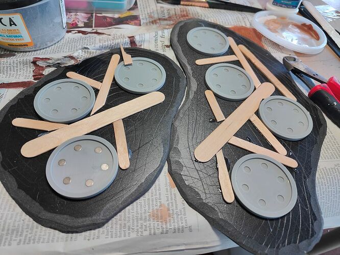

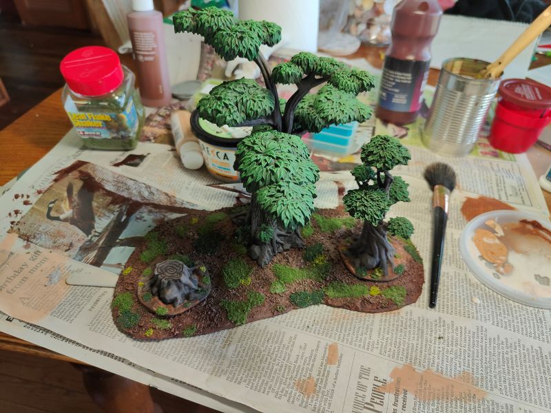

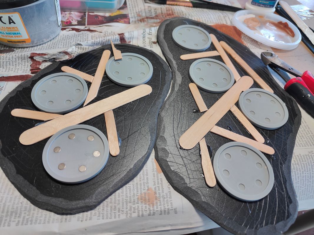

The forrest bases made with epvc plastic stiffened with popsicle sticks.
Then everything but the printed bits is covered with some ground filler (I used caulk because I figure that will hold up to game store abuse). After that texture, paint and flock. I do like to have fallen trees and stumps to remind the more literal minded that it’s supposed to be a forest not a orchard.

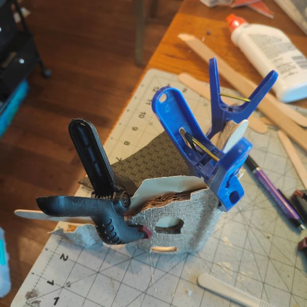

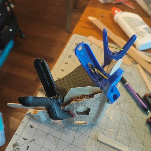

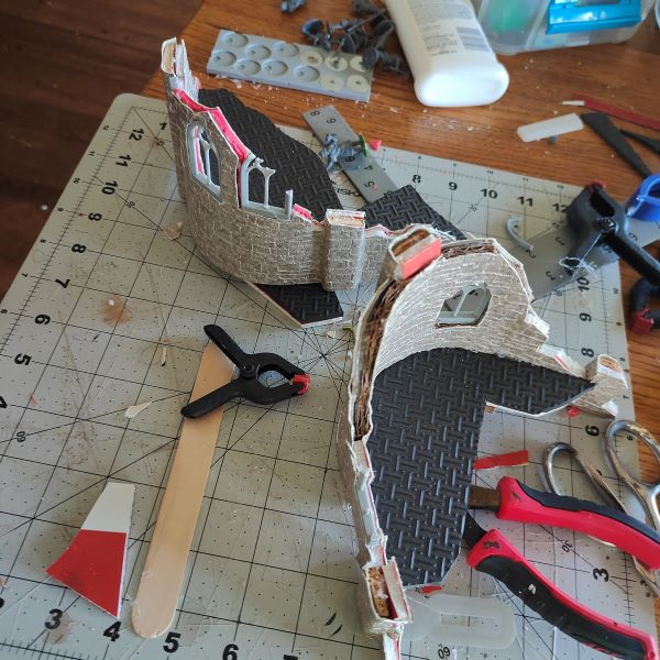

Here is a pic of a ruin under construction with the wall paper drying under clamps. I do like to avoid just making corner ruins even though it does make applying the wallpaper trickier. In this case the rounded ruin is based on a cannister that held nuts in a previous life. Then the ruin is extended with foamboard.
After it’s dried and trimmed you can see that I’ve used some kind of wood trim to make "columns and that I tried a few materials to bulk out the cardboard cannister to match foam board thikness. The textured floors were made with some textured foam that a friend that works in retail gave me. Something like packing from flat packed furniture or so.
That same friend gave me foamboard encased in plastic instead of paper and I like to use that for these kind of ruins just to be a bit stronger. You can see a bit of it in the bottom left.
