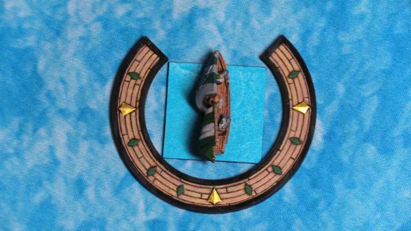

One of the largest issues I had with Armada during the discussion was templates breaking movement, specifically center rotations for squadrons. When I was later asked about how I worked around that, I thought I would put up my solution to retain precision for tiny bases… (actually, first I had to replace my card-cut originals with some prints designed around the same measurements that would be more photogenic)
The interior of the ring allows the 30 mm square tiny base to be spun around up to 270 degrees while keeping its center-point in the same position, and I made these 4 mm thick to have some stability on the table while moving the ship’s base back and forth.

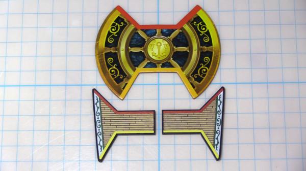

More than these aids to pivoting, another template that I started using last year are these modified turning templates…

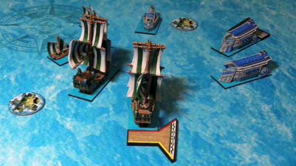

The production turning template is great for ships out in the open, but when you are close to other ships or terrain, we had continuing issues with trying to get that one in between obstructions to get a clear placement. By splitting the template, it is much easier to place it onto the mat when ships are close to each other and get a good turning angle away, and I made these reversible so it does not matter which side of the base is lacking clearance…
The overall size of the split template is a little more than half that of the production template, and still allows a little customization to match my fleets with the same red 45s and yellow 30s marked on each.

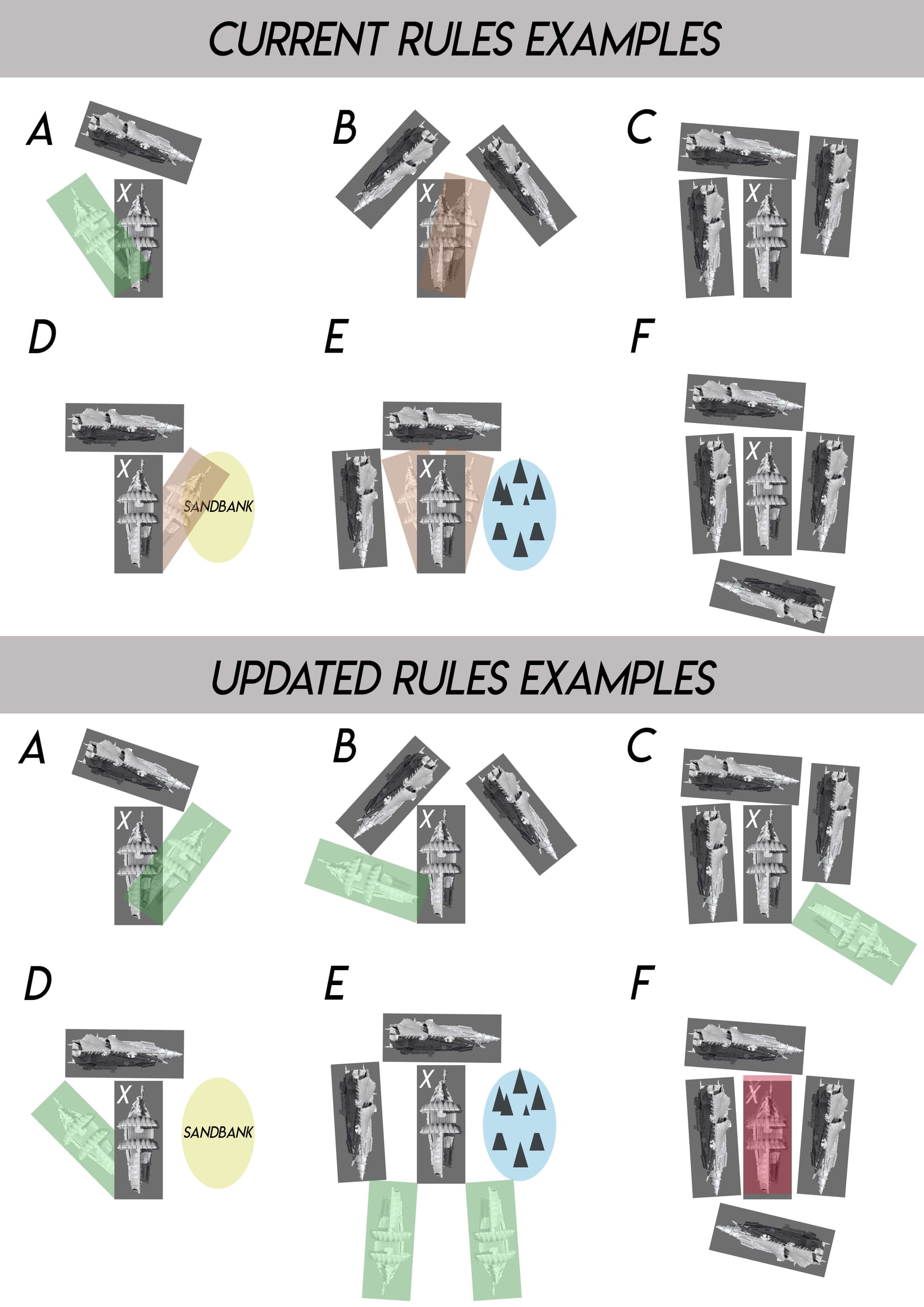

The idea behind the Collisions errata is twofold.
The main issue with the current ruleset is ‘error 404’ situations where rules just does not cover a solution. Like what if there’s another ship in the way when you pass an Evasion test? Do you test again then come back to test against the previous target? Or what happens if you can’t physically change course? I’ll let the visual examples speak for themselves:
So the second reason is pure fun factor. My meta is pretty fun oriented but we have a lot of top tier players from other games. I’m talking national champions and in some cases seasonal world championship veterans. We quickly started using collisions to stun-lock large ships, steer them towards rocks and islands. Is super easy to do with the original ruleset. For this reason I figured a way to smooth things out both in terms of playability and casual play. Now you ignore anything in the way of the obligatory turn after passing an Evade test, or after the Collision. You set up in a way that will not take you into another collision in the following move step. 99% issues solved.
