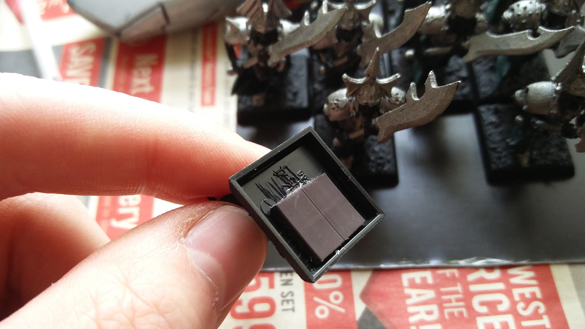

Under the bases are slices of rubber magnet. By luck, the ones I got were the perfect thickness.
I did not opt for neodymium magnets because of the cost, but mostly because I didn’t want the connection to be so strong that the other parts of the model break off!

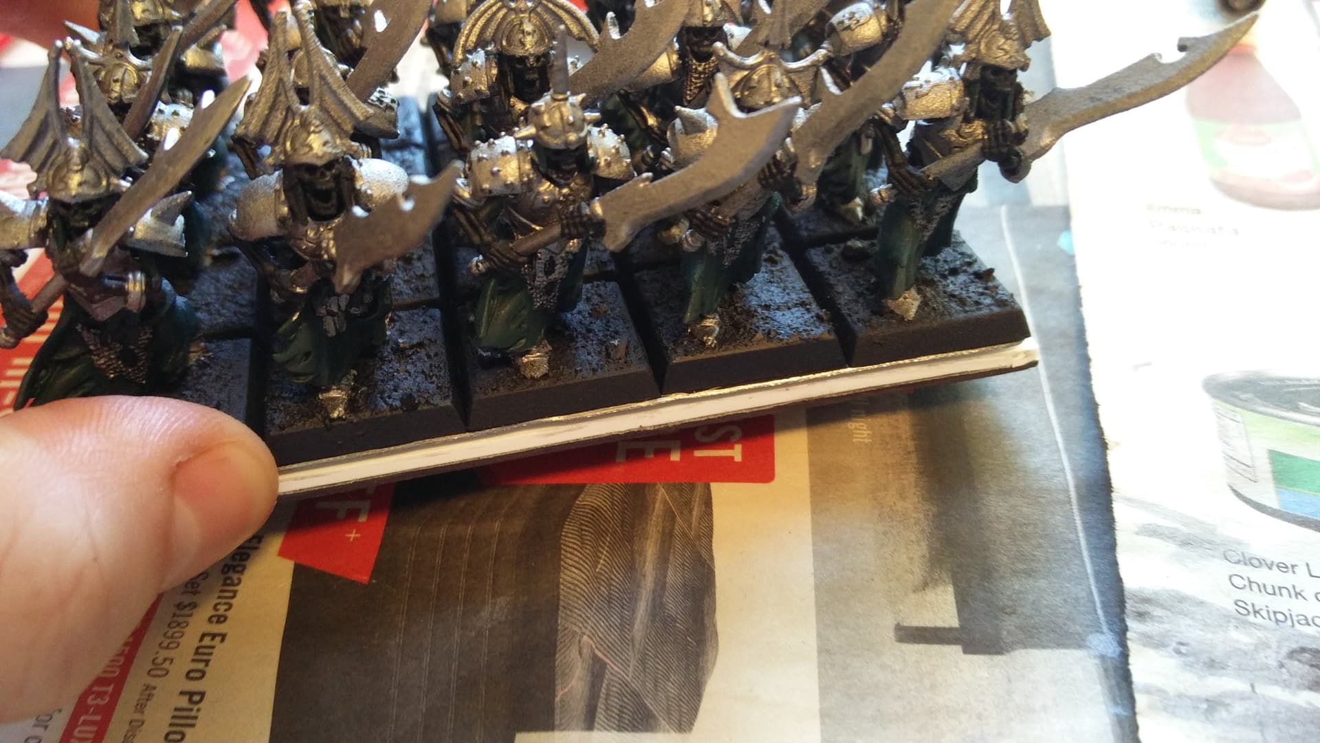

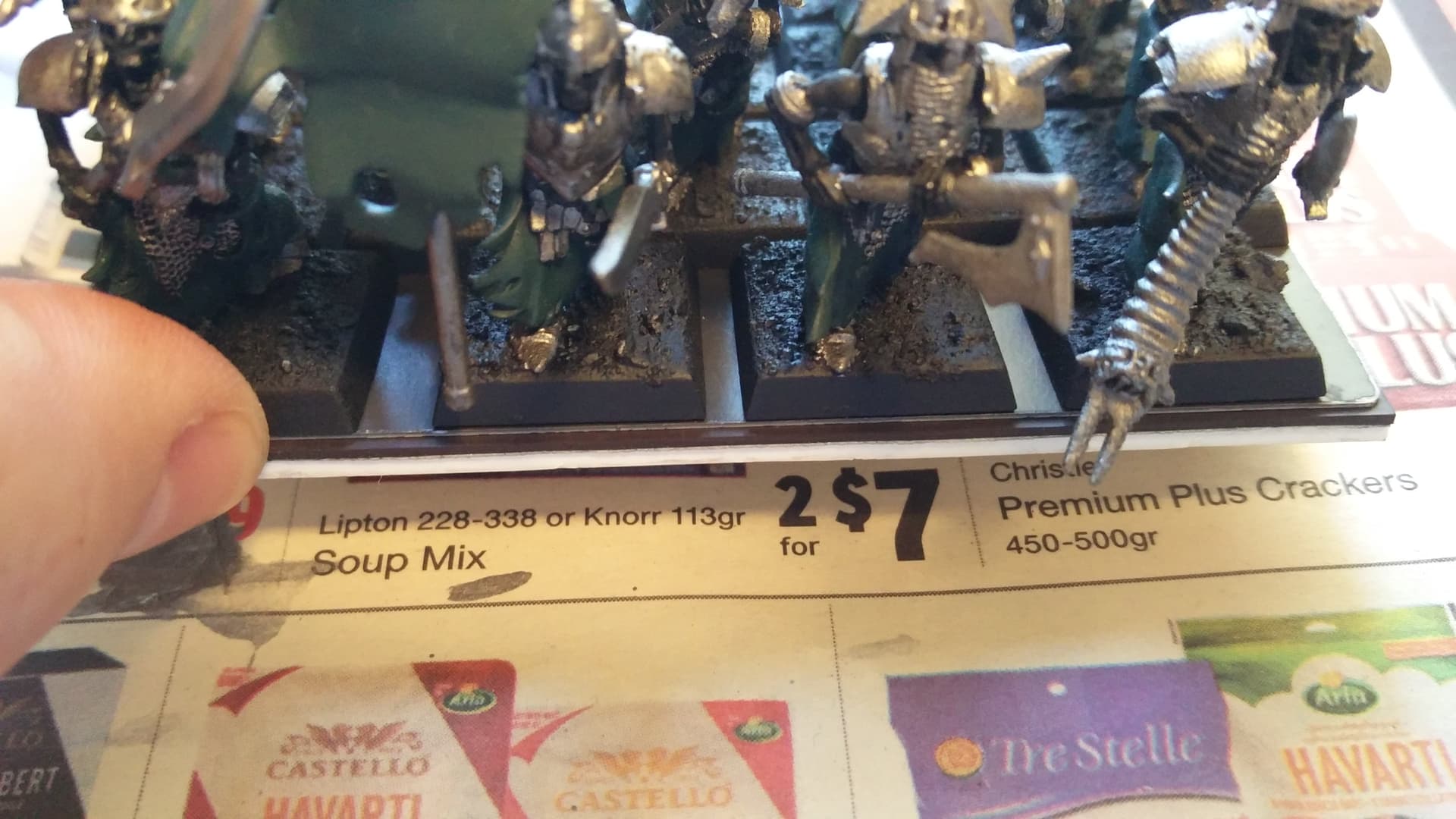

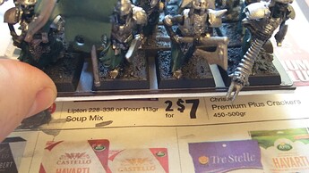

I initially put rubber magnet on sheet plastic for the movement trays. But even with correct polarity, there are places where the models like to be and places where they don’t. That is, if I place a model down on it, it will ‘jump’ and magnetise to one location, the next model will ‘jump’ to another and not rank up quite nicely. So, magnet-on-magnet didn’t work for me.

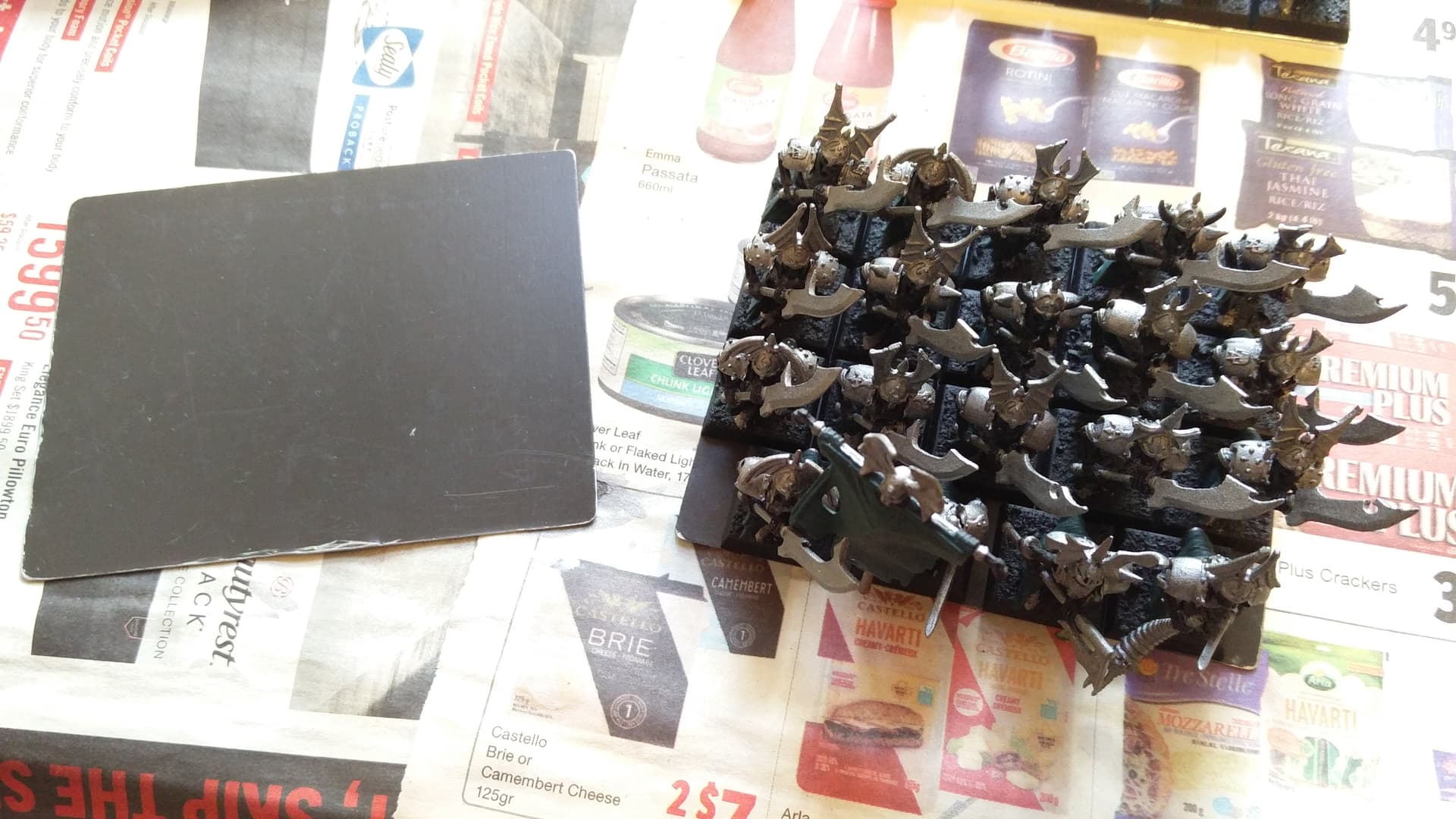

I am now trying out sheet metal. I can’t remember if it is stainless steel or some other material, I acquired it a while back.

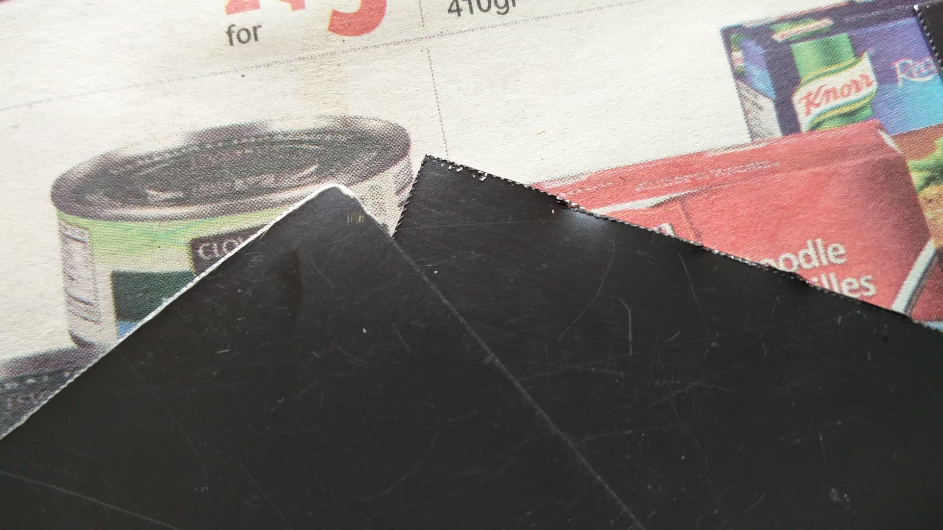

I cut out the shapes with sheet metal cutters. It was a bit frustrating but managed to make movement trays with the correct dimensions and minimal bending. I used a grinder (some off-brand Dremel that I have) to smooth the sharp corner and edges.
The piece on the right in the above image is rough and sharp. The piece on the right is smooth with a rounded corner.

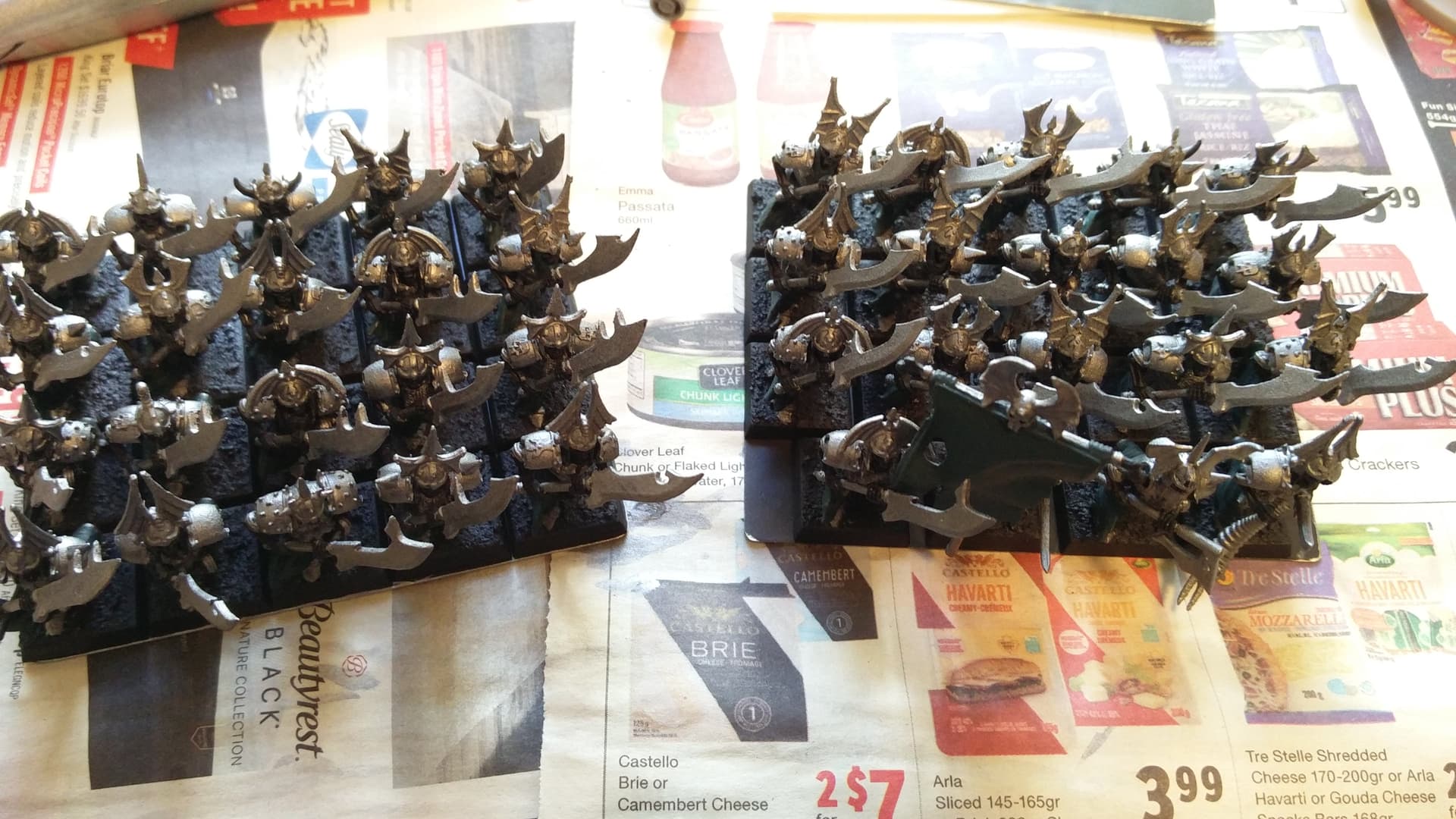

Here is where I am at now:
(which I’m pretty happy with)
The current problem is that it is so thin that it is kinda difficult to pick up and move around. I can mount/glue them onto sheet plastic. But then they won’t magnetize to a magnetic carrying case, which would be the next big step of this project.

What if you glue the steel sheet onto a piece of mfd (of matching size) and then drill magnets into the bottom of that mdf again. The added 3mm from the mdf would make it easier to pick up and also give it a nice flat edge. The added magnets would make it stick to another steel surface.

basically just flip this over, then get a really goopy glue to stick the sheet metal onto the white plastic. I’ll have to think about it.

the sheet plastic is 2mm. with a rubber magnet sheet on it, it is 3mm.

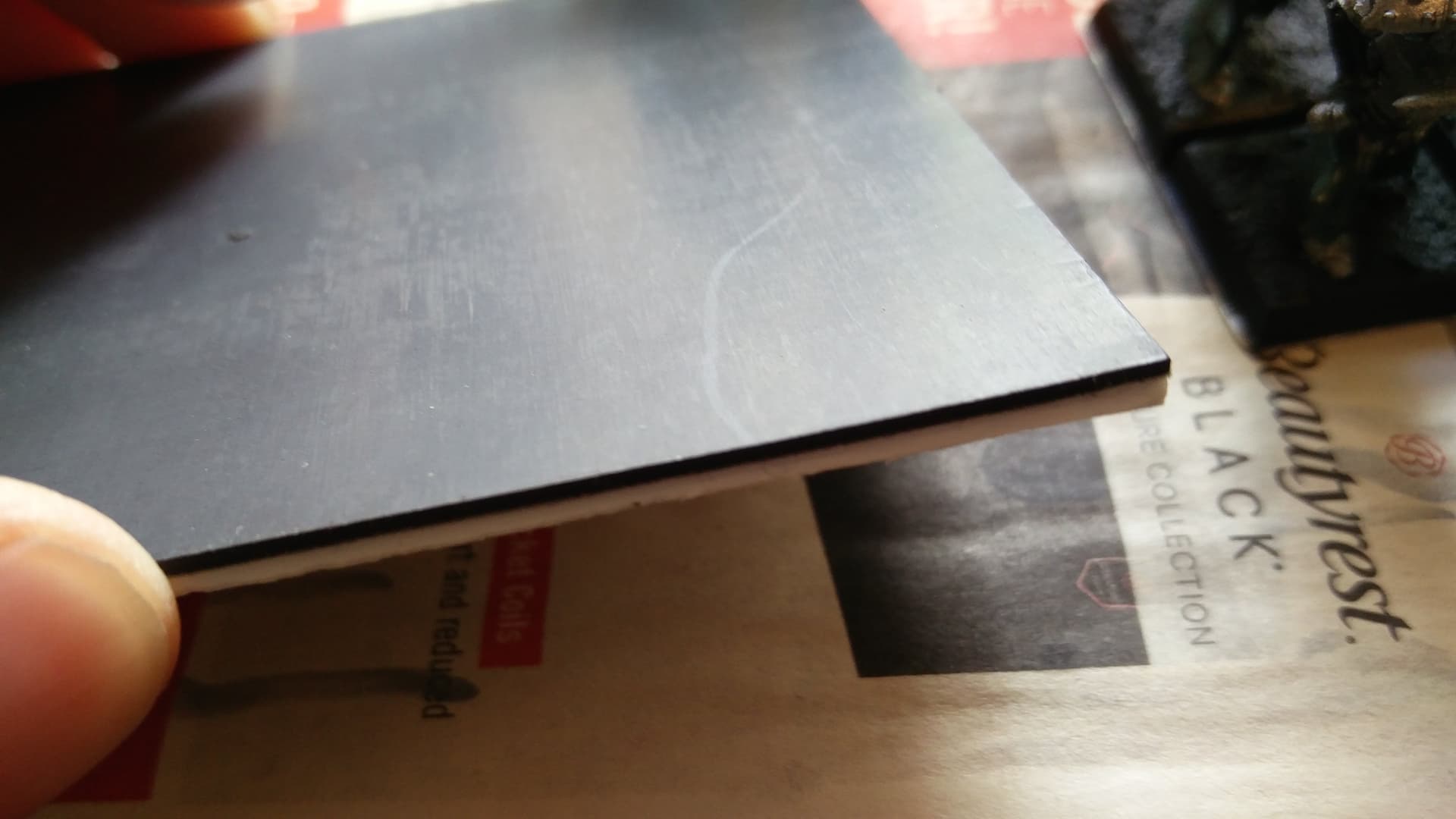

But so far I’m thinking I either find a glue to use to bond the metal onto the plastic, with the rubber magnet on the bottom like this:
Or I use it the other way around and let the metal magnetize to the rubber magnet. Then to pack up I remove the metal sheet with models and place it in a magnetized carrying case. … which is probably more finicky.
The first option is probably more practical.
That way you end up with magnet sheet in the bottom, facing down I assume, so you could stick the unit into a storage container with metal floor?
