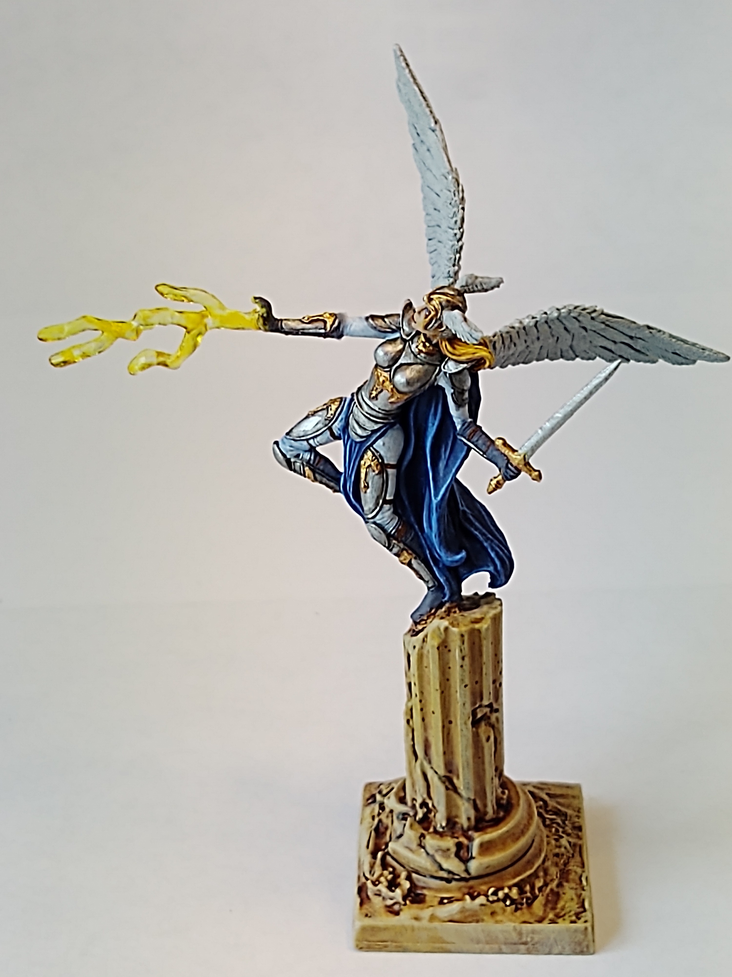

The lightning on this (which is slightly translucent IRL) is contrast blue over clear plastic
Yeah it needs to be something really thin like that. Any normal paint would ruin the translucency and basically make it uglier, I think.

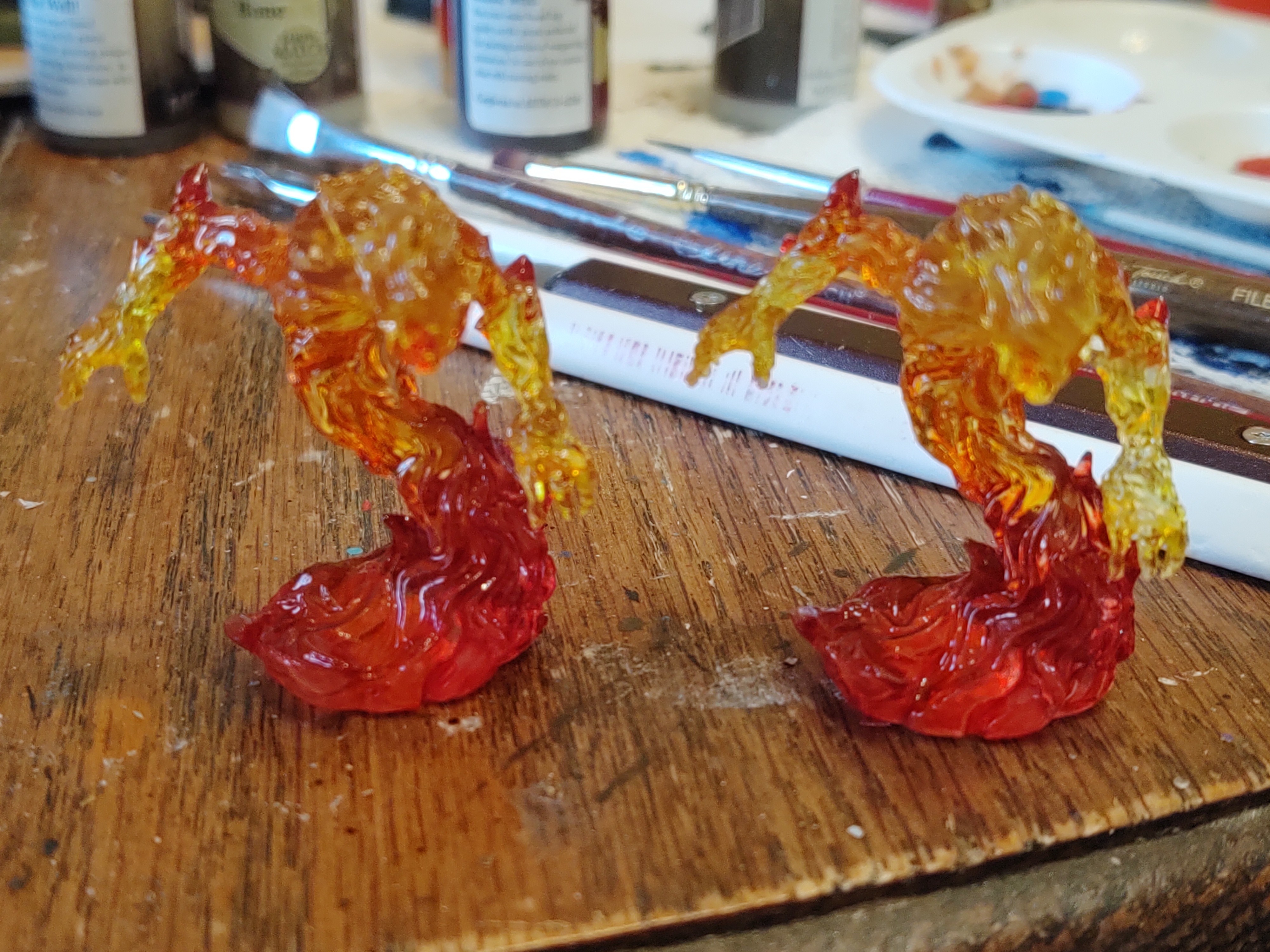

I use inks if I am going to color them, here is an example using yellow (left) and red/orange inks (right) on transparent minis. These are acrylic artistic paints (Daler Rowney Fw) you can pick up at any art store.
I was going to suggest the same as @kodos

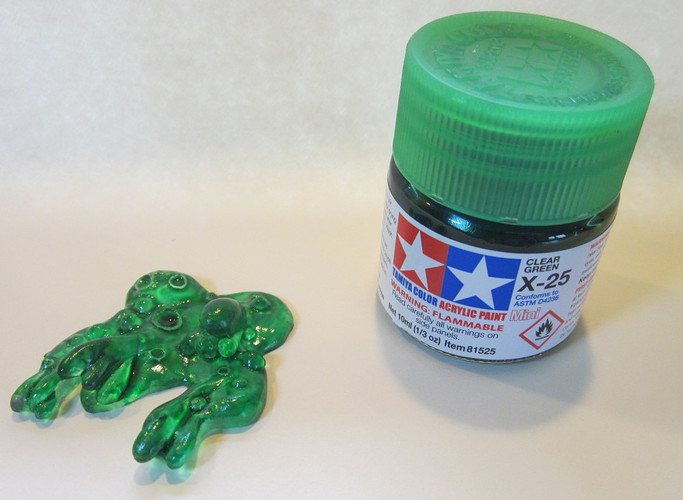

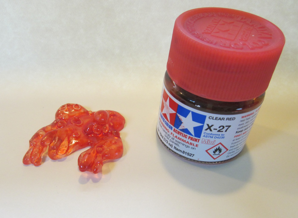

I use the Tamiya ‘clear’ colours for exactly this
Tamiya paints don’t brush well, they’re more suitable for air brushing and stink to high heaven. A good alternative to them are Badgers ghost tints. They’re similar but not solvent based. I’ve brushed them on fine in the past when I struggled with tamiya. The only issue is they split over time so you have to give them a good shake every few months to keep the bottle healthy when Tamiya don’t.
never had any problems using the “Clear” paints with a brush
but yes they are nut suited for advanced techniques like blending with other paints but really just there to give clear parts a colour or make some special effects (Clear Read+little bit of Black gives the best “fresh” blood effekt, and using them over a silver or bronze surface for a coloured metallic was unmatched until Citadel Contrast came out)
