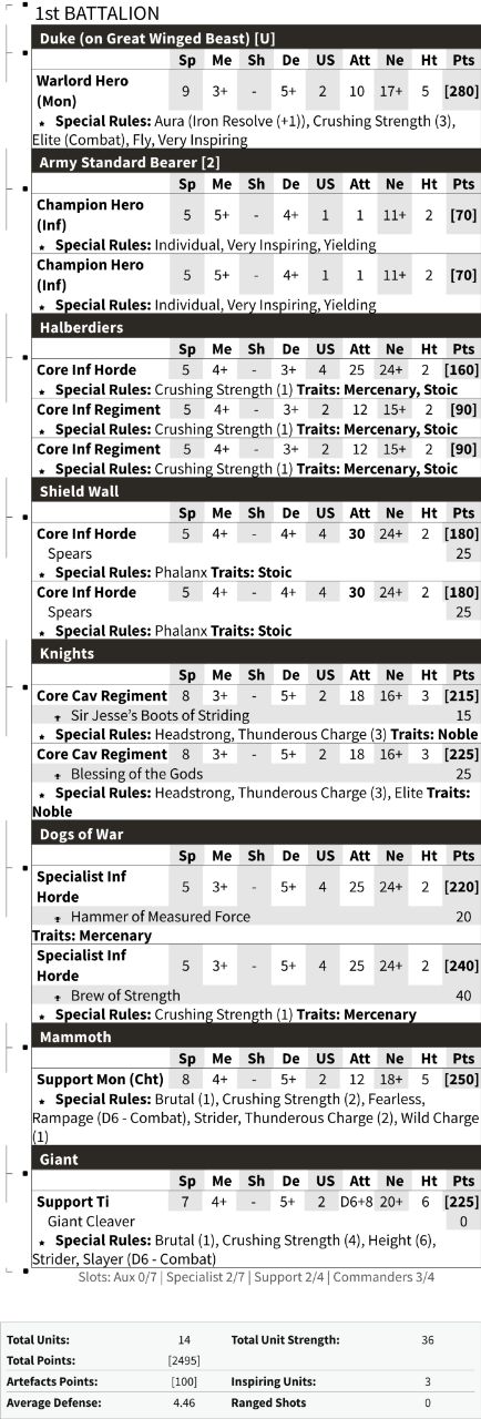

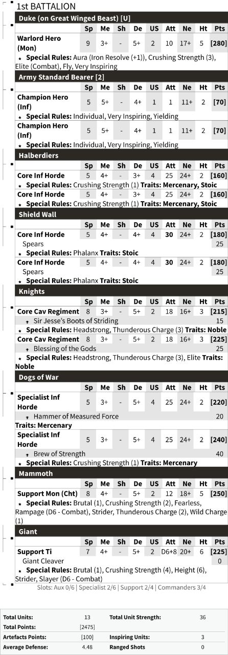

Better many hordes or many regiments?
Is it better to have a list like this or to break up some hordes into smaller FootGuard regiments?
I like playing lots of hordes, but I’ve seen that they tend to get stuck once in movement.
(I don't have any beast knights yet, so I can't deploy them)
I’m a big fan of running hordes, but you do need to make sure you have units you are happy to just dump on random objectives - which you’d have to use a halberdier horde for?
13 drops, of which 11 are scoring, is pretty low for 2475 list, esp when you don’t have a huge amount of speed/mobility?
I’d probably look to swap out a horde each of halberdiers and spearmen for 1 halberdier regiment and 2 regiments of spearmen.

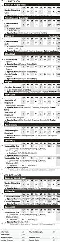

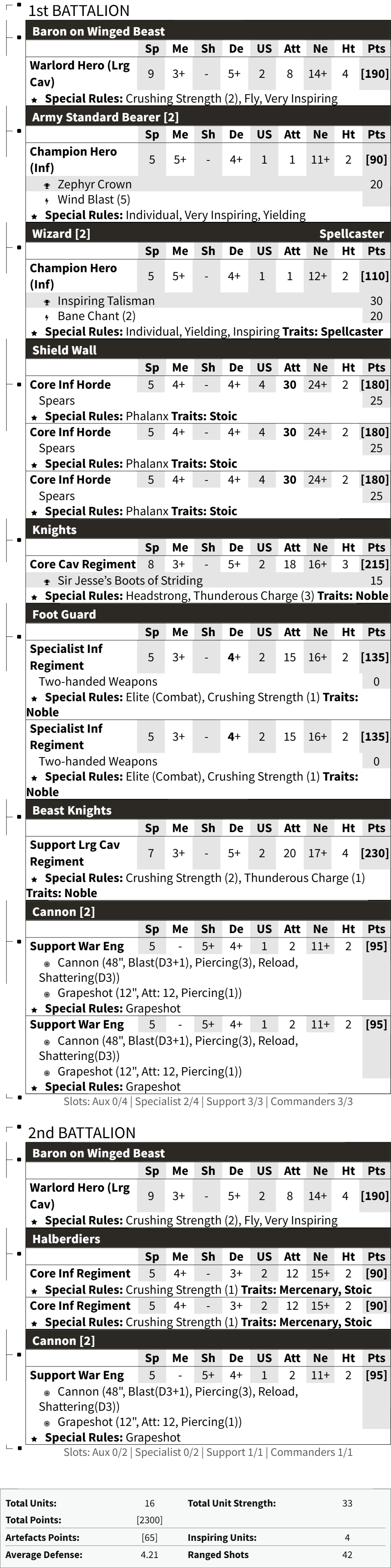

This is my 2,300 point army (16 drops) which utilises this mechanic. Don’t skip on the 90-point halberdier regiment, it’s dirt cheap and can do some damage while blocking chaff just well.
This army utilises 3 cannon which I do like but must be to your taste. Instead of the cannon, the army does work well enough with other units (troops of light cav for instance) but in that case I’d probably drop a few units for additional punch.
The single unit of beast knights are really good, but ordinary knights do well too in a pinch, provided you can keep them out of terrain.
Looks nice, do you recommend replacing the duke on a monster and a foot monster with two barons on a beast?
I’m still wondering if it’s better to play two hordes of pikemen for 270 each and the rest in regiments of foot guards…
The monster mounted duke is definitely more of direct threat than the baron version, but it really depends whether you can get the best out of the former?
If you are looking to run 2 of the latter, the giant is probably a better choice to keep than the mammoth (although I do quite like them).
You could just swap duke with baron and use points to turn a standard bearer into a wizard with the inspiring talisman, bane chant and another spell of your choice?
Thats for sure, but he is expensive.
I’d rather have 2 monsters with 8 attacks each than a single one with 10 attacks.
