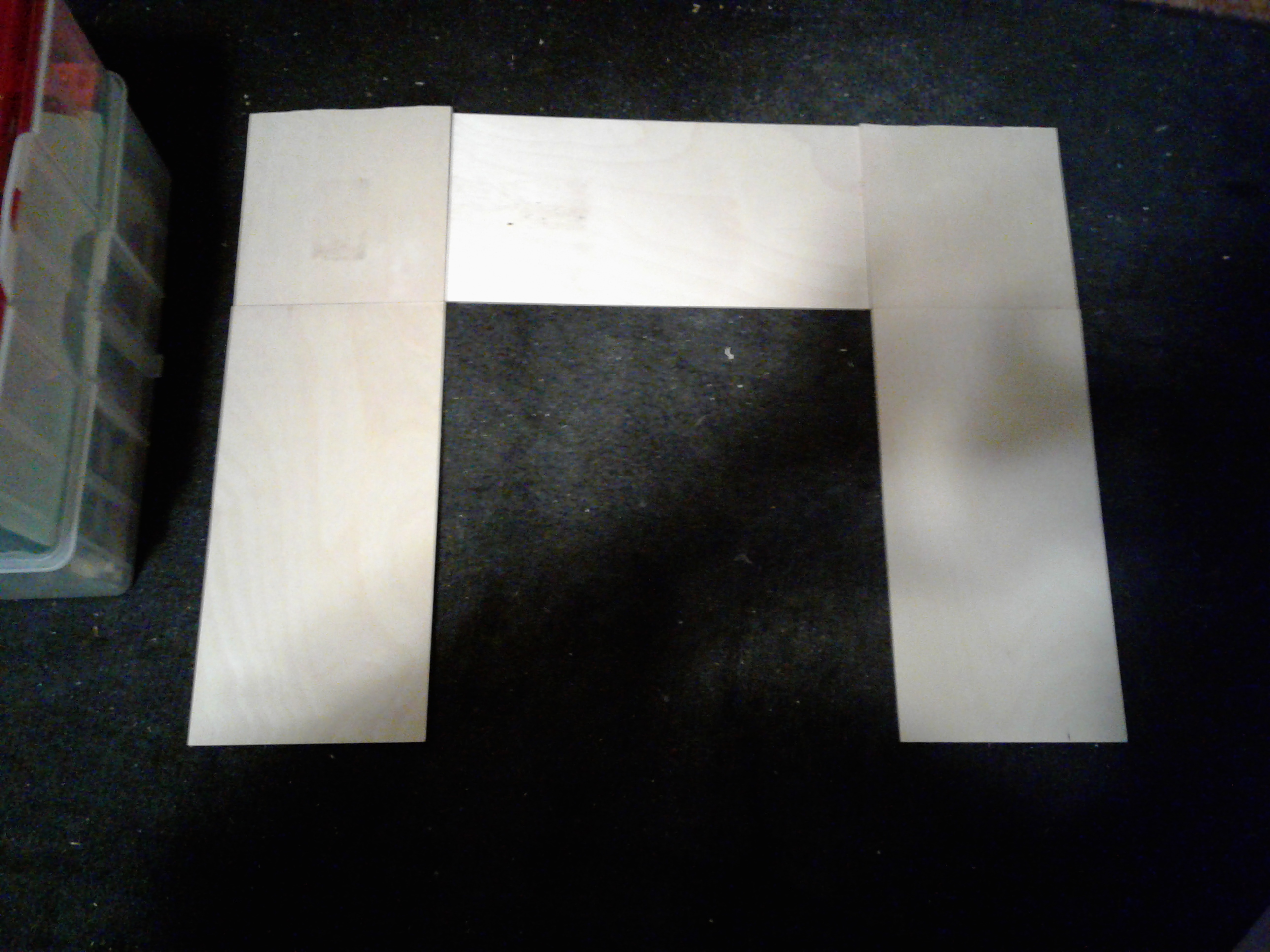

Started on a castellum limes (border fort) for my KoM romans the other day. Cutting the foam which will make the turf embankment walls. Will be shaping the foam when I get back after the holiday.

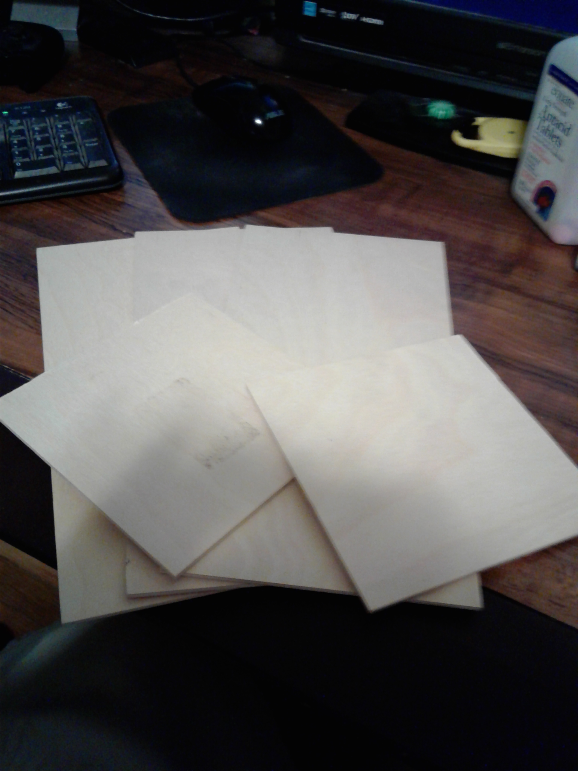

![20191125_234004|666x500]

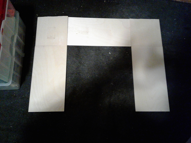

The boards are 6 inch by 12 inch, one of which was sawed into 6 inch squares (not entirely evenly.) The foam is 1 inch thick polystyrene insulation, cut from a 2x2ft sheet. It is doubled up to make embankments of 2 inches height, which will get a 2 inch pallisade wall (made from bamboo skewers) on top. This will let it act as a castle in seige scenarios. Two corner towers, a gate-wall, and two side walls. The tower corners will be just open fighting platforms, since the towers in seige games are the same height as the walls.

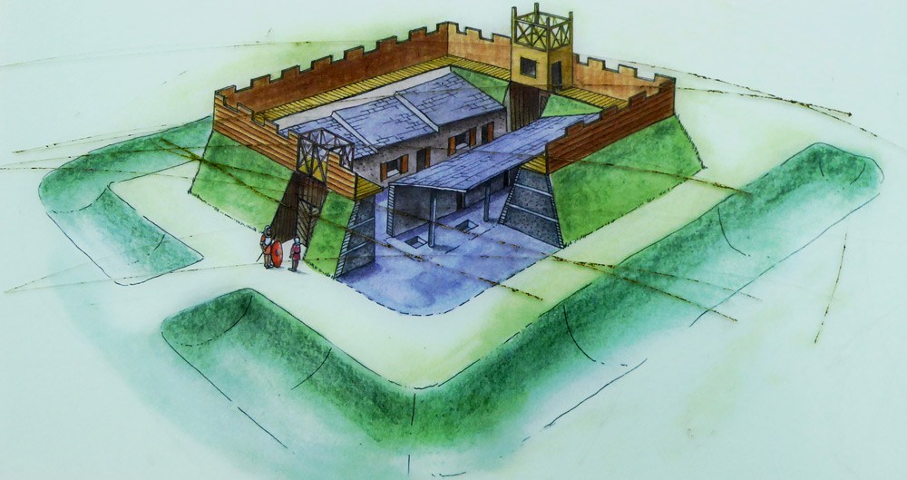

The fort is being based off the mileforts of the Hadrian era Roman cumbrian coastal defenses, such as milefortlet21. With the barracks space built right up against the embankment wall. (Which should make for a good ā€˜step’ to hold unit bases up). With a fair bit of reinterpretation to fit the KoW castle rules. the end result will probably not look very roman, but should be generic enough for use by any of the KoW factions. with a few scatter terrain small houses inside would probably also be able to double as a small fortified village for a vanguard game.

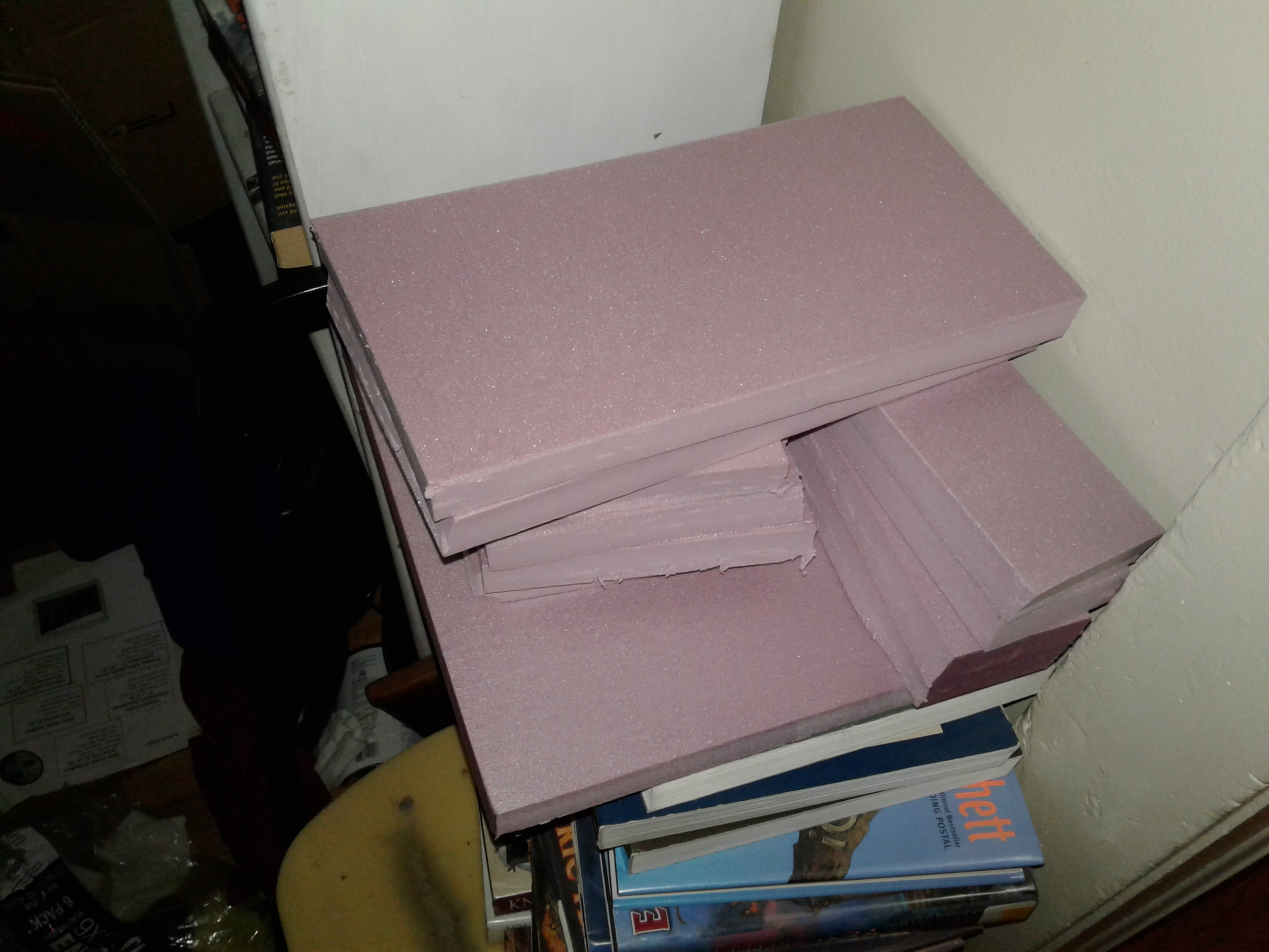

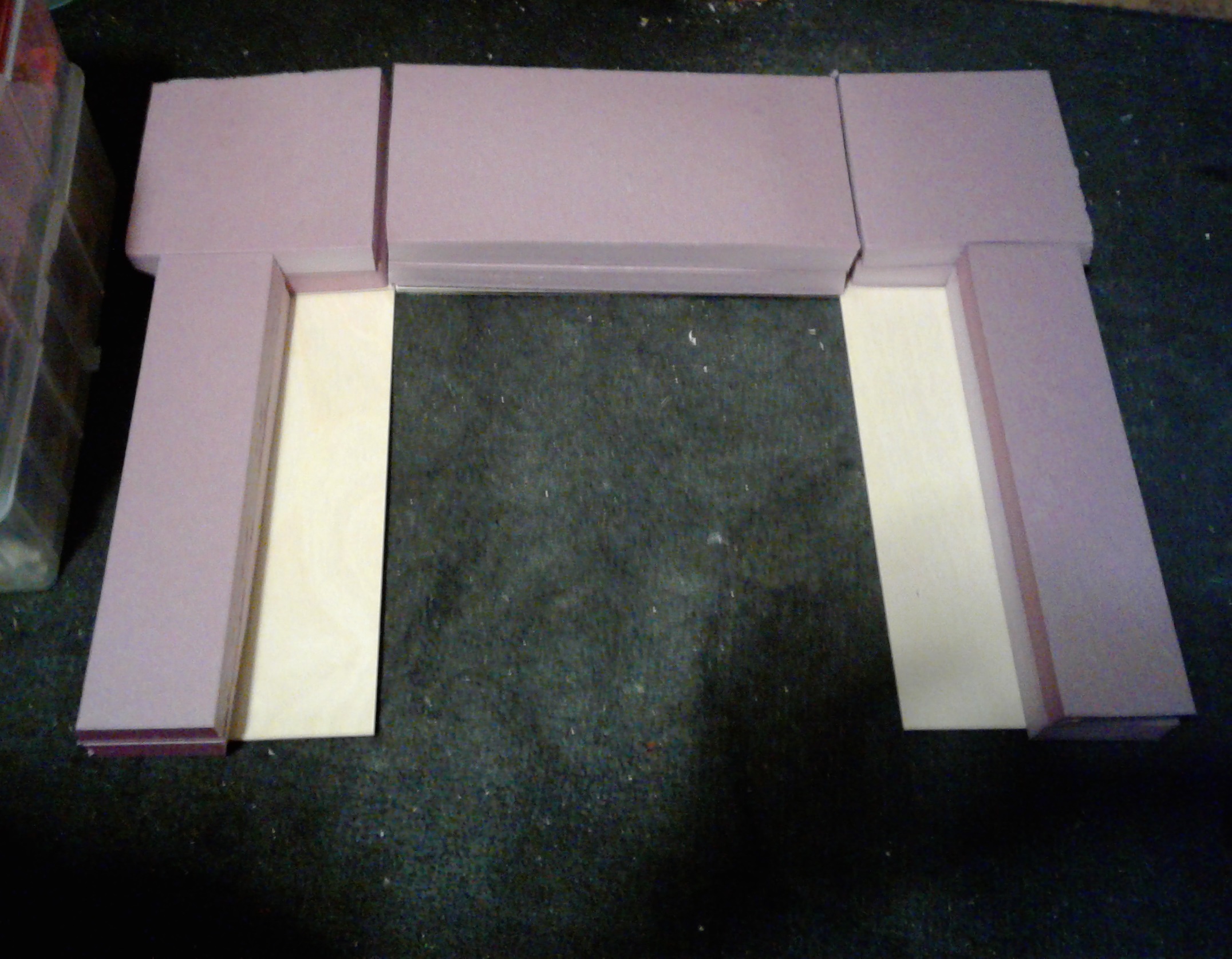

so today i shaped my foam for the wall and gate section. just a simple slope on one side, with some trimming to avoid overhangs or large ledges. sadly this is the stage i forgot to take pics of. i’m going to have to do some extra work on the corner bits so i’ll show you methodology then. but the basics are i stacked the layers, lined up the sides as best i could, and scored an angle with a progressive-blade boxcutter knife. then i used the baseboard as a straight edge to score out a line across the length of the foam. the lower layer had a smaller area to cut off that the top, but that’ll leave me some useful offcuts for later. then with those guides i cut each layer with the knife into the slope needed. once the two layers were each done, i stacked them and trimmed them where needed, as well as sliced off any ragged bits (sadly my knife is starting to get a bit dull)
once i had the shape i wanted, i glued them together. if not for COVID-19 i would have gone out and found some proper contact cement, but being at home and the town in lockdown, i had to settle for elmer’s white glue. it won’t stick quite as solidly but i’ve rarely had issues with it before, it just takes hours to dry.
you can see the results here, though largely blocked by the stuff i’m using to weigh them down (to ensure there isn’t any notable gaps)

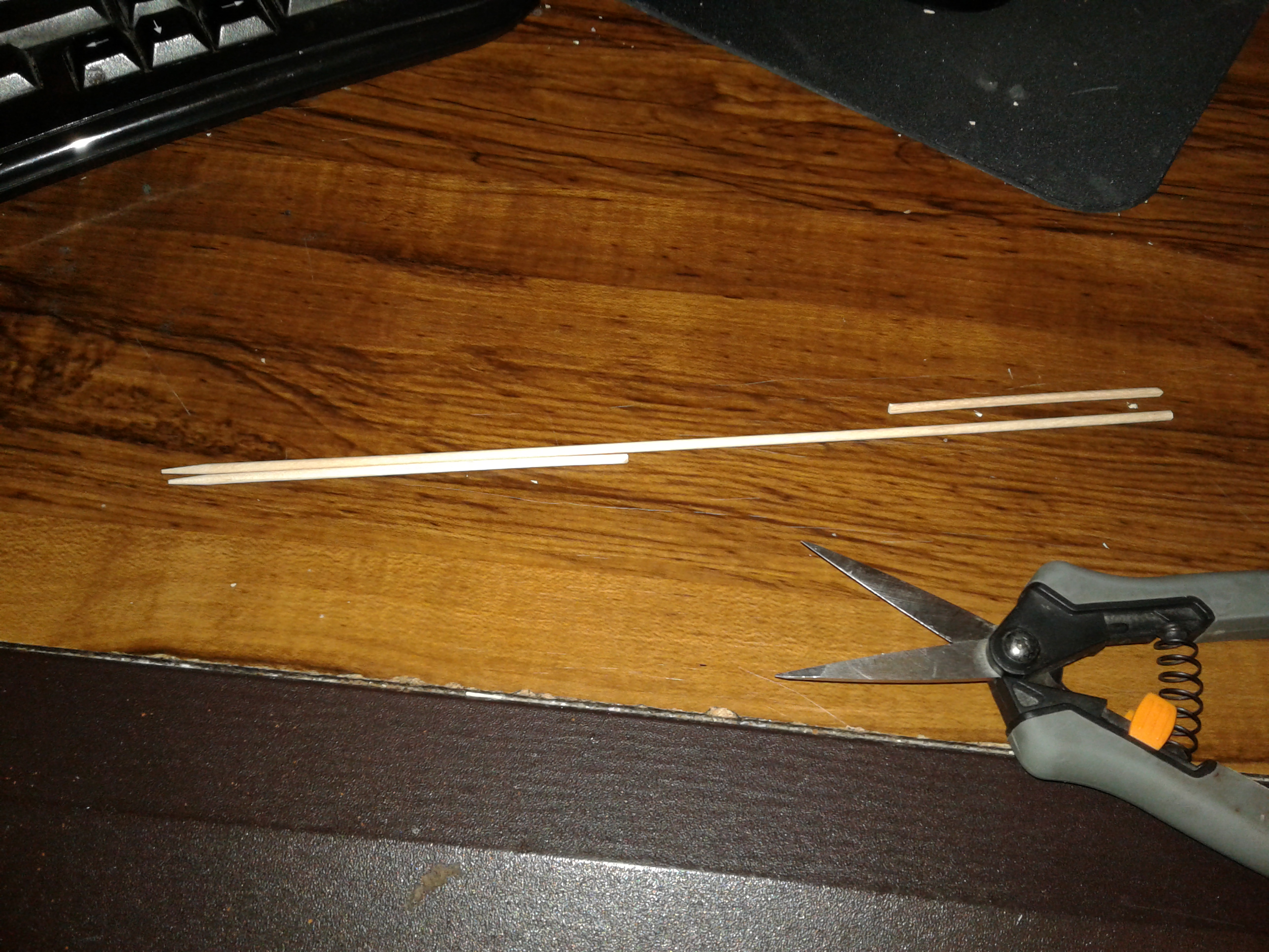

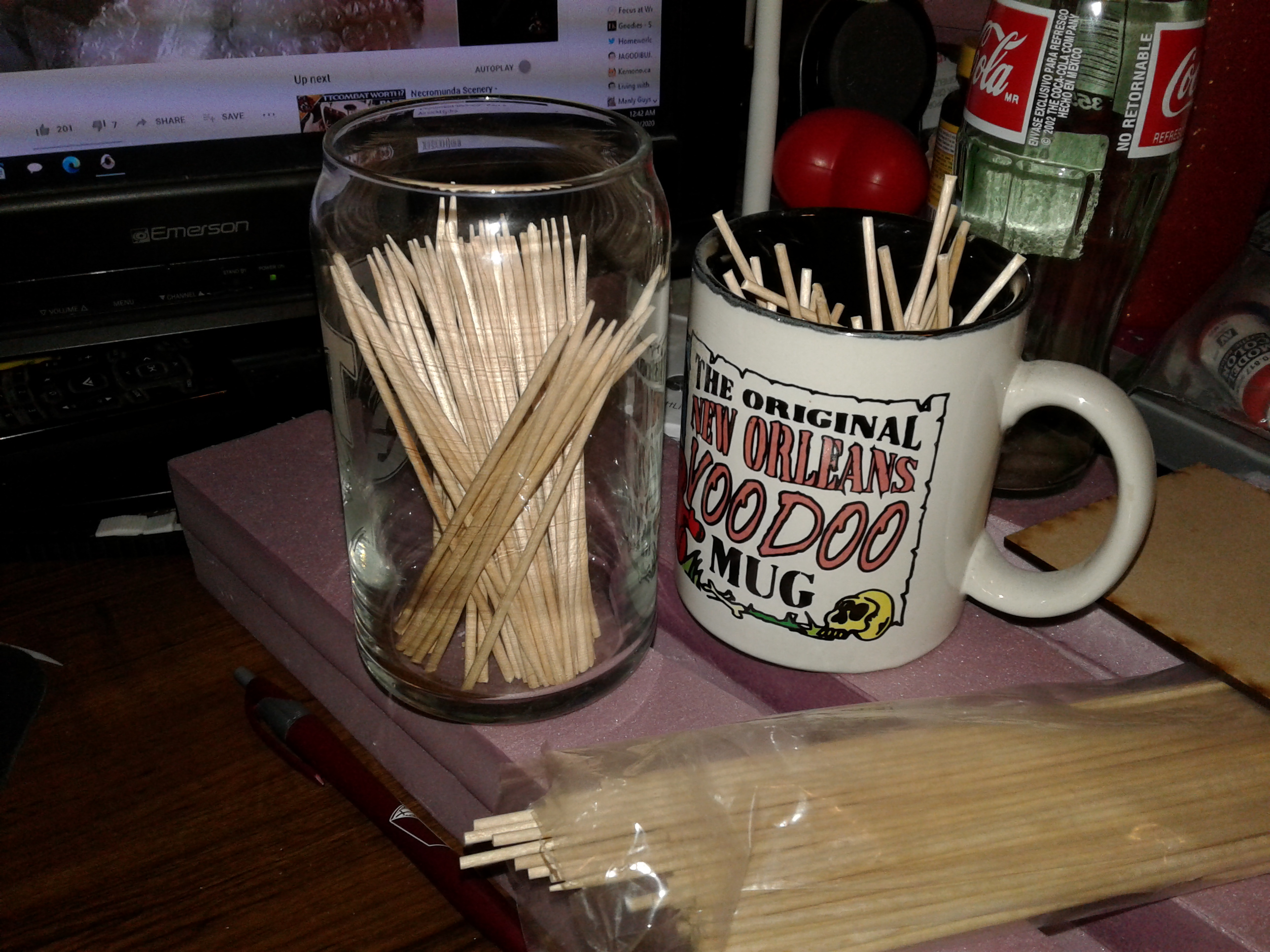

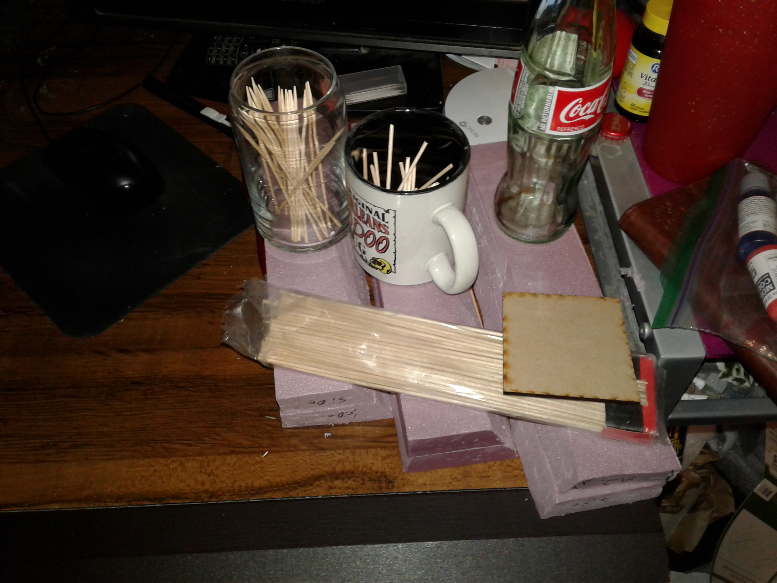

while waiting on the wall layers to dry, i started trimming my ā€˜logs’… these are just wood skewers, about 10 inches log. i measured out 4 inches for the tip, and cut the remainder in half… so i could give the palisade wall some crenelations for a bit of realism. (as these gaps in the top of the wall allowed troops inside to fight with bows, spears ,and so on while letting them duck back behind cover.)
i saved a couple to use as guides, and started cutting skewers, as i am going to need a lot of these.
now, i said i’d changed my design… basically, i’ve decided to go with a simplier and easier to build design. the wall sections have a flat side and a sloped side. before i’d hoped to build some buildings on the flat side and put the wall atop the sloped side… but that seems less and less likely, so instead i’m flipping it around… the flat side will face out now, and be behind the palisade wall, like they planted the logs for the wall, and then piled dirt up behind it to create an embankment. which is how some forts were built in the iron age and early middle ages, especially if they had to be built quickly.
