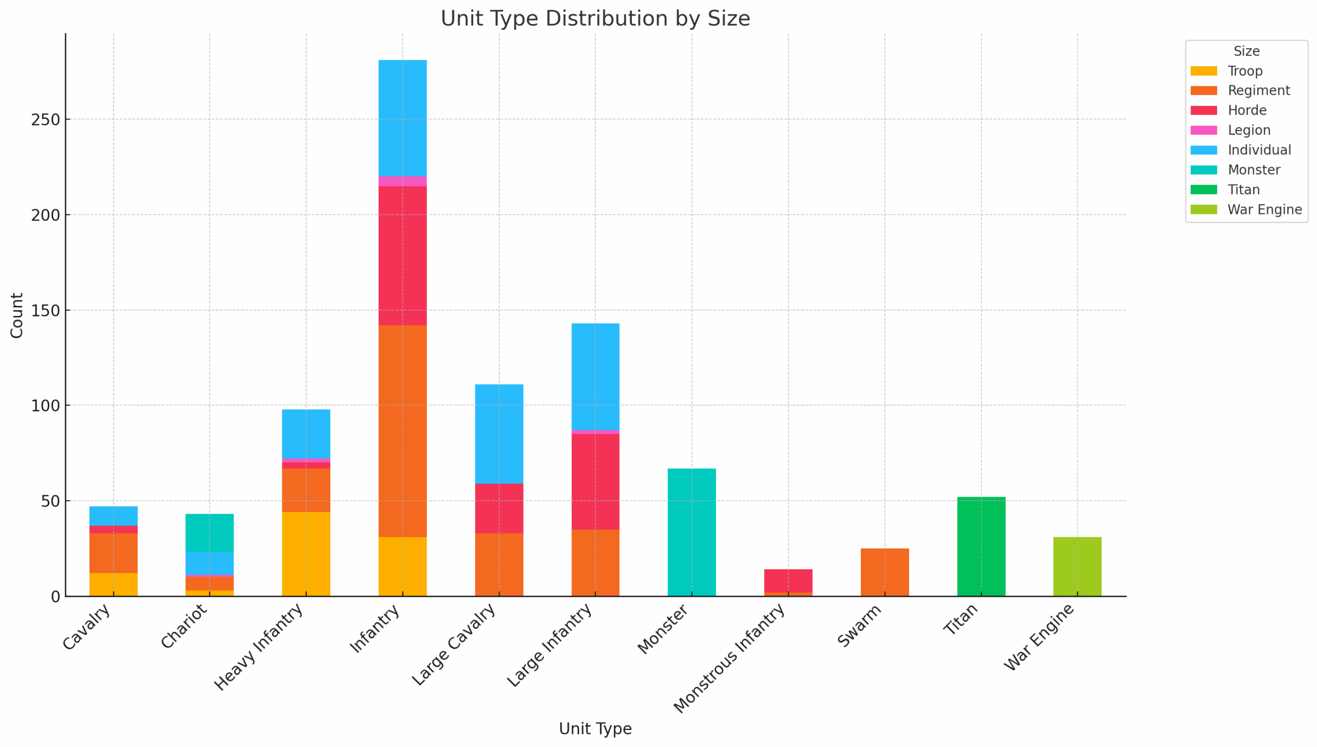

Alright, one more US Masters data dump, this time looking at units:

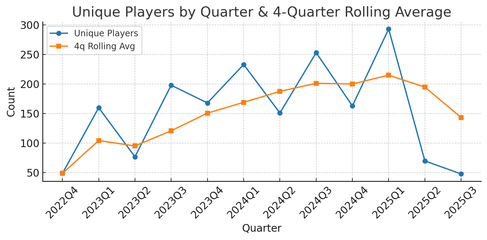

I’ll try to remember to update this post at the end of the year. But so far, the community continues to look pretty robust, the same thing I saw in the UK kowmasters data. The handful of anecdotes people share about the community dying off in advance of 4th edition don’t seem to be borne out at this point.
