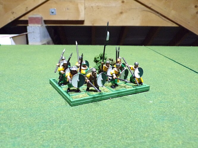

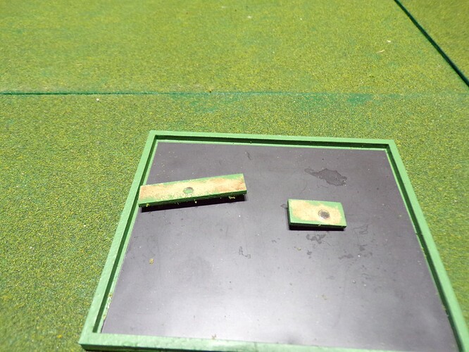

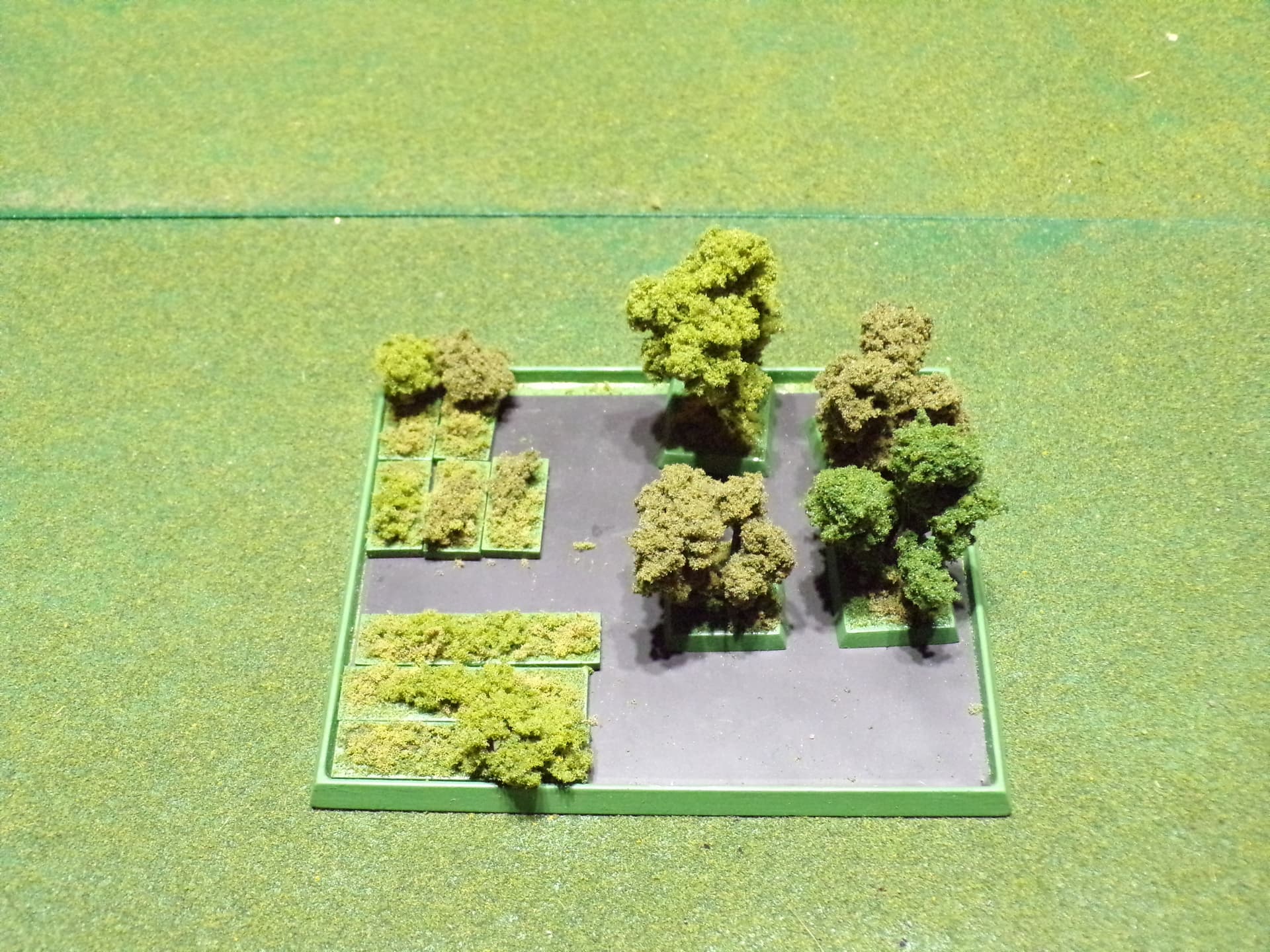

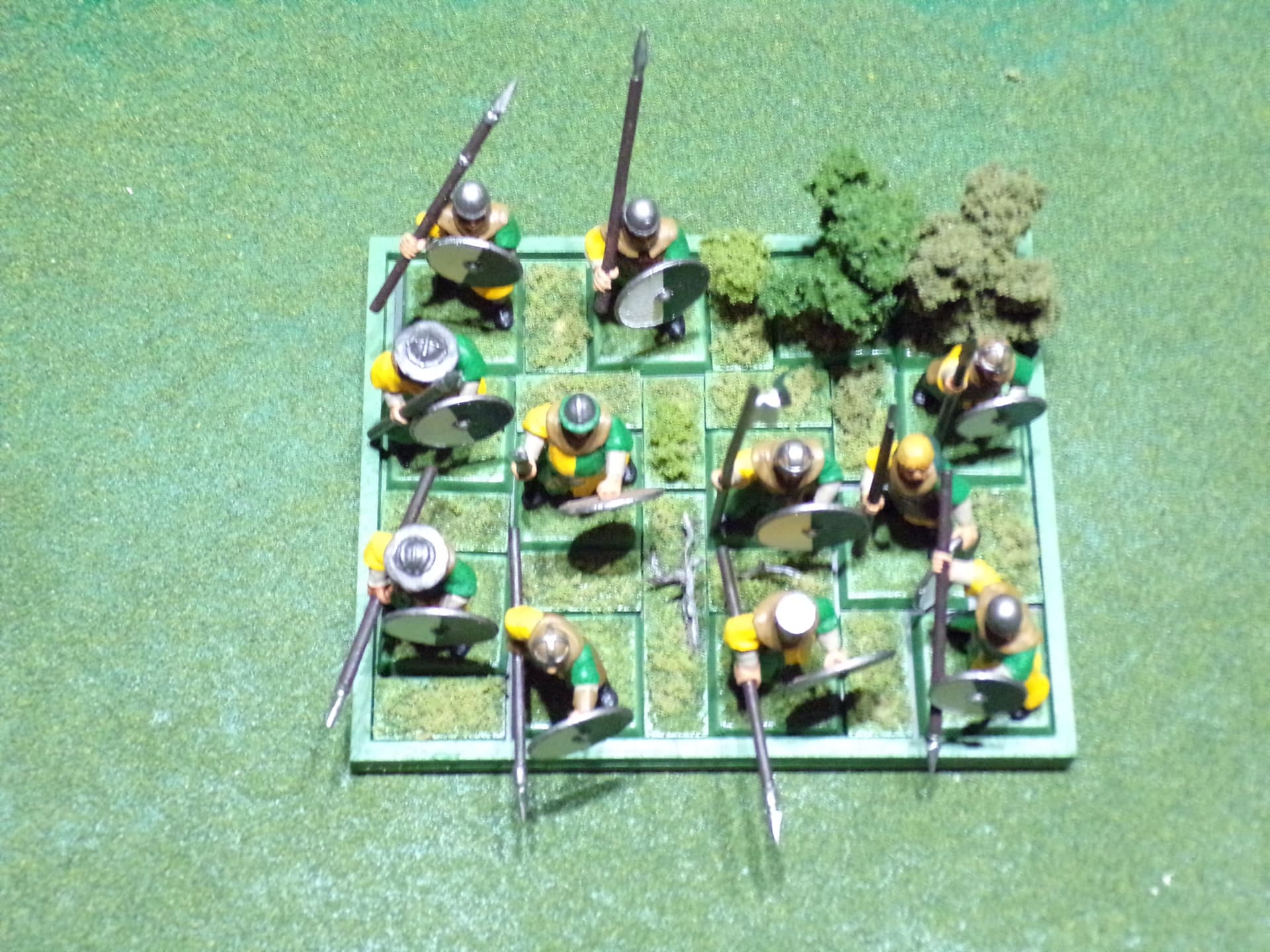

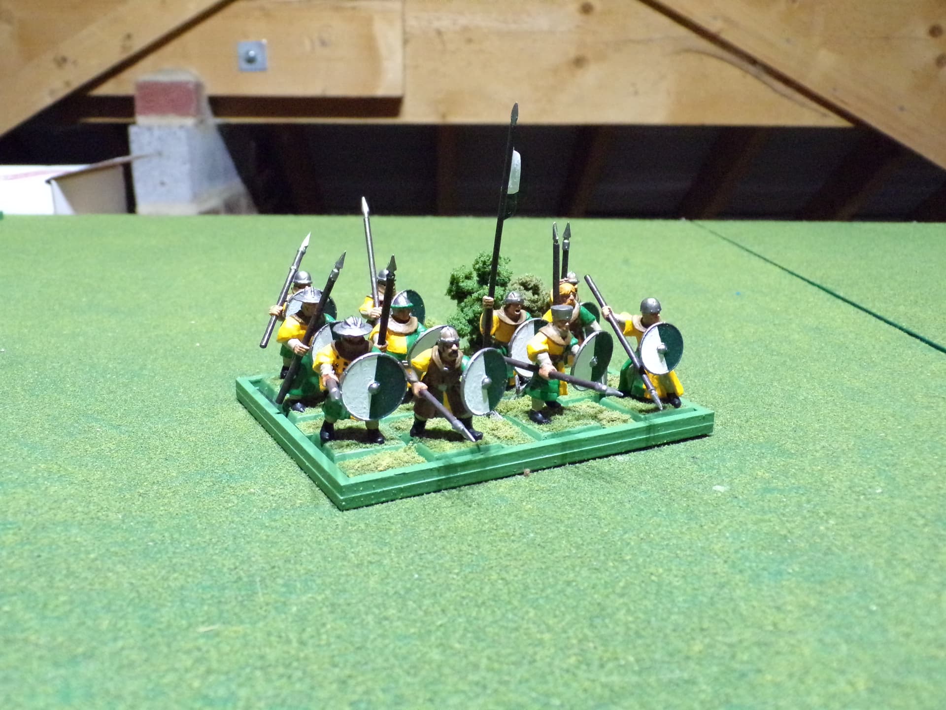

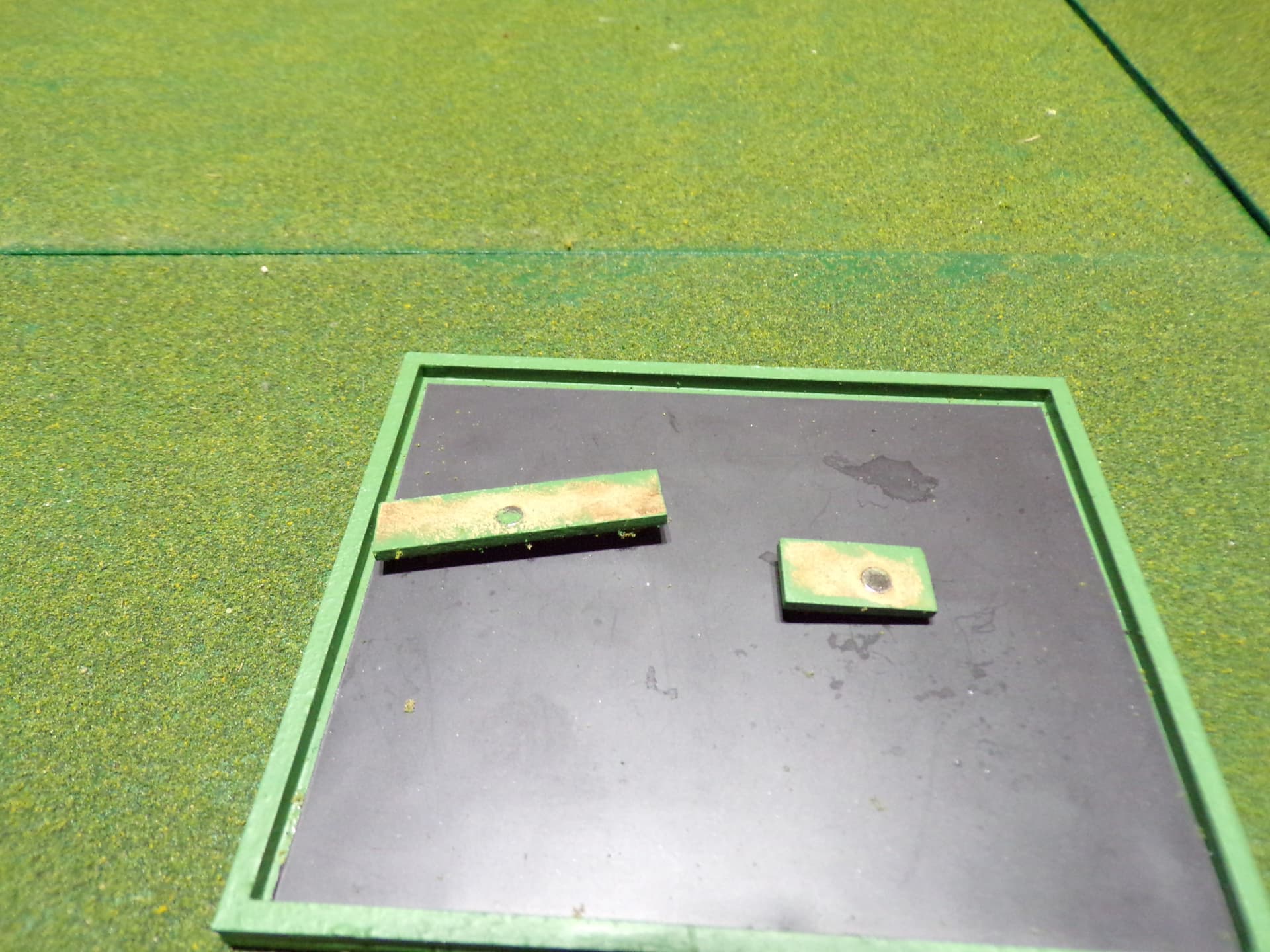

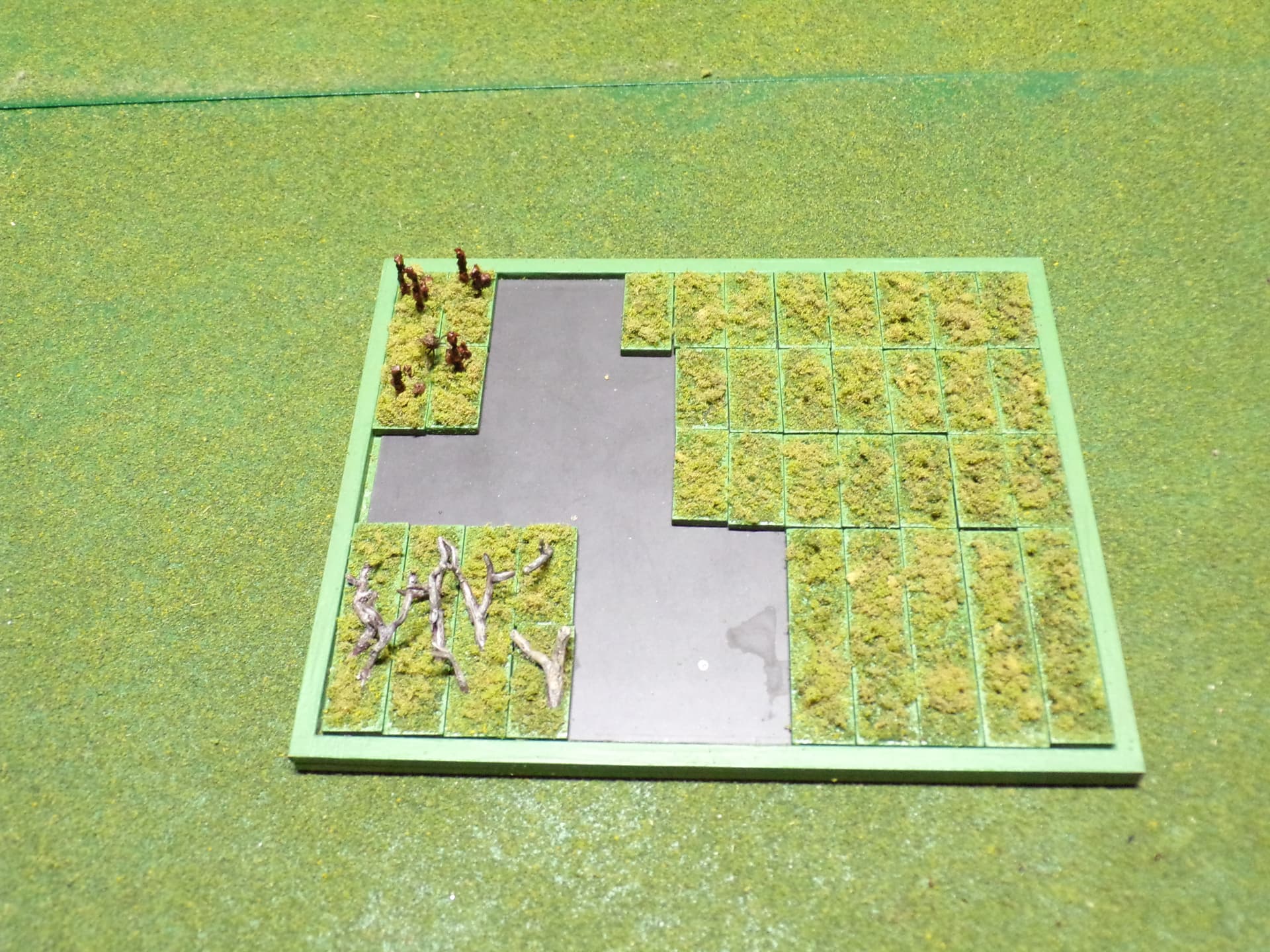

Hi @Mitch_novem, the photos below are an example of individual models placed on a movement tray with scenic spacers in between to make them fit. Please excuse the quality of the photos (my lighting rig is dismantled at the moment) but I think they are good enough to give you the idea.
The figures are on magnetised 20 x 20 mm bases, and the spacers are magnetised laser cut hardboard in standard 20 x 20 mm, 20 x 10 mm or 40 x 10 mm sizes. You can buy sheets of laser cut hardboard on eBay.
