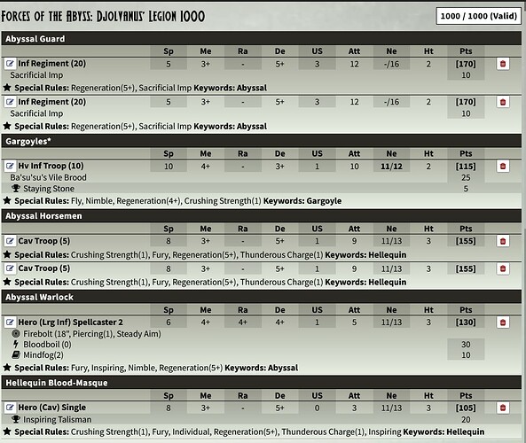

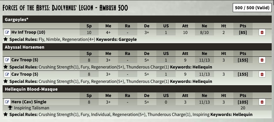

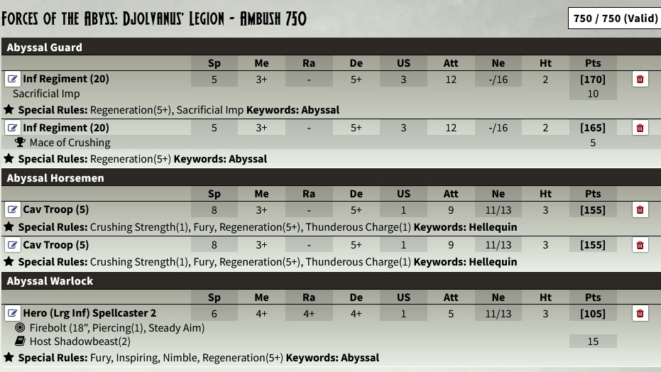

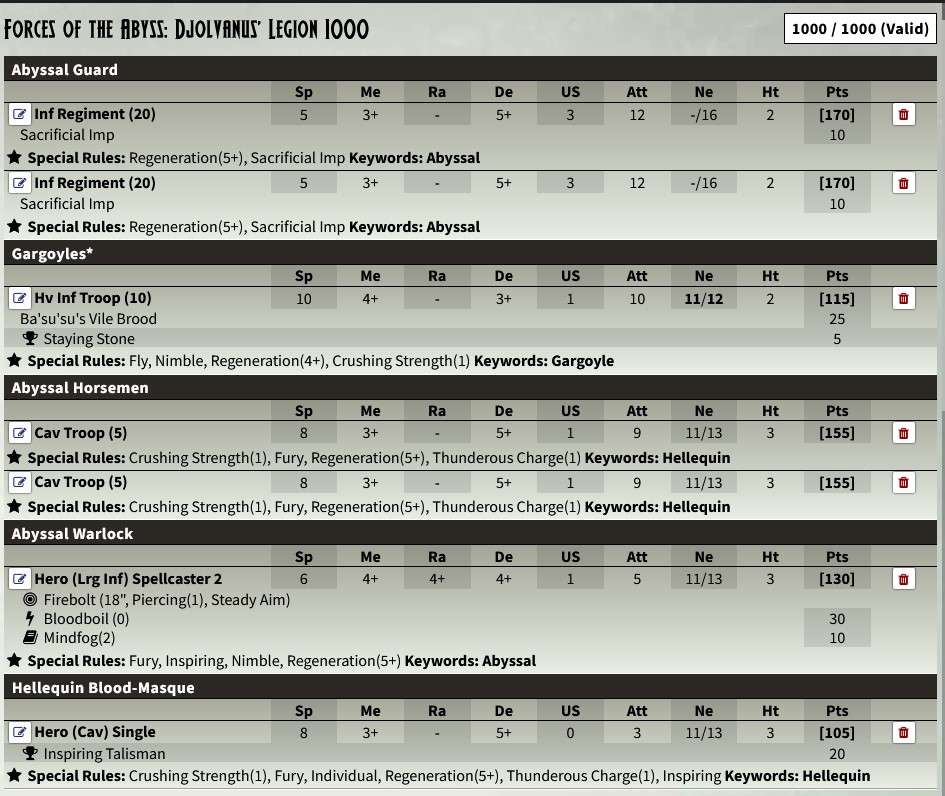

So these are my following lists at the moment with which I have models to play with:
500:
750:
1000:
So, are these good setups? Should I make some modifications/changes/add/remove things? I have the following tray sizes in case other units can be added/removed:

I think the lists you have will work just fine for learning the game a bit better. I might suggest that you consider a few things though:
  1. Combining the Abyssal Horsemen into one regiment. Troops are nice… but these are pretty expensive units, and you are paying “extra” for troops. If you run them as a regiment, you’d save 70 points, which if you drop the items from the Guards, is enough to get you some Gargoyles into your 750 list, for example.
  2. Running some Flamebearers. I have enjoyed regiments of them myself. They have Steady Aim, and a unit or two can roast enemy infantry. They might help you against those pesky Basilean Spearmen!
  3. Run something besides the Blood Masque as your source of inspiring, if you can free up the points. The Champion is slower but a better fighter, and can get Lightning Bolt if you have some more points free; and the Seductress gives a lot of utility.

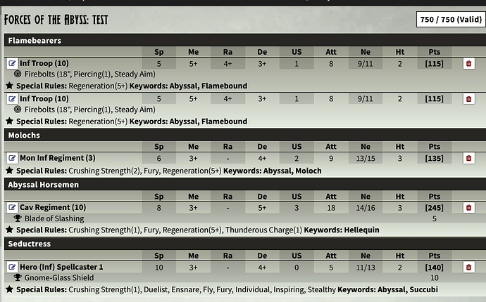

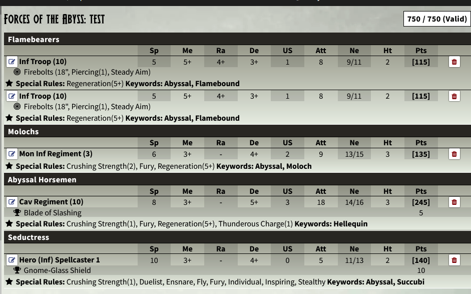

@750 points, why not try out an army like this:
It’s a good counter to those pesky spearmen and fliers and generally a good army to try out.
Use the flamebearer troops to advance in front of your army and blast your opponent. (preferably elohi and spearmen in that order) while you keep your calvalry and seductress out of charge range from the fliers. Cavalry can hide 5-10" behind your army, while the seductress can hide just behind the flamebearers so that there’s no room to charge her.
When a flier comes in charge range of the sedcutress, charge her out. The combination of ensnare and defense 6+ will keep her alive a turn longer than you’d expect. Move your cavalry into charge range for next turn, preferably hidden behind flamebearers. If you do a wound, the flier is grounded and can only run away or await the charge of your cavalry next turn. Also, bear in mind that a disordered flier loses nimble, so running away is only limited to one 90" turn or a half-move “back” order.
Use the flamebearers to blast other units and don’t be afraid to use one or two to charge or block charge lanes. At this point of the battle, it’s your molochs and cavalry that will do the killing. The flamebearers will serve only to get in the way of your enemy units and finish off wounded enemies.
