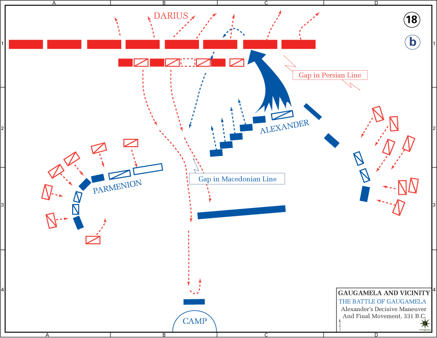

In most RnF games and especially historical ones, you just can’t charge into a units flank if another unit has a “zone of control” extending to protect this flank. Historically echeloning a line back was a valid tactic to protect flanks (each unit being staggered back from it’s neighbour in stepped fashion ). Units weren’t going to charge into a flank suicidally exposing their own flank. See Alexander the Great’s pike units to left of his cavalry in centre of his line here, and drill books mention this flank protection technique right up to and beyond Napoloeonic times (19th century). The exception is that skirmishers don’t usually have enough weight to them to protect a flank like this.
