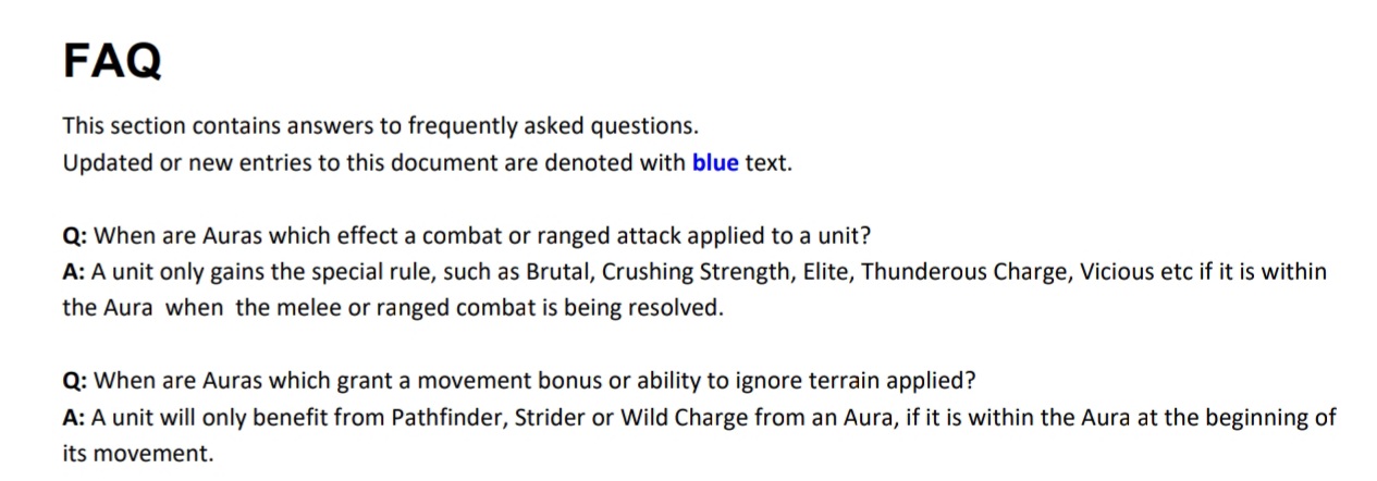

The faq referenced above is as follows
Fury/Headstrong take effect when the effected unit is given an Order (so for the purposes of the faq fall into the movement question).
Your second point isn’t explicitly answered, but following what they say about Wild Charge (you can roll all of them and then decide what to do with each unit), you’d be able to roll headstrong tests for any units that need it before deciding orders.
