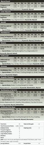

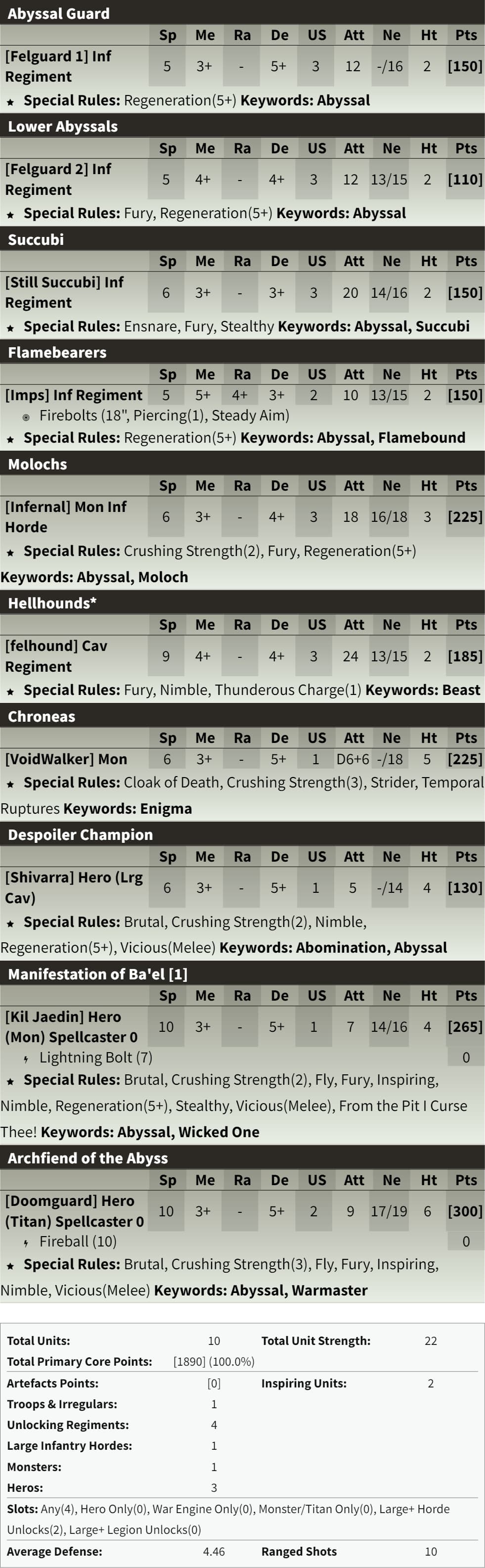

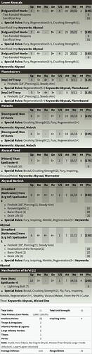

Here’s the list I was able to come up with. Any suggestions?
Essentially I have my master list which is basically: What warscroll (I don’t know what they’re called here, I come from AOS) is what unit in WoW, and also; my first draft actual list for play (is it well balanced? Do I have enough infantry/troops vs heroes and everything?)

The list looks ok. The most common new player mistake is not bringing enough inspiring.
I looks balanced enough and sensible. On paper at least.
Those three infantry hordes might take some practice to not get into each other’s (and other troops’) way.
KoW is decently balanced, so as long as your list is sensible (I think it is) you’ll be fine.
By the time you are familiar enough with KoW for a more “optimized” list to make a difference you’ll also know your army well enough to tweak the list yourself.
There’s no deep strike/summoning rule equivalents in KoW (the nearest is a Redeploy rule which allows you to move units at the end of the deployment phase, but only certain units/formations get access to it).
Re the list itself - on the warlocks there is no point in taking Knowledgeable (it’s only useful if you want to take more powerful spells from the Library of Arcane Knowledge) or Incantation of the Tempest (as it is really utter cr*p - since it is a 50/50 roll you really shouldn’t have to pay points for it).
Take Conjurer’s Staff (a guaranteed single reroll) and Amulet of the Fireheart (one use, cast 2 spells in a turn) for the same points
