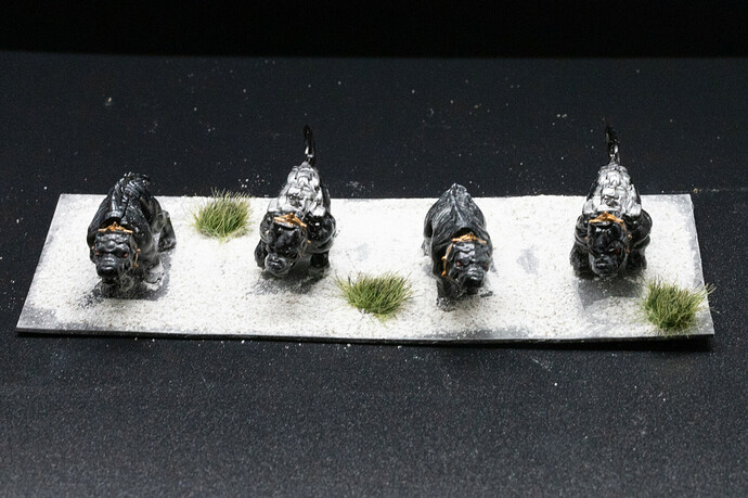

- Mutated Mastiff Hunting Pack* (Regiment) 65

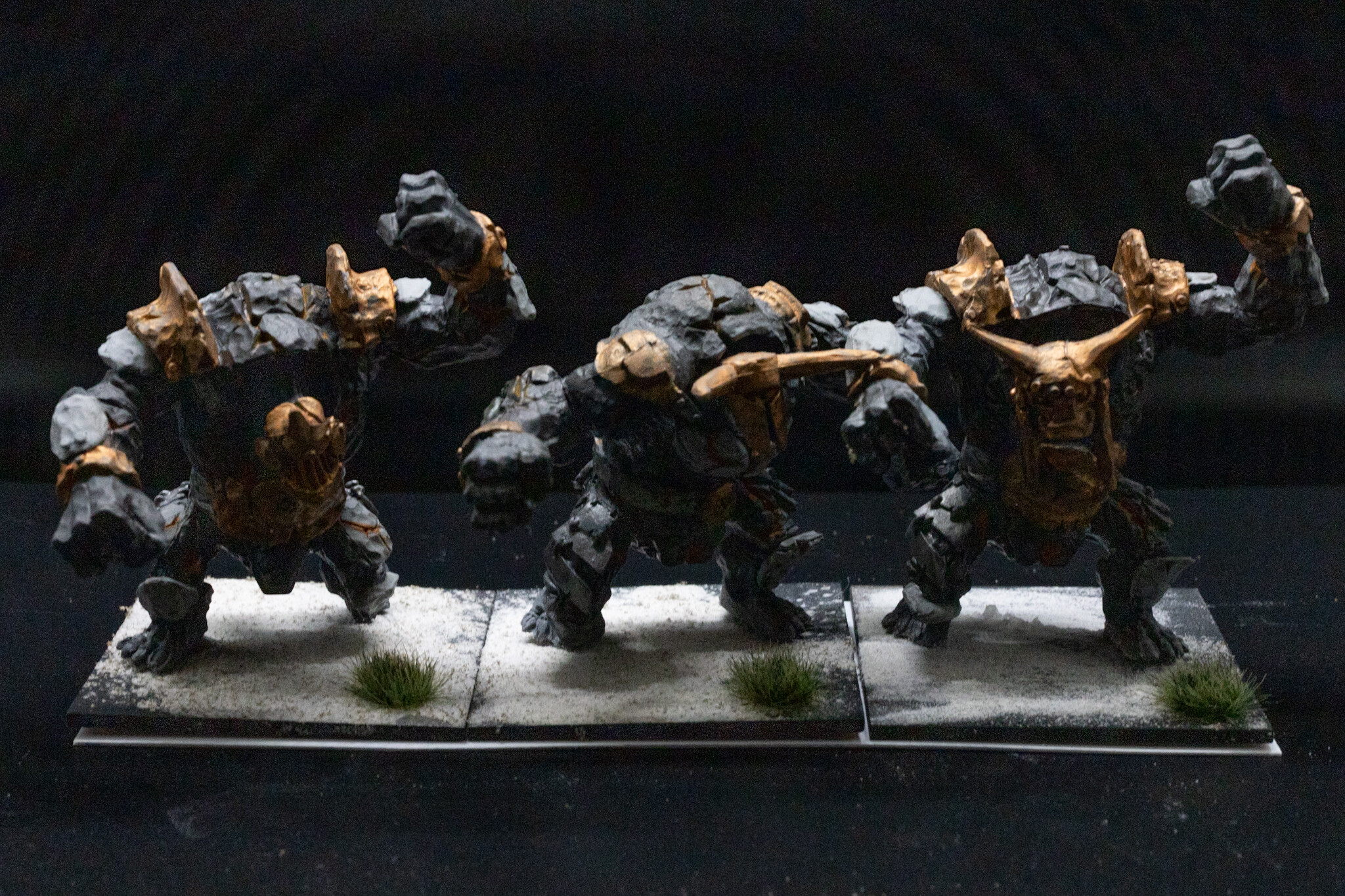

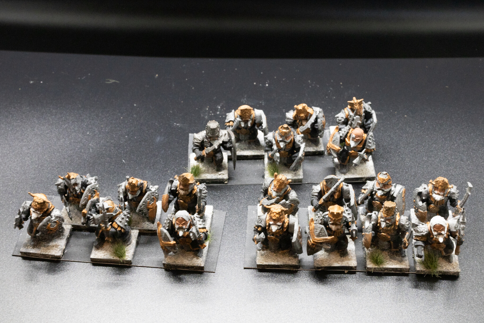

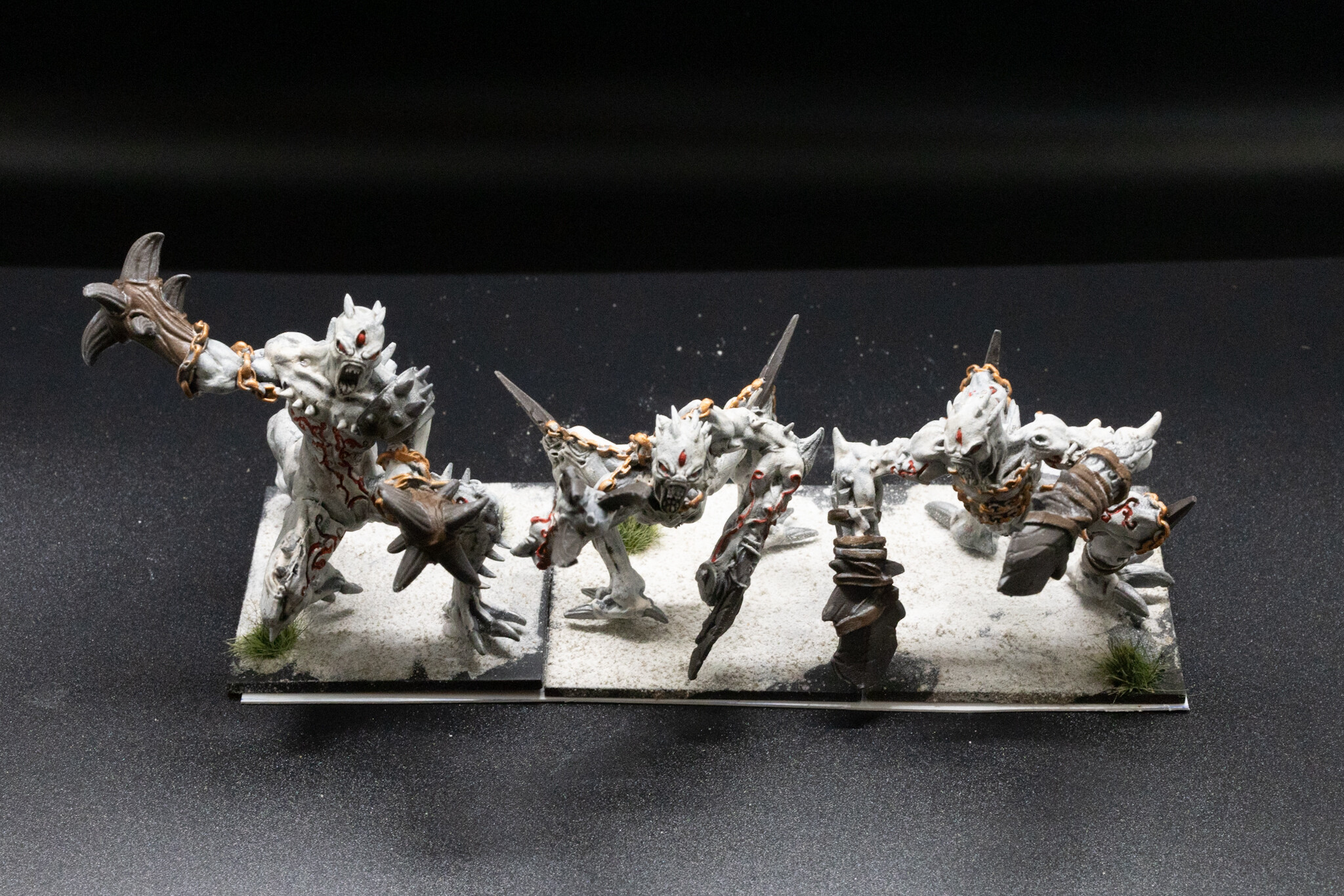

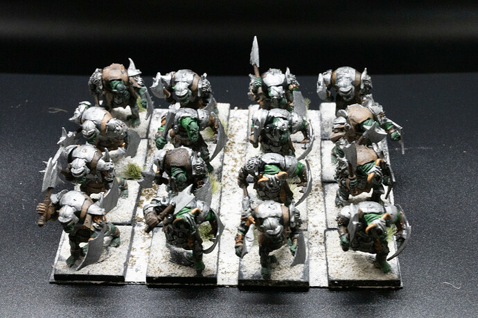

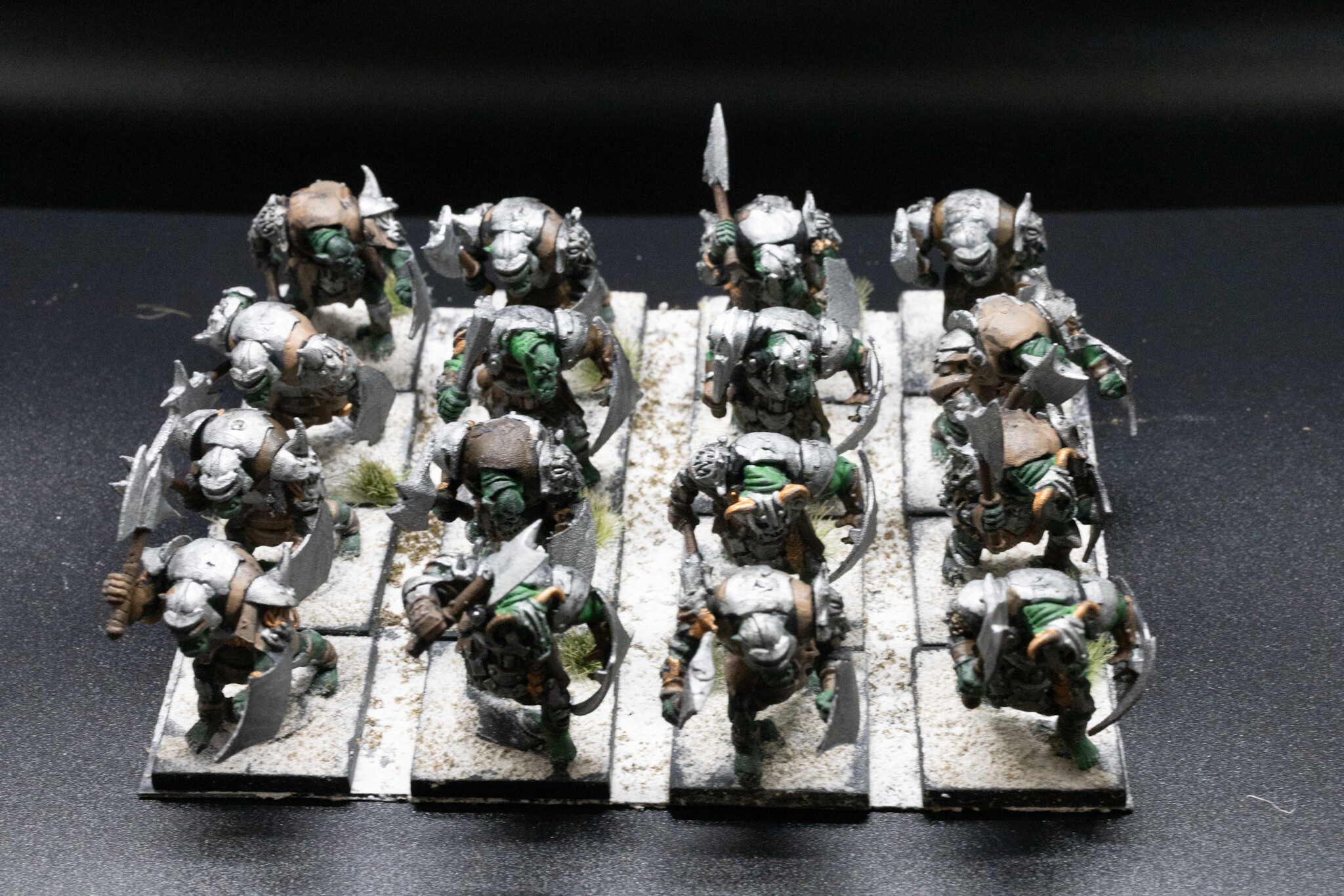

Slave Orc regiment painted

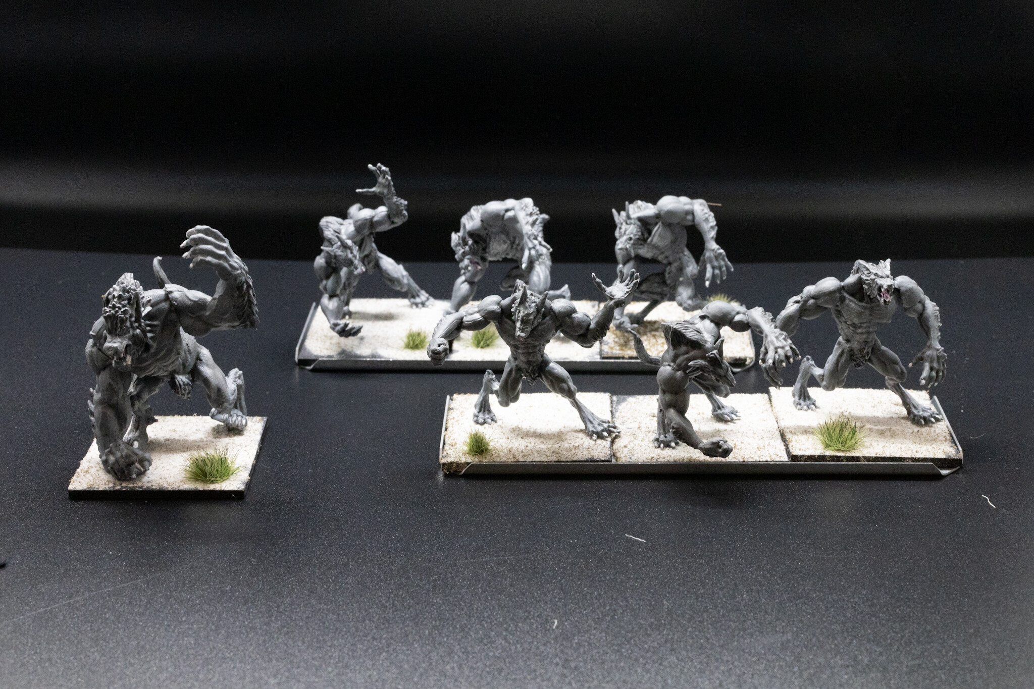

Werewolf horde painted

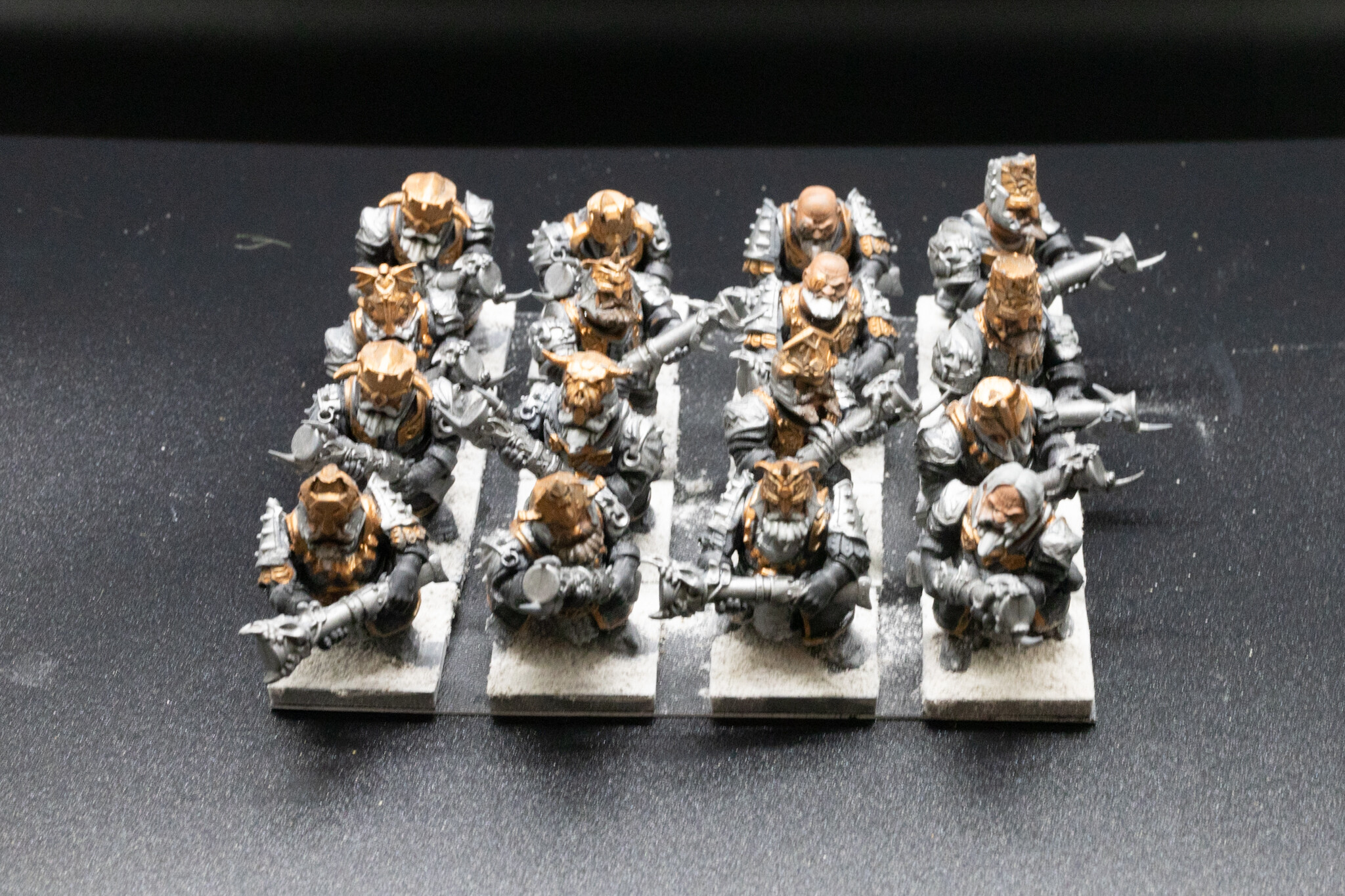

Painting the first regiment of Abyssal Dwarfs now . . .
Not the best looking group, but I’m trying to go as fast as I can to see if I can hook the boys before they lose interest.

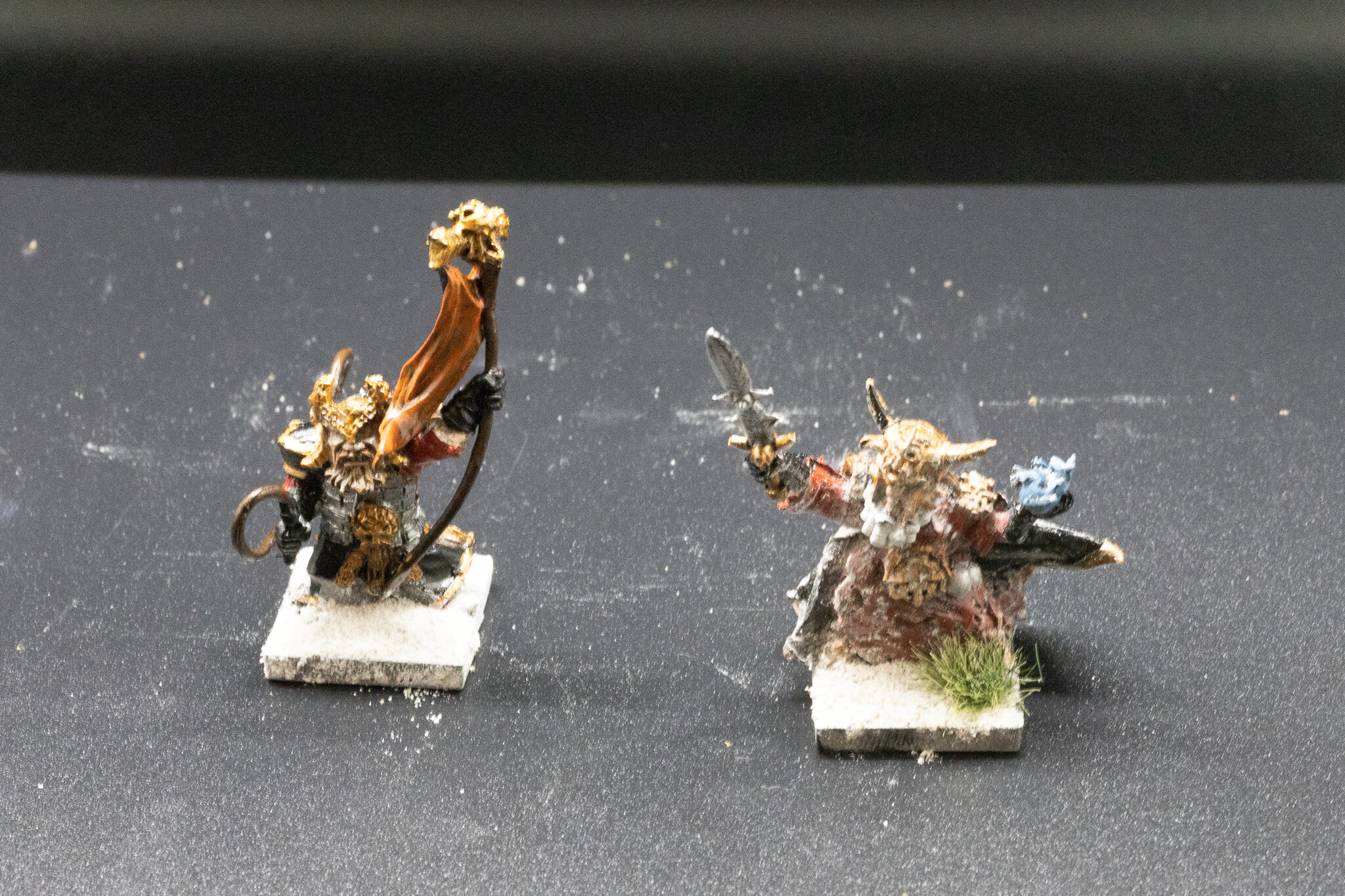

One more update: the abyssal dwarfs are almost complete. In the next week I should finish the grotesques, obsidian golems, and two characters, and then they’re done.

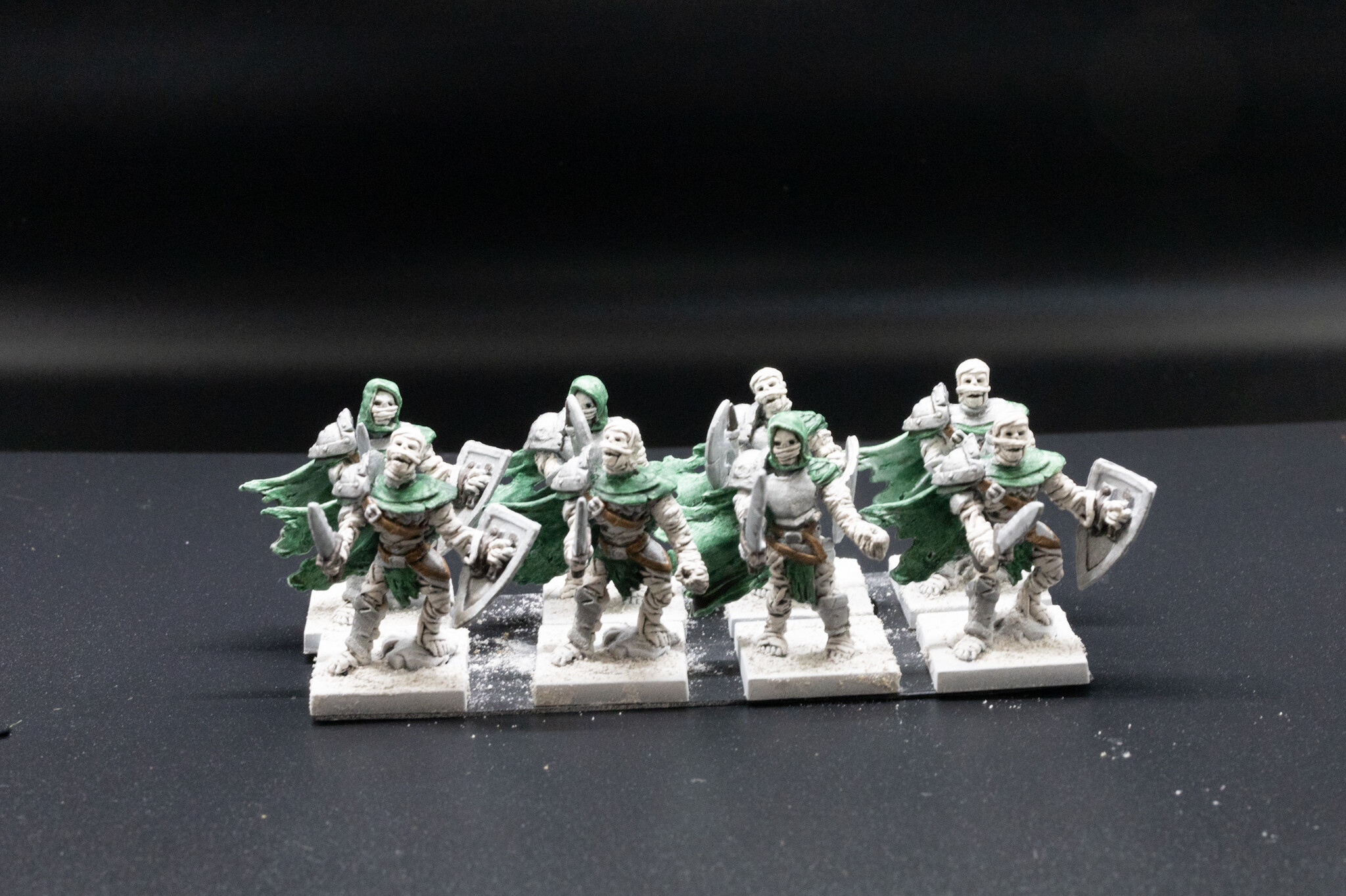

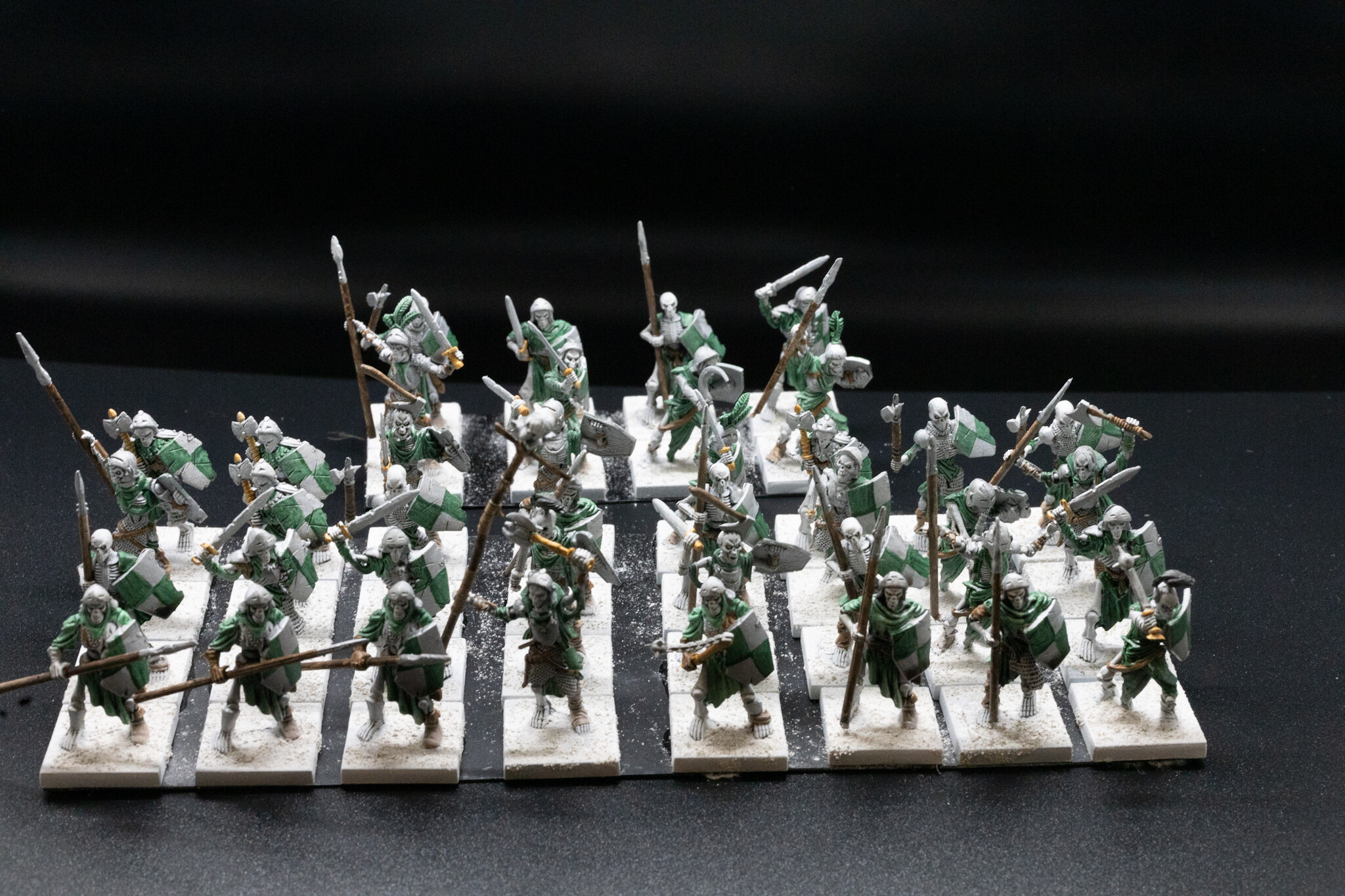

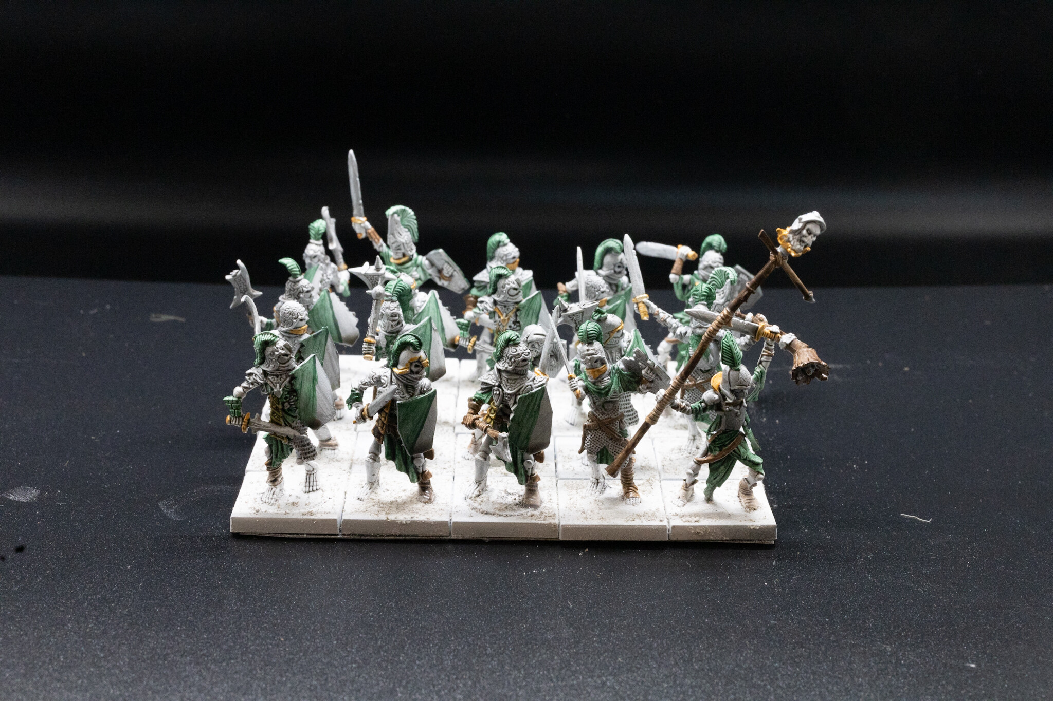

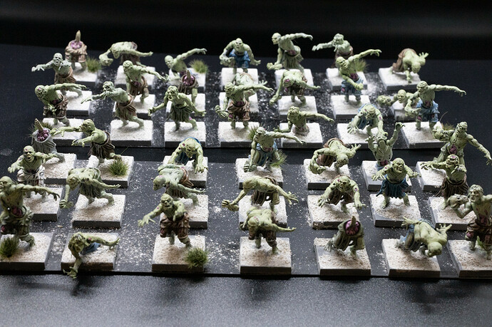

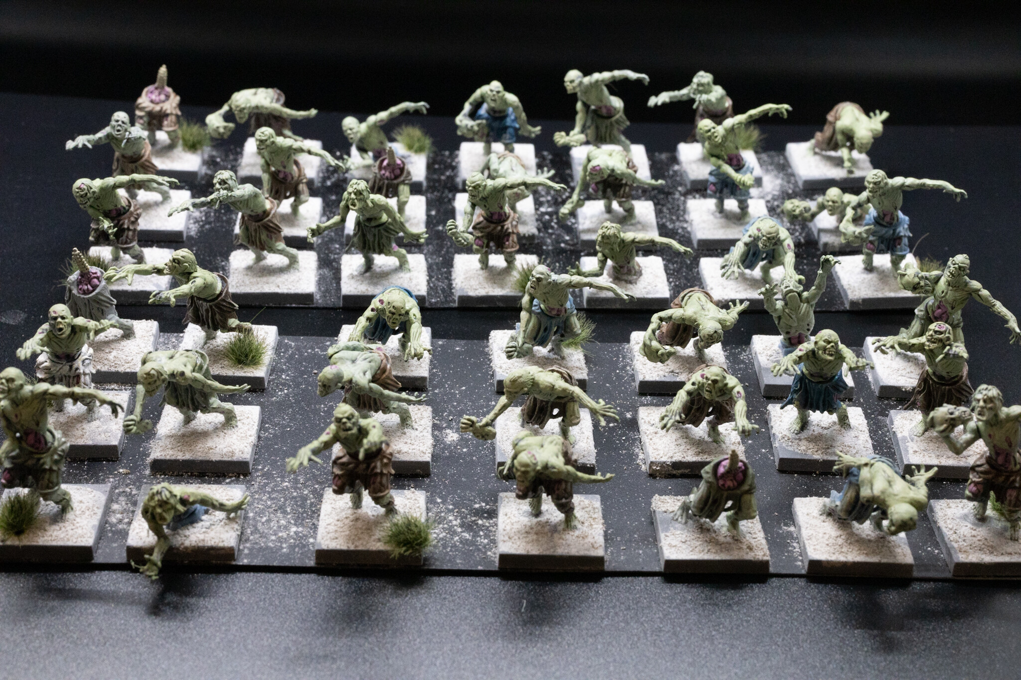

For the undead mega army, I need to finish up the revenants and skeletons. My 8yo wanted the zombies based as two (MMC) hordes. I followed the advice upthread and cut some plasticard, painted black, covered with grout to give some minimal basing. My expectation is we’ll be rebasing these as we go forward, so I’m focused on getting as many models painted and units ready as quickly as I can. They’re both getting into the lore and comparing the strengths and weaknesses of the various factions.
He has a birthday coming up in November where we can round things out, but I’m hoping by sometime in November to have two fully painted, 1,500-pt armies ready to battle at home. If they enjoy it as much as I hope they will, we’ll continue to invest and build out for the future. With kids, there’s no telling how long their interest will last, but I really think this one will stick and be a lifelong hobby. We’ll see.
As of today, their armies are painted, based, and ready to go. First time painting anything like this, so lots of lessons learned. I plan to rebase as we’re go forward, but at least we have something to play with now. First 2-player game at 1,500 points coming this weekend!

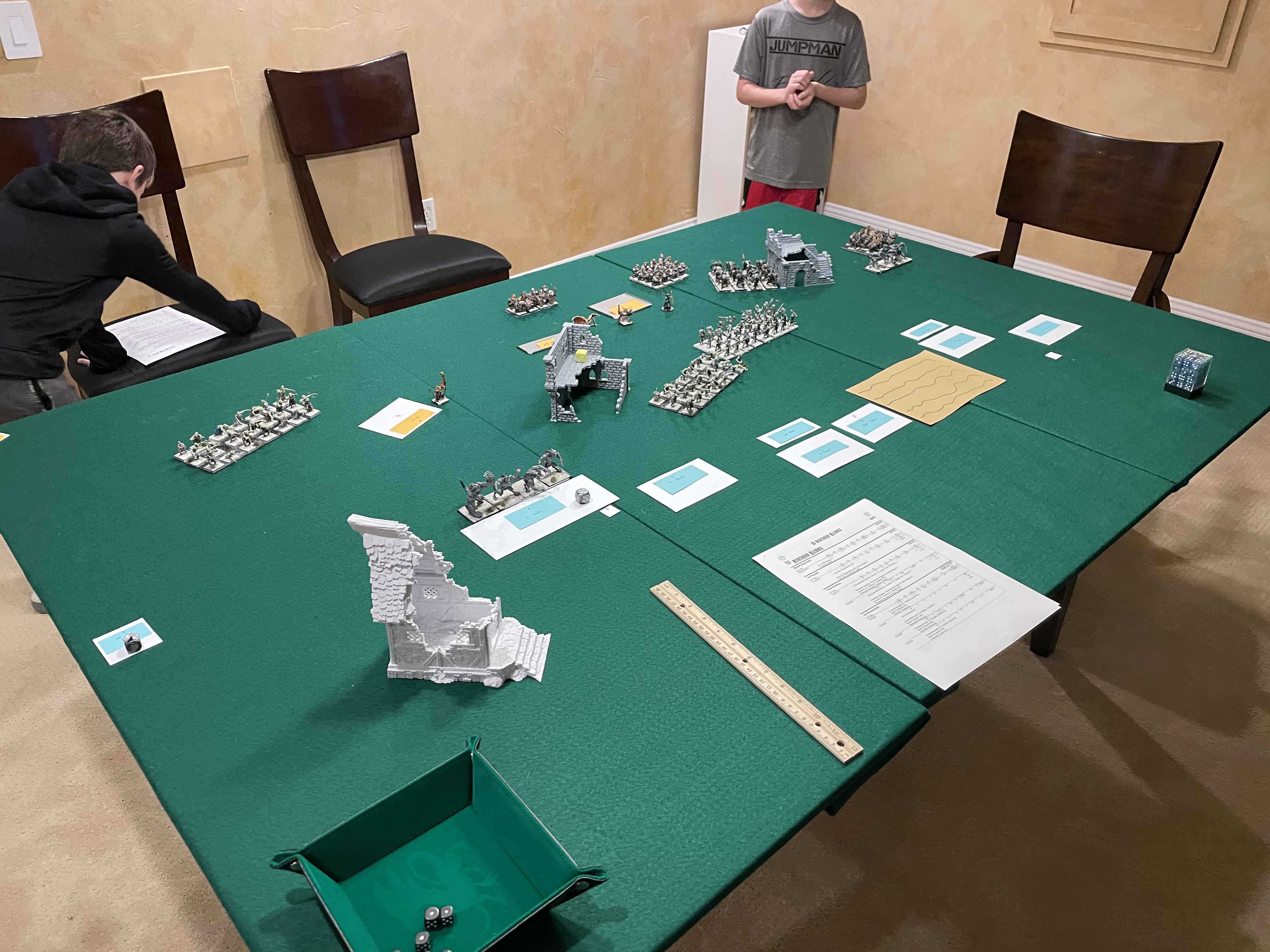

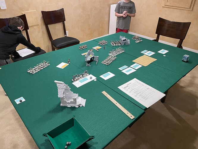

For this weekend’s variation, we did control with 2,000 points of Northern Alliance vs 1250 Undead and 1250 Abyssal Dwarfs. It wasn’t much of a match up, with the ujdead/Abyssal Dwarfs winning quite handily. We fought it out on the new 4x6 felt tabletop I put together based on the forum’s advice. We had a great time of it!
