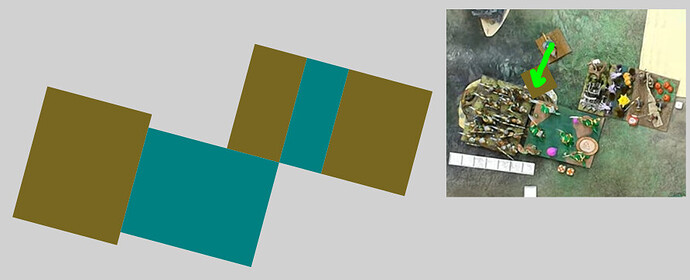

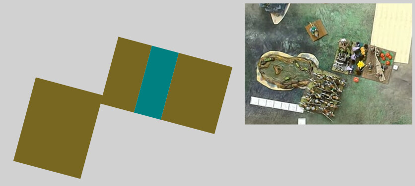

… but in the meantime, I took a closer look at a couple combats in this one:[spoiler]

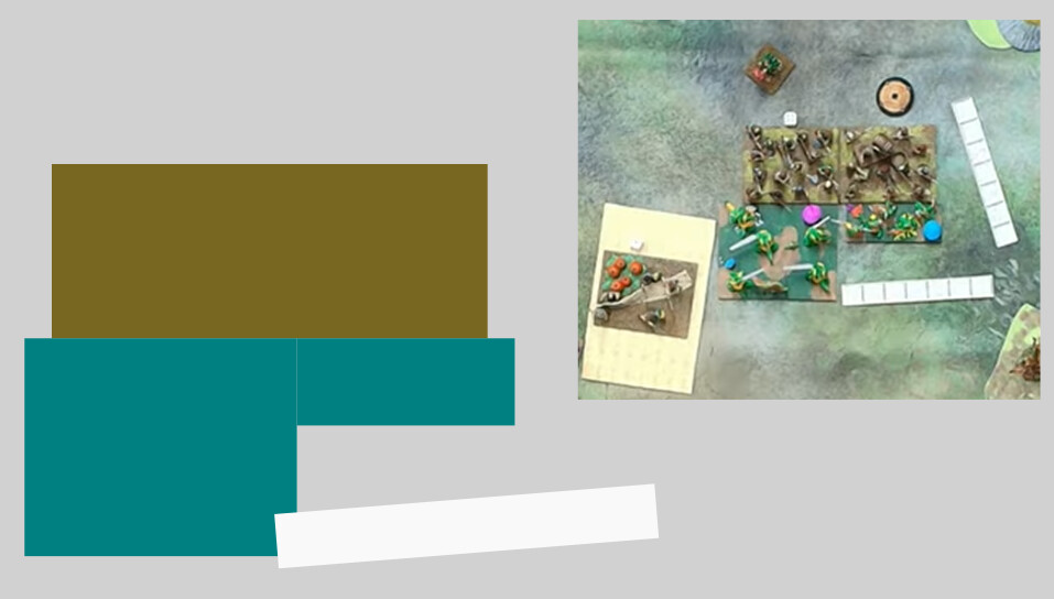

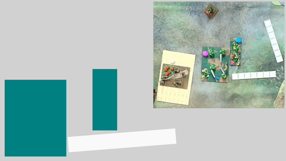

Placoderms and Riverguard charge some Rifles, except it looks like the fishmen should very likely have hindered themselves when they slid down into place (there shouldn’t be a gap between the two TR units and the larger Placo frontage should cross the Rifle centerpoint by 12.5mm). The dice were ultra hot in this combat however, to the point that the 2 damage the wall would have cost the Placos meant very little :person_shrugging: Both units turned a full 90 degrees to the left after combat, however the Riverguard sorta floated around and nuzzled up to the Placoderms. Rotating around the unit centers costs the frogs about 2” of movement towards the Halflings … which again, probably didn’t matter because of the speeds involved but still.

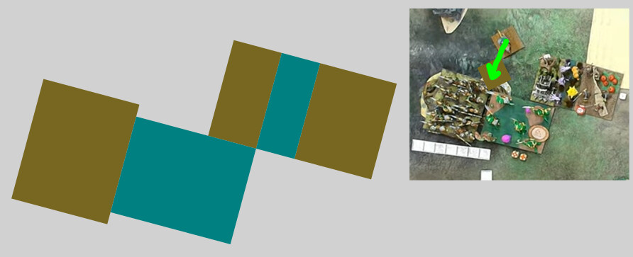

This pic is mostly to set up this wild combat with 5 engaged units, 2 flank charges and 1 rear charge :sweat_smile:
The triumphant Lancers overran 4”, passing in front of the Harvester (and into scoring position). Because they’re 125mm wide and the Placos are 100mm deep, we know that they’d overhang and have their overrun stopped by the Harvester in the same combat as them. If the Halflings wanted the Lancers to pass in front of the Harvester, they could have used the Sauceror to push the charge alignment of the Lancers down 13mm (seen in the pic above with the green arrow).
I bring these up because they’re both situations where the geometry of the game takes over from the vagary of measuring tapes or sticks, and combat reforms are obviously a big part of Kings when things get tight, which they are quite often on a 4x4! Hopefully the diagrams help, tho they are for sure easier to make then leaning over a table and finagling with units on bases on terrain.[/spoiler]
