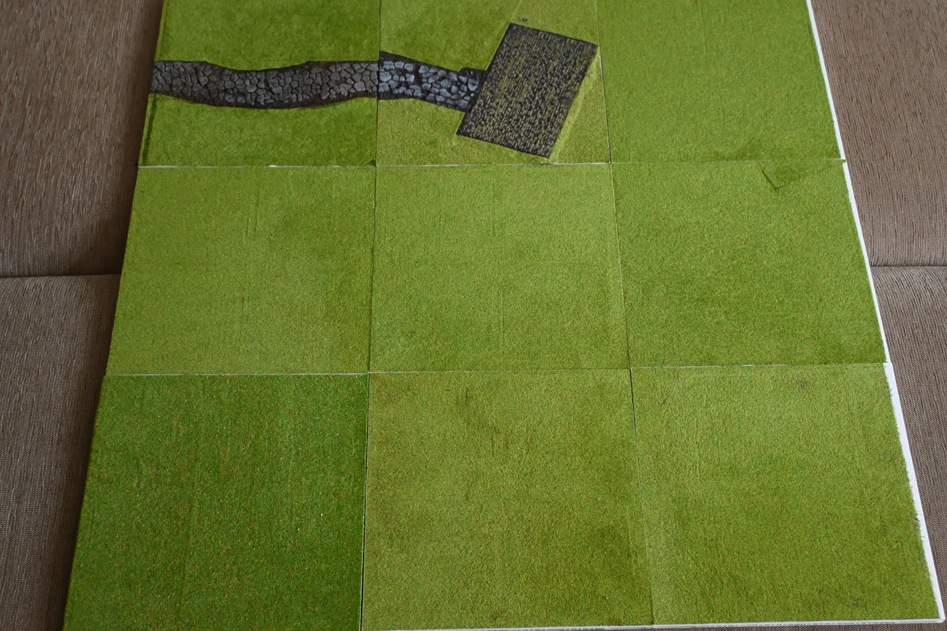

Already a few years ago, around the end of 2019, I started to work on a modular board for Vanguard. The idea was that the board would be composed from nine 12" squares which would be easy to transport (take in a bag to our local gaming store) and connect to form a 36" x 36" board. At that time I just started and then for many different reasons the project was sidelined. That’s my problem in general, I often get enthusiastic at the beginning of any project but find it difficult to finish it. ![]()
Anyway, as the time passed I was working on it time by time and finally it is getting into a shape when one can already play on it. The project got more impetus with the appearance of the Ambush KoW format which we started to play in our group recently and you know, the board size is exactly the same as for Vanguard.
I hope to find some time and willpower to finish it over the summer. For a starter, I put here the pictures I took already in 2019 when it all started and more will follow to show how it looks now.
The 12" squares are cut from 5mm thick white PVC sheets used mostly for advertisement boards which are quite light and sufficiently sturdy. At the top of the boards I clue a grass mat produced by NOCH:

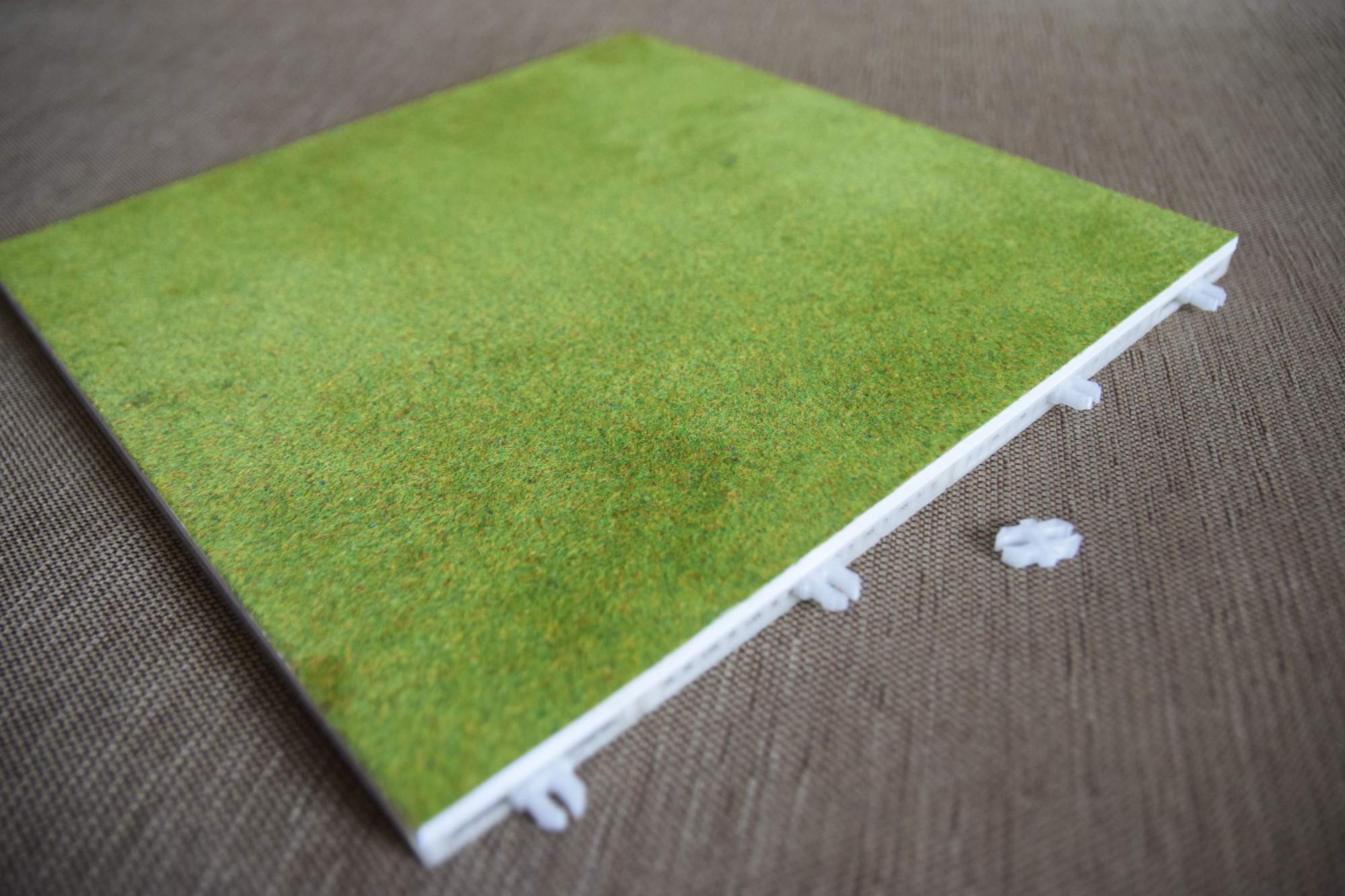

On the bottom of each basic board I glue 3d printed pieces from the free openlock template files:
This makes the boards more sturdy and allows them to connect easily among themselves thanks to the openlock connectors

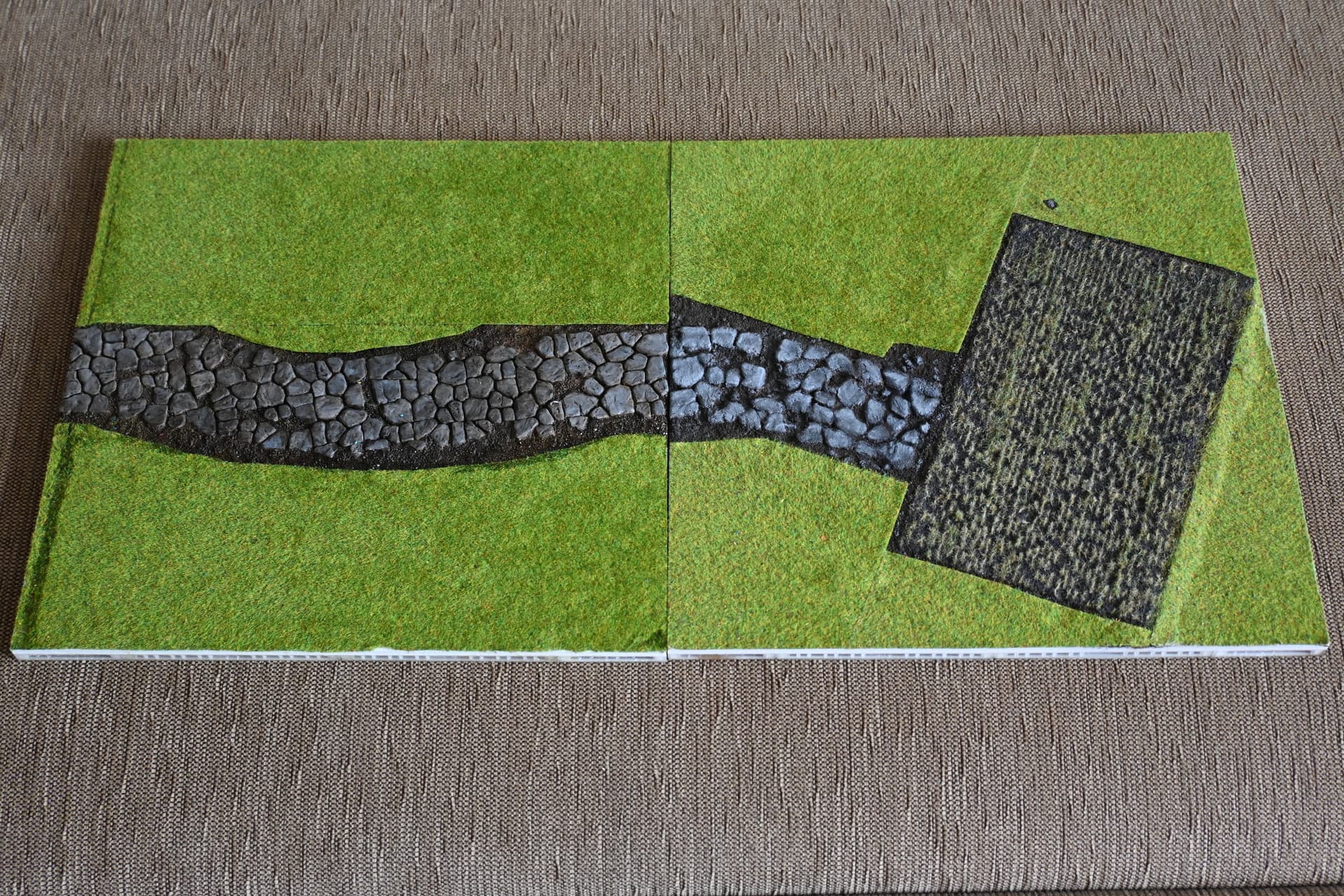

The final picture shows two already connected boards, one with the grass mat cover, the other with a part of a country road created from dental plaster stone pieces made using Hirstarts forms. I used the Large Cobblestone mold #211, sanded the road blocks to make them thinner and broke them to smaller parts:
