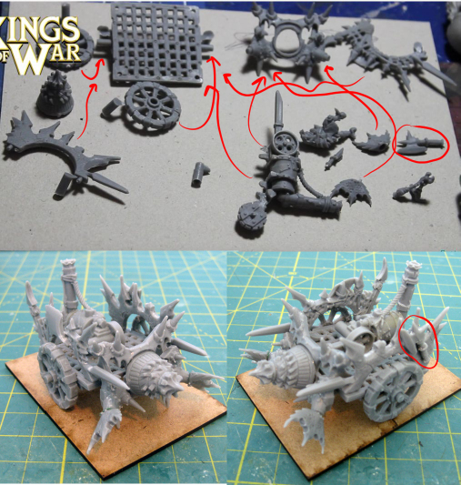

If not, here is pic so I will try to explain
Wheels to axies of carriege, engine and chimney part goes on the carriage in the middle, big thing with hole is big shield, it goes in the front, spikes to front and front part of engine goes through hole and drill bit goes on top of that, so it look like the engine is powering the drill. The two large spiky bits go on the top of the wheels, with big pointy bits forward, two small spiky bits go on big shield. Axe go on side, goblin whenever he fits, but I can`t remember where chainy thig goes. Hope this helps.
That helps a lot. I found a few more videos too that were a bit useful now. I think the issue is I need to bend the parts first so that they will even fit together how they are supposed to be then!

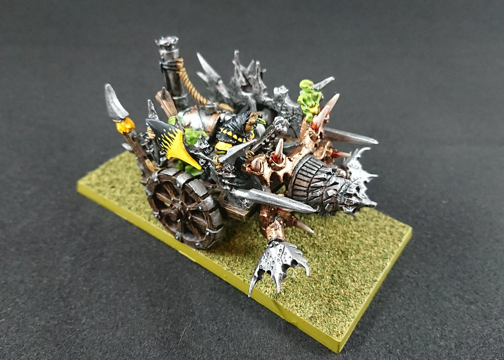

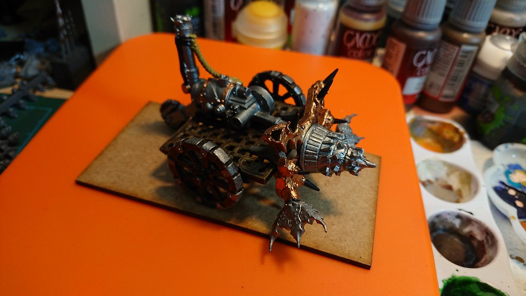

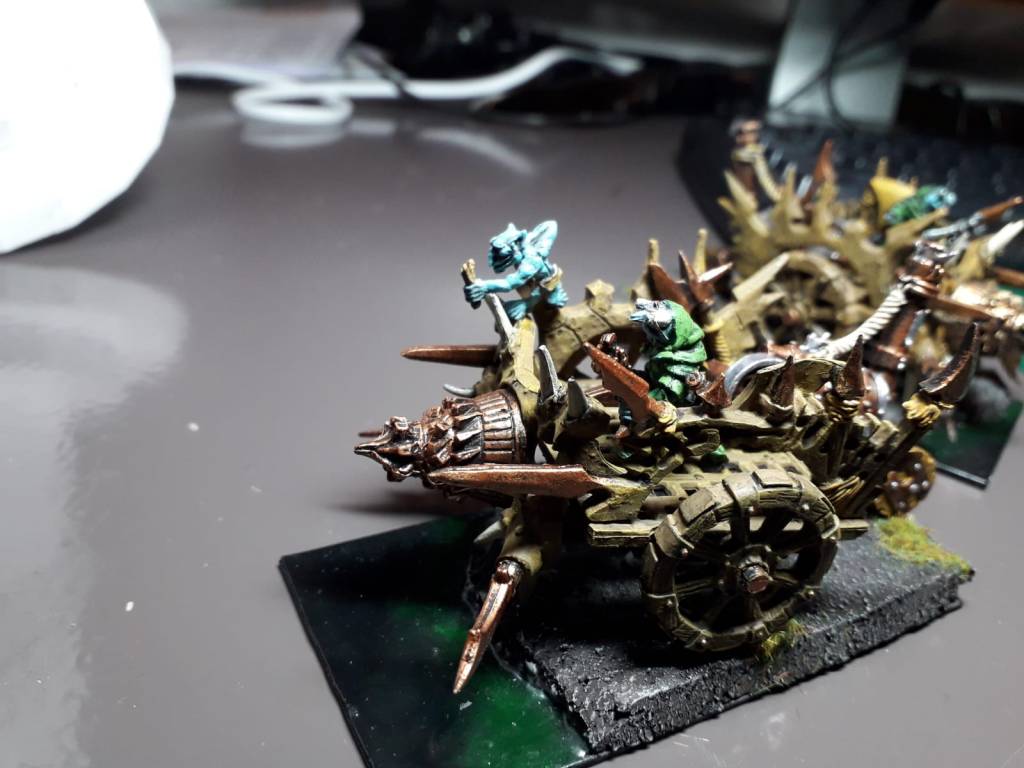

It was a fair way down my paint queue… but I’ve finally started btw! WIP only right now
Mould-line cleanup was a lot more difficult and painstaking than I was used to tbh with this hard plastic stuff - and I’m used to metal models, but this kinda seemed like the worst of both worlds there. However it did motivate me to get a new craft knife at least! So maybe with a better knife next time it would’ve been easier.
I used a hairdryer to bend the parts to fit together well in the end. I tried hot water but it was taking too long and I wasn’t confident about it (how hot? how long? etc) whereas I’ve used a hairdryer before for resin once and it seemed much quicker and easier for me.
I only noticed during painting later that I’ve glued a couple of parts not 100% correctly… buut eh. It’s Goblins, the fact it looks slightly messy is fine - and you’d have to look really closely to see where I messed up anyway. Plus I’m likely to get a few more of these models down the line anyway I suspect, so it will all add to extra variety in building them differently next time:
