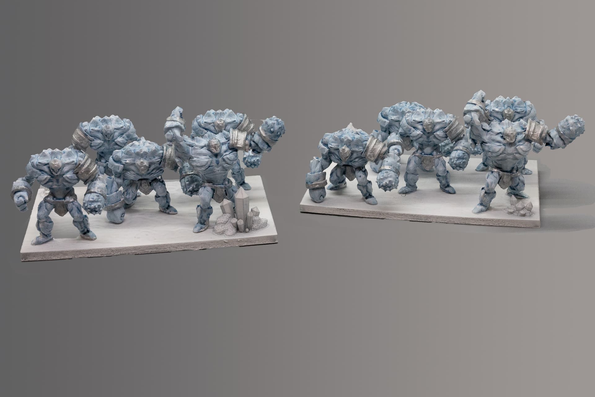

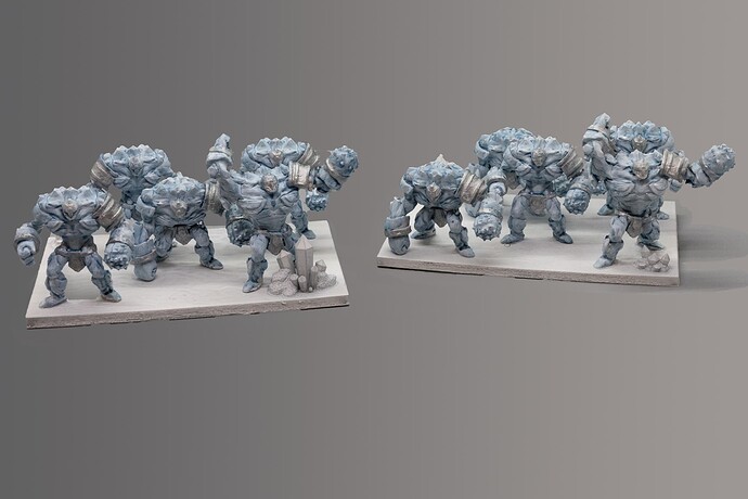

How do you get the ice effect for something like this? I’ve struggled to get the effect right. How are you experts doing ice?

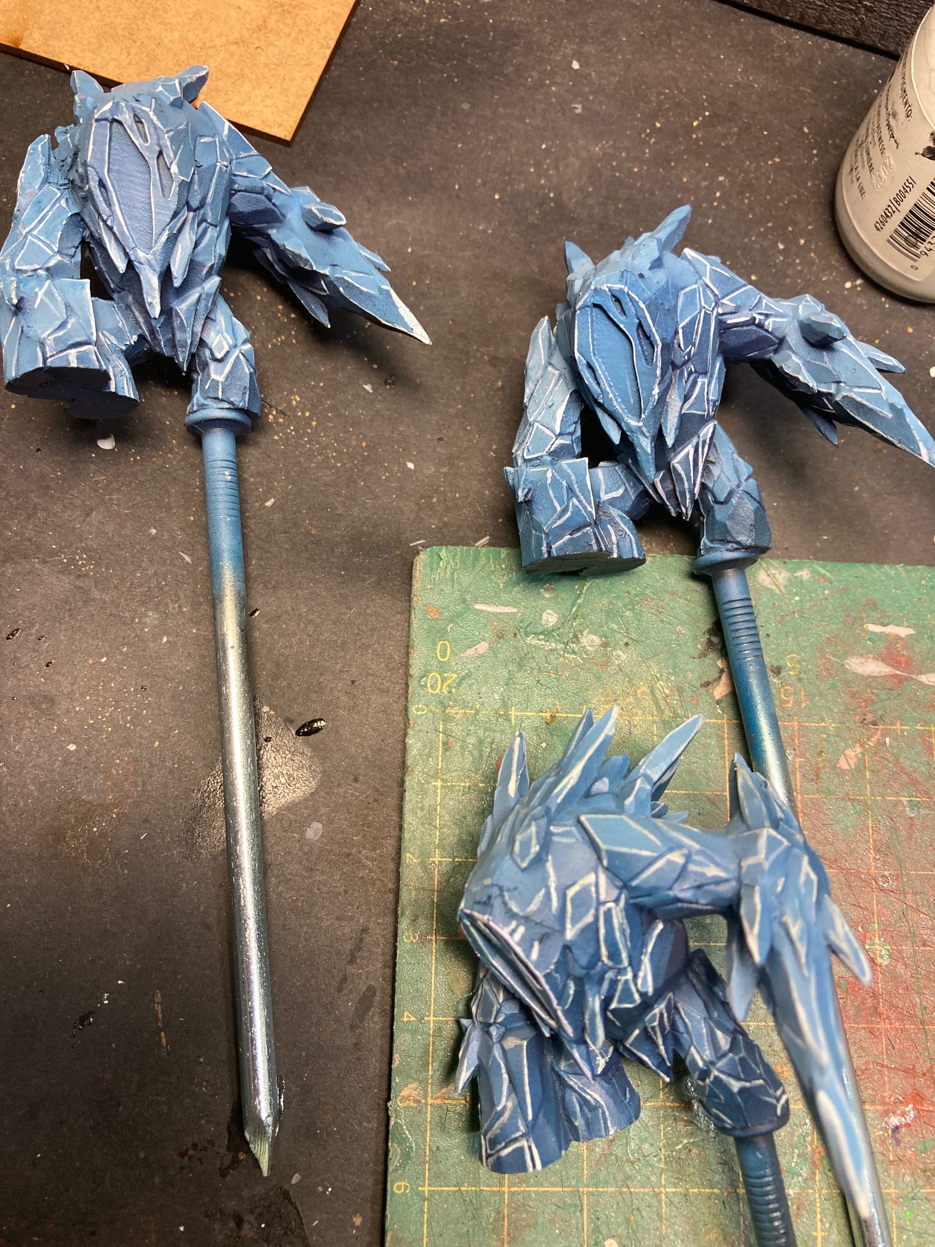

Little wip picture of my effort. I used patches of pale blue, green and purple. I’m certainly happy with the end result which I will post up
they look great @NealB
