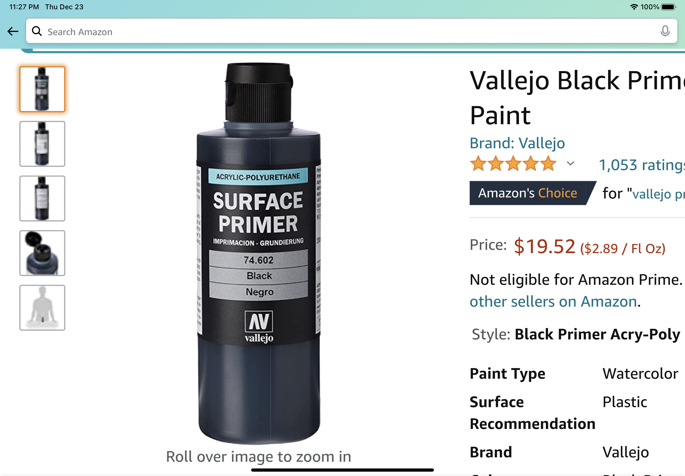

I also use the Vallejo 200ml pot pictured above for black primer (and black paint), works great. The Vallejo white just didn’t have the coverage I wanted so I eventually settled on scale75, if it’s grainy I haven’t noticed it yet, any variety of spray would certainly be grainer.
