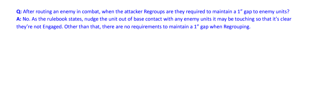

It’s answered in the official Kings of War FAQ (needs free download via the webshop)
Here’s a screenshot:
Thanks so much! Double points for explaining not only the source for the answer but the ramifications of what this means. So awesome
