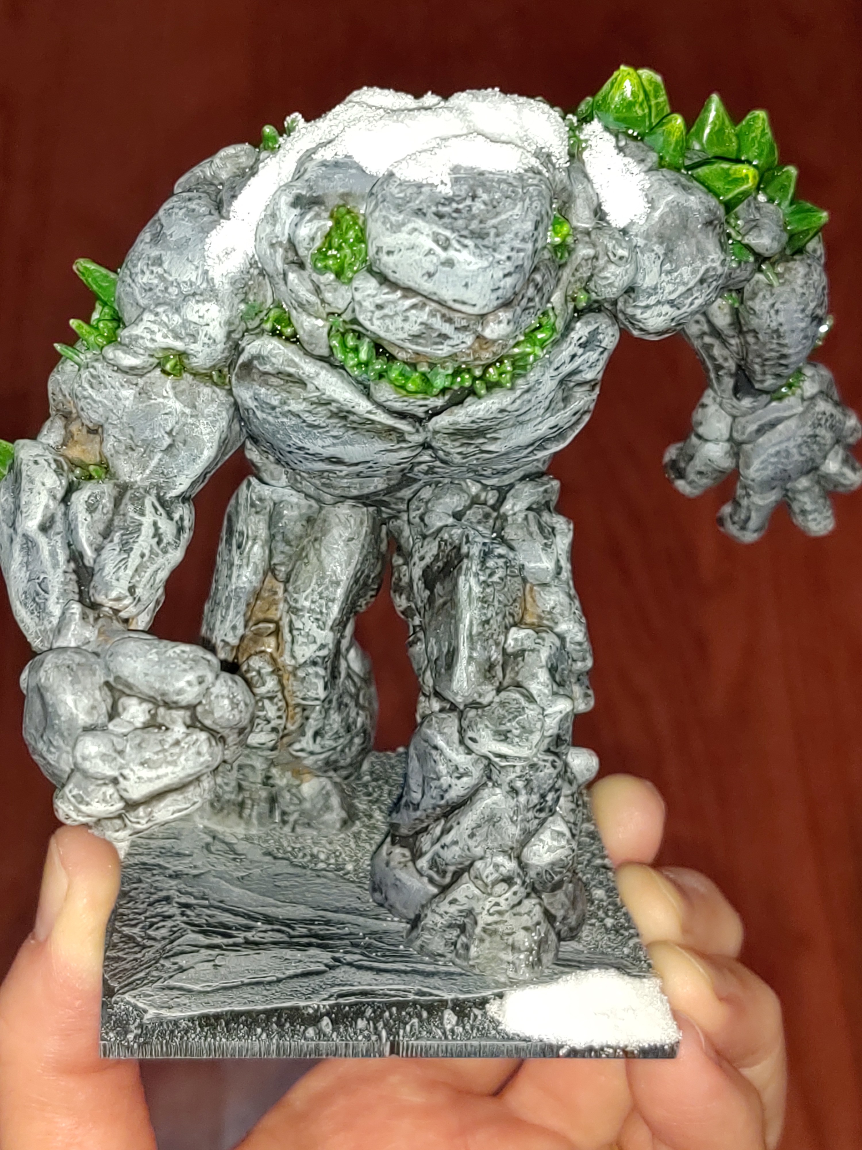

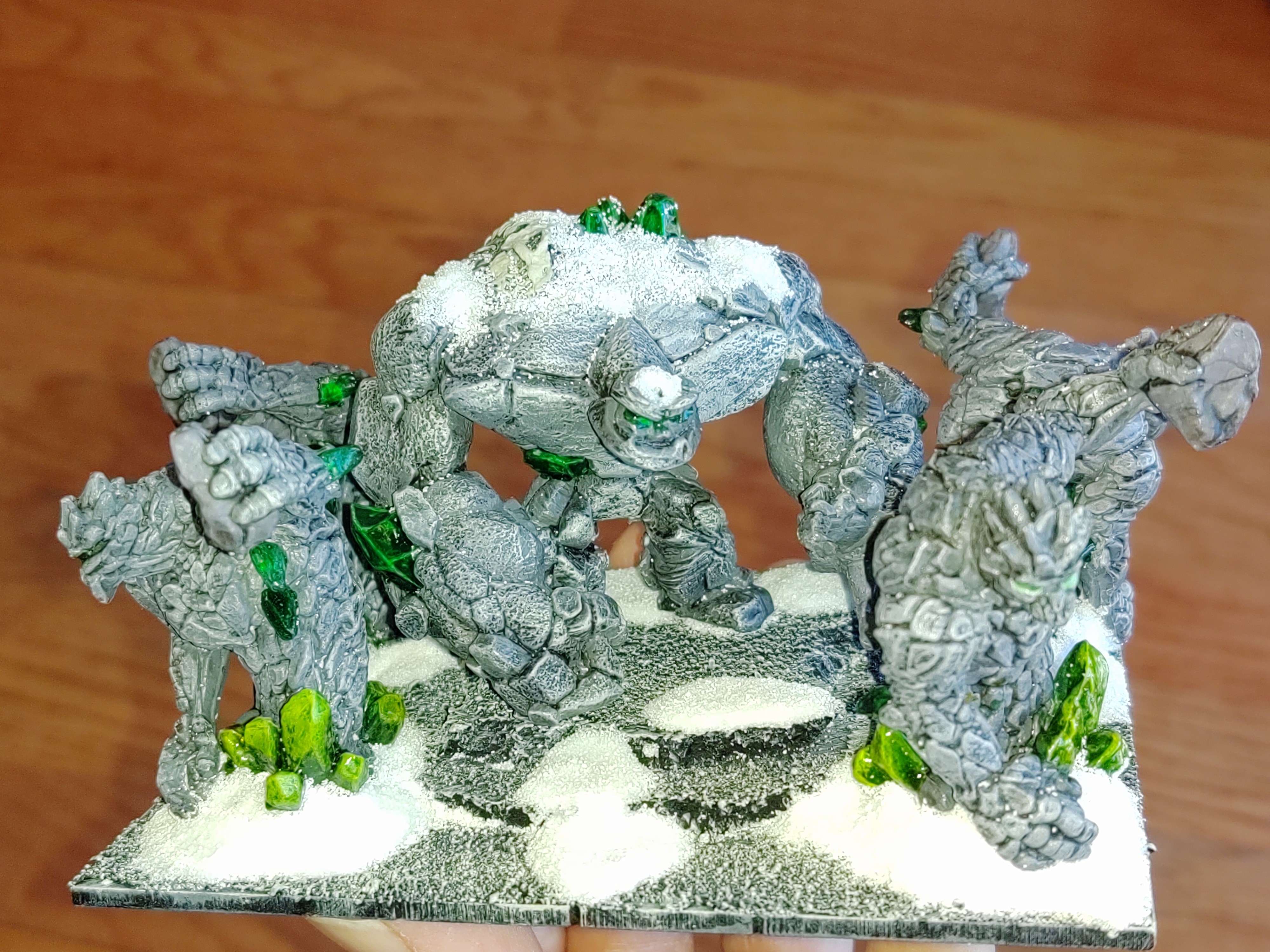

I’ve always taken the view that ‘less is more’ with snow on bases and that patches of it works better than just snow.

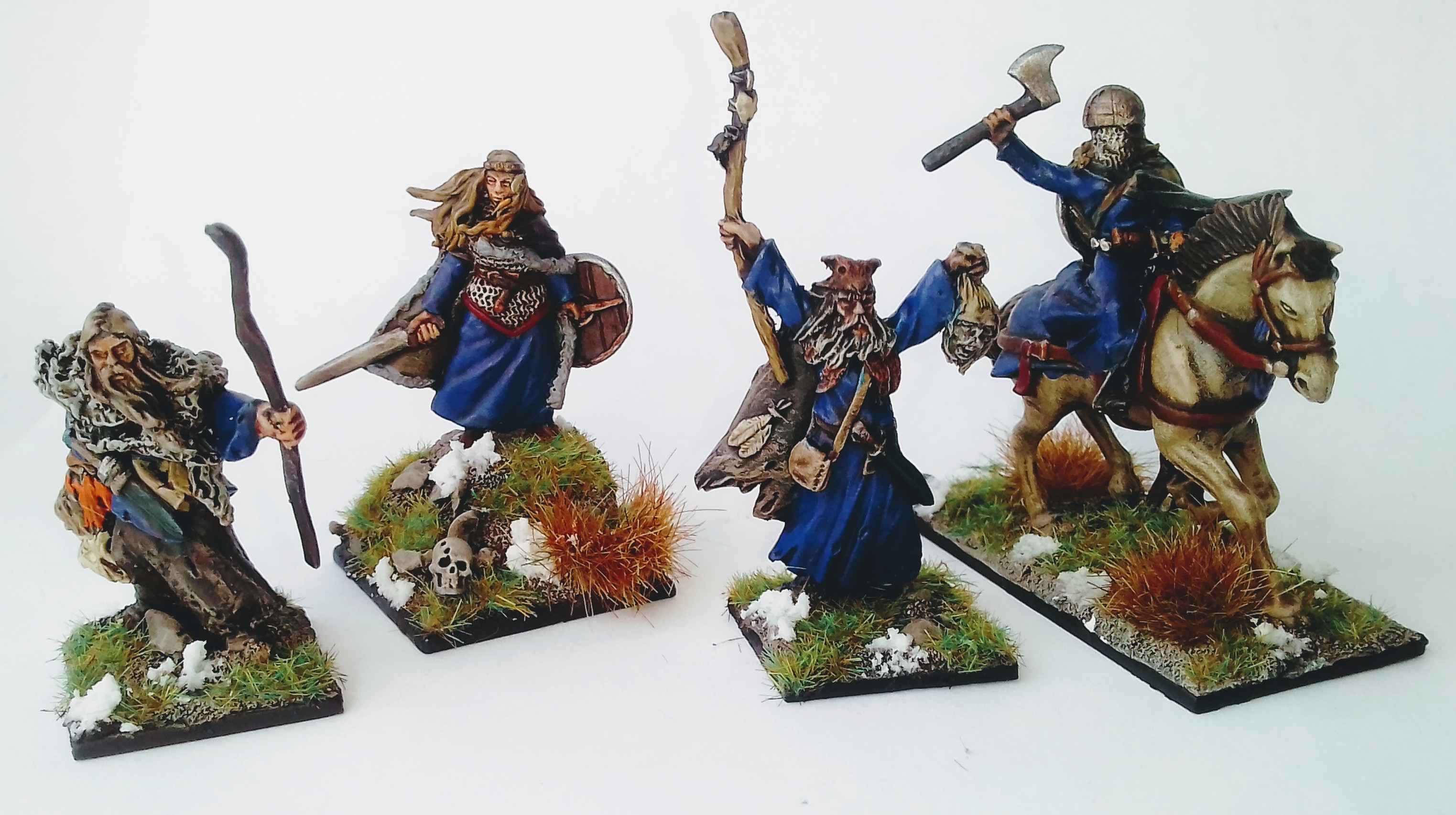

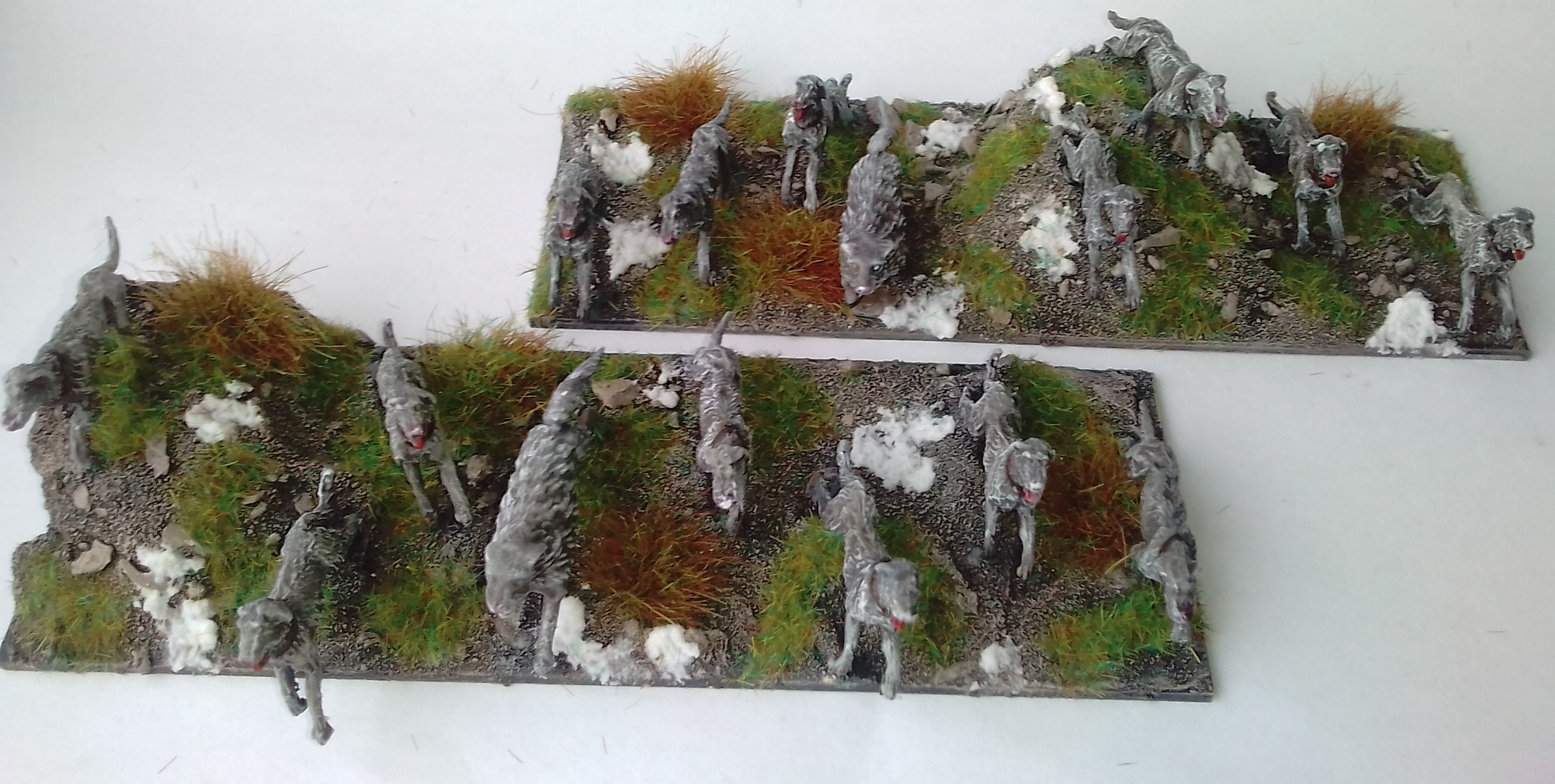

I’ve gone down that route with my dark age style stuff (Varangur and a growing undead force). The basing itself is filler and sand (with foam for height), grass tufts and flick, then gw snow.
Here are a couple of examples.
