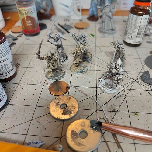

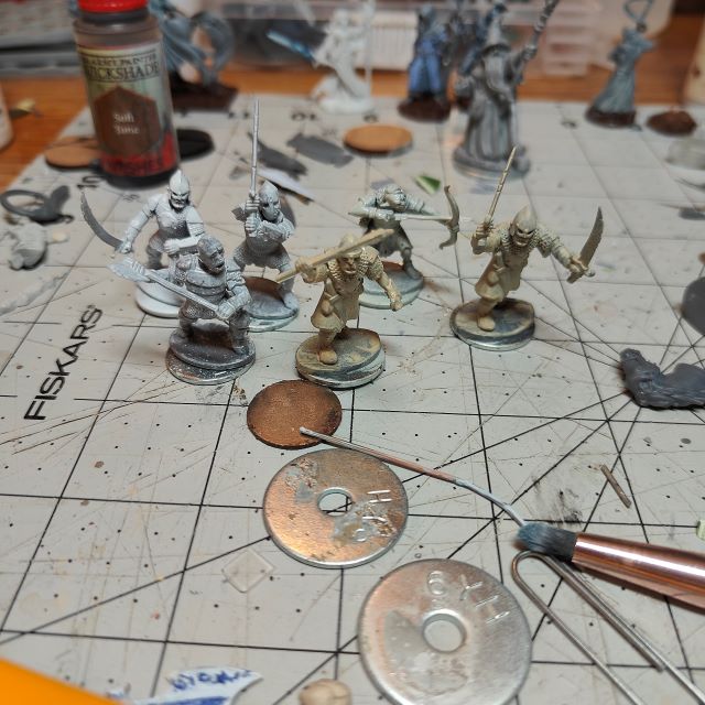

Both spray primed and brush primed orcs with half the brush primed and all the spray primed minis given a gloss medium coat.
A quick oil wash the the wash removed from highlight areas. (in theory this was supposed to be more brown but lamp black oil paint is very strong)

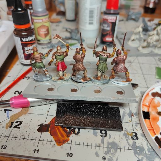

Then apply some Vallejo Xpress color.

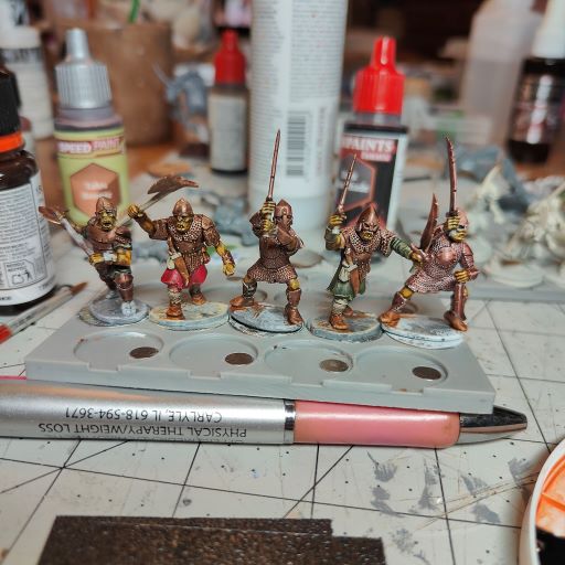

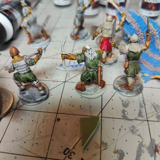

Left two figures using Vallejo rust metallic and on the right three Speed Paint Talos Bronze. Middle figure shaded with diluted brown speed paint the others with either strong tone or strong skin tone from AP.

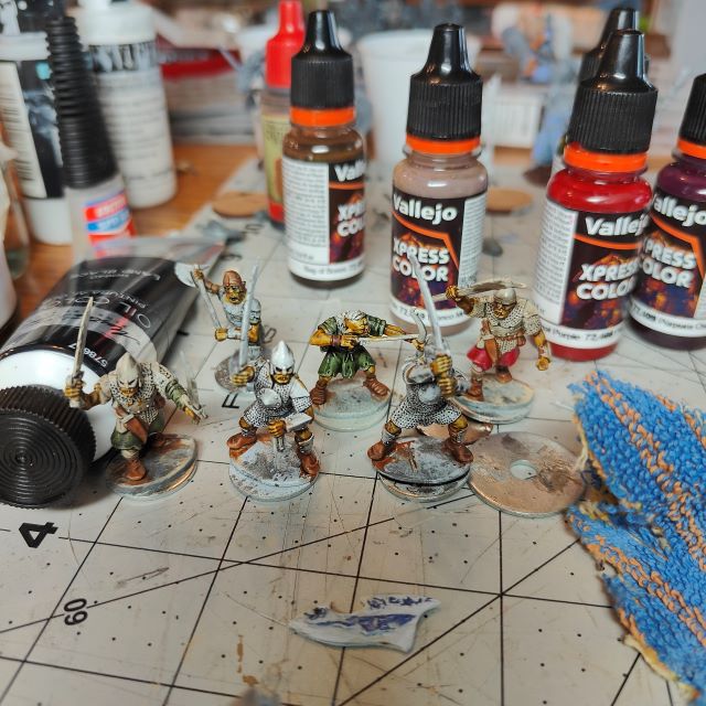

Watched some videos about using contrast over either silver or silver drybrushed over, in this case, dark brown. So why not give it a try.

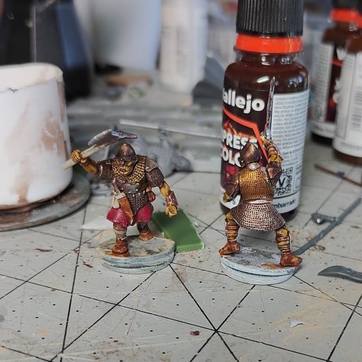

On the left dry brushed, on the right solid silver. The helmet, top mail, mail skirt and the shoulder pads were all done with different brown paints, some diluted a bit.
On average I think Either a full strength paint over the silver or half strength over the dry brushed silver work. Like the helmet on the right or the shoulder pads on the left.
