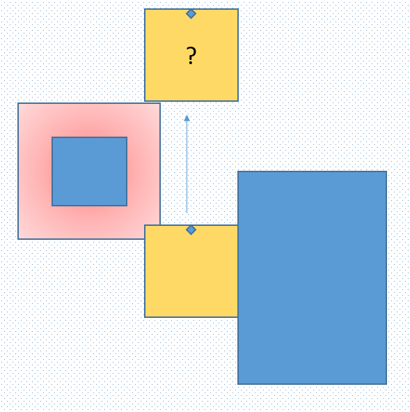

Starting with an enemy closer than 1” / when does it NOT apply?
Does the line
If your unit is not Engaged but begins its Turn within 1” of an Enemy unit, it may still move freely as long as it ends its Turn no closer to the Enemy unit than where it began.
  1. mean that units which start the turn Engaged may NOT use this ability to manouvre and move when there are enemies closer to it than 1" (since the line specifies “not Engaged”)? This would mean there is a sharp divide in the freedom of movement between units who start their turn in melee and units who start their turn outside of melee.
(edit: yes, the above was the correct answer):point_up_2:
2) or does the use of not Engaged refer to the same unit which it starts nearby, in effect: “If your unit begins its Turn within 1” of an Enemy unit which it is not Engaged with", meaning it always applies, in all cases (with Withdraw being the only exception as that has been specifically stated as the intention)
(edit: marked as spoiler because it was the wrong answer)
edit: In other words, the following move is NOT possible:

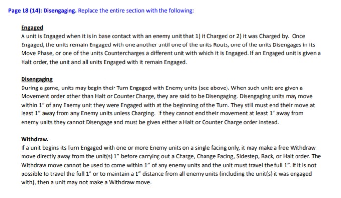

In my view Engaged is a yes/no state, as set out in the first para of the amendment.
It seems to me perfectly reasonable that unit that isn’t in combat (Not Engaged) has more movement freedom that one that was (Engaged) - and reflects quite a lot adverse comments about units “simply buggering off and fighting someone else”

I have always interpreted the rule as #1 but was never happy with it, #2 would be a better option in my opinion. I feel a bit rusty about the KoW rules after not playing due to lockdowns for too long. However, I recall having even more issues with the discussed rule. E.g. a unit is charged, no wounds are scored, but the charged unit remains Engaged and cannot Move/Withdraw due to presence of nearby units making it impossible to get 1" from the enemy that charged the previous round. If the interpretation #1 stays it makes really a big difference to how the game is played with respect to a previous 2ed when the units were kept separated after any combat. At least the 3ed rules on Engaged and Withdrawal were sold to us as there was no big change excepting the cases when a unit is locked in combat on two sides or was disordered.
The wording of the sentence doesn’t allow your interpretation, IMHO. “If your unit is not Engaged” can only refer to your unit, not the enemy unit.
In some respects units that are engaged get more options, as they may be able to withdraw before moving, but mostly they are more restricted. That’s because they’re engaged in combat, which limits their freedom to wander off somewhere else. To my mind, the rules on Engaged and Withdraw are all about clarifying what Engaged units can do, and it doesn’t require a separate statement to make that intention clear.
What about the fact that the sentence used to be under the paragraph for Disengage? it lead to many assuming it was valid for units to use also when disengaging. Regardless of the actual words used. when reading it properly you can pick it apart easily but many have read it quickly and assumed its intent. sure it says “turn” instead of “move order”. sure it says that it works when “not engaged”. So RAW there is no doubt. So why do influencal and normally very “in the know” people like Matt Carmack, Tom Annis and Todd Serpico just dismiss it out of hand and say that it’s meant to be understood differently? Do they know something we don’t (upcoming RC decision for instance)?

I have been told specifically by Pat in the RC that no Withdraw is possible if you are not 1" clear of all enemies. Of course I wish I didnt need to namedrop anyone, and that it just could say extra specific in the rules.
I really seems like they assume that new rules > old rules, which isn’t barking mad I suppose.
Think the biggest issue is that the reworded rules in the FAQ effectively changed how it works from the previous version, rather than simply clarifying it.
As commented above, I think the wording is clear and it makes sense as a whole, but was quite a big shift without anything more said about it.
Note - I don’t however feel that the RC need to explicitly provide full reasoning or justification for changes.
So, the forum member vote is over, with 76% voting for this outcome:
The line
means that units which start the turn Engaged may NOT use this ability to manouvre and move when there are enemies closer to it than 1" (since the line specifies “not Engaged”). This means there is a sharp divide in the freedom of movement between units who start their turn in melee and units who start their turn outside of melee.
