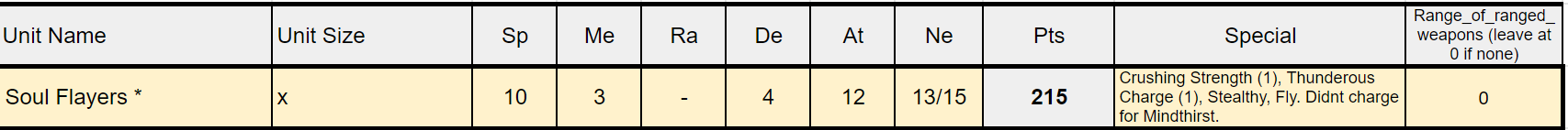

I did make a unit cost calculator for fun in 2019, based on an interpretation of the costings back then.
Update: It works! And its open for anyone to use. Just punch stats and keywords and get cost back.
(not all keywords are supported, those that work are listed below the unit fields)
(From the top of my head, the original formula that Nick make was “damage output plus durability”, then multiplied by speed in the end. And having a KoM Shield Wall (i think) unit cost 100, and scaling and tweaking everything from there. I wanted to capture the tweaks and cok updates into the pricing and try to quantify the value of keywords too. And see if I could recreate a non-linear but still quite transparent formula.)

Good thing Soul Flayers are getting looked at. 50 points underpriced at 165 today? :smiley:
I mean, the calculations are to be taken with a pinch of salt, but thats an indicator something was off there.
(I didnt even factor in Wind Blast there)
