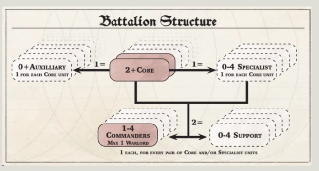

Why do you think the list building was more complex in 3rd?
I’m not a new player, so maybe I can’t see the issues new players would have, but list building is way more fiddly and annoying in 4th than 3rd. What was complex about 3rd?
From what I was told by people who started shortly before 4th was released the system of unlocks and too much freedom was overwhelming and hard to keep track unless using the Companion
Core unlocking Specialist, unlocking Support is easier to follow without list builder over Regiment unlocks 1 Monster or 1 Warengines or 1 Hero and Hordes unlocking 1 Monster and 1 WE and 1 Hero (specially when removing units during writing the list)
In addition there is now a more clear starting point over “any Horde is good”
Not that it makes a difference once you are used to it or have already played the game but newcomers often want a more straight forward guide on what to buy and build before they play the first game (and not need to play first to know what to buy)

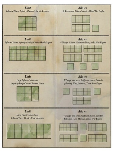

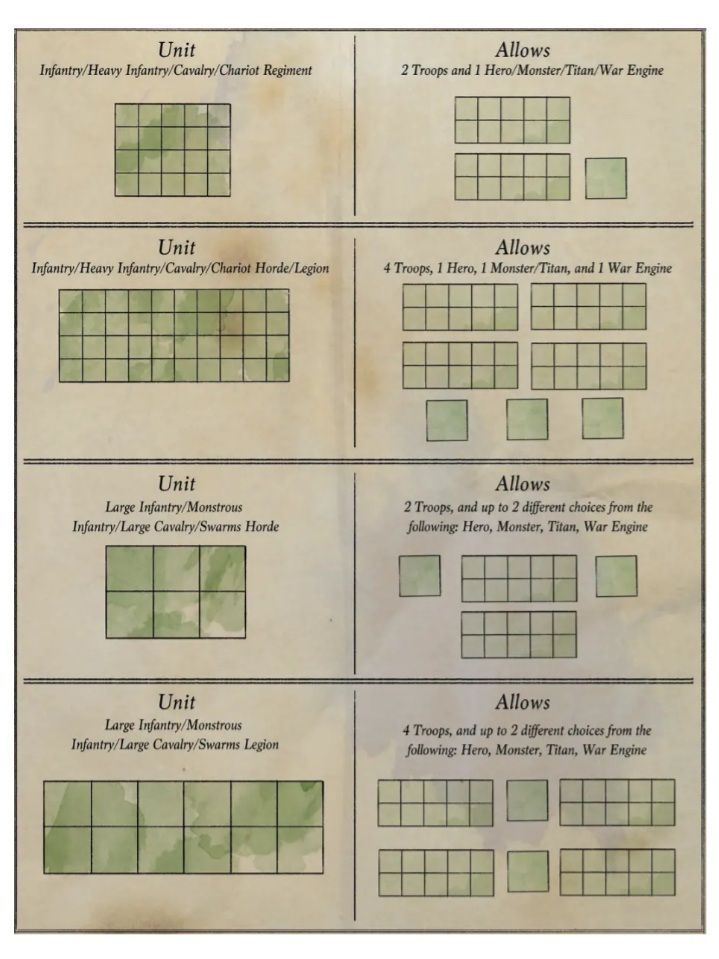

Alright, fair enough. I don’t think I ever found list building in Kings complex, especially compared to other games, but I started over 10 years ago, so I can’t really remember how I felt as a beginner.
The list building/unlocks in 3rd really wasn’t that straightforward, it was just something that we all got used to, rather than having to explain.
Just compare these.
