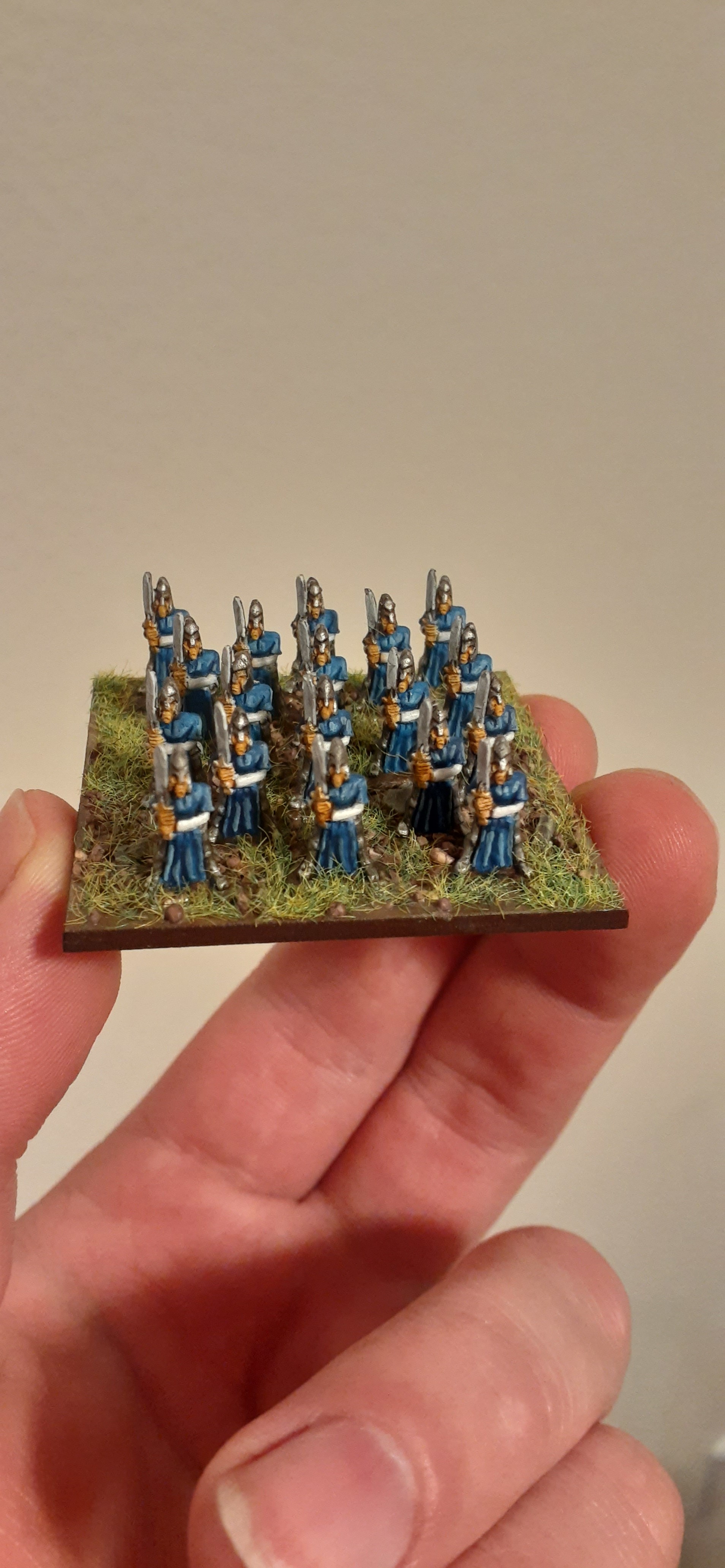

What do you all think I could use these elves for? Pendraken has a cool 10mm line, I have a ton of them.
I’m thinking palace guard?

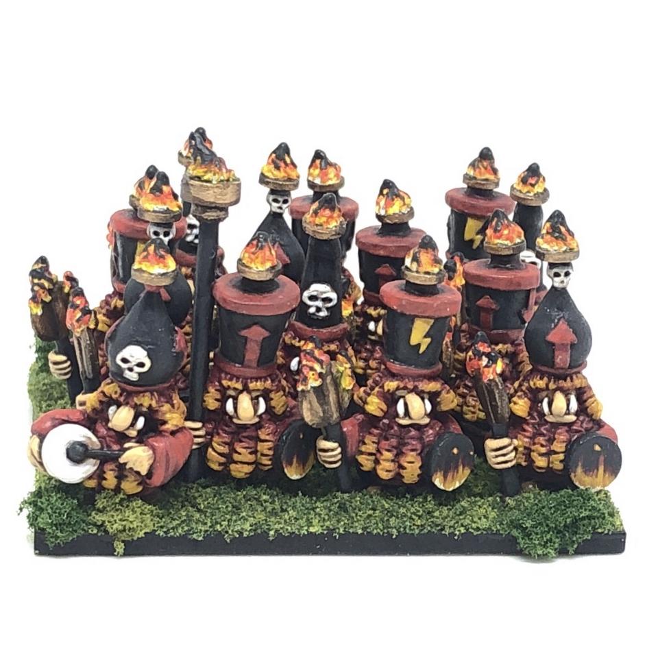

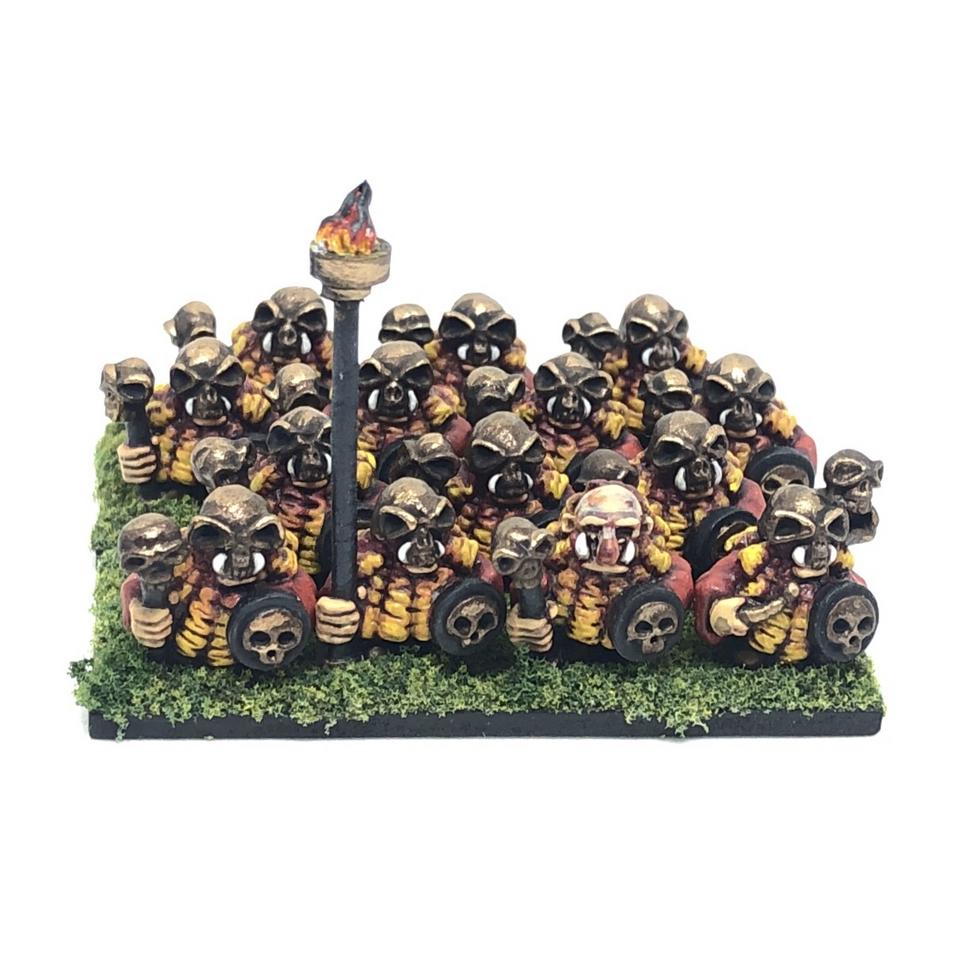

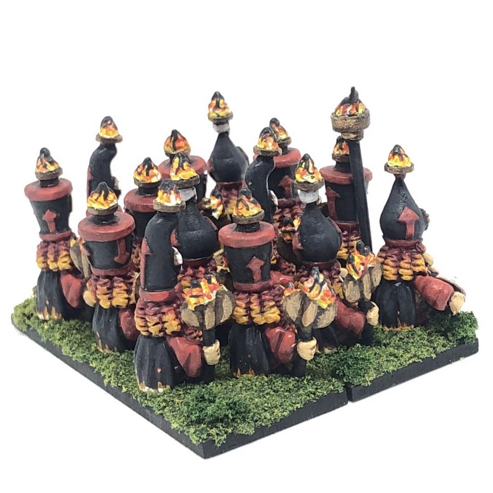

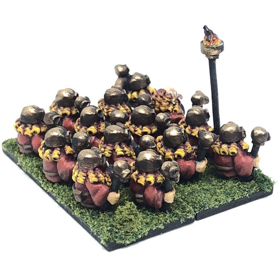

I recently bought a load of Chaos Dwarfs from Excellent Miniatures for Warmaster. While cleaning them up I did notice that a stand is 10 models, so perfect for a 10mm KoW.
Always great when I can get multiple use out of an army.
