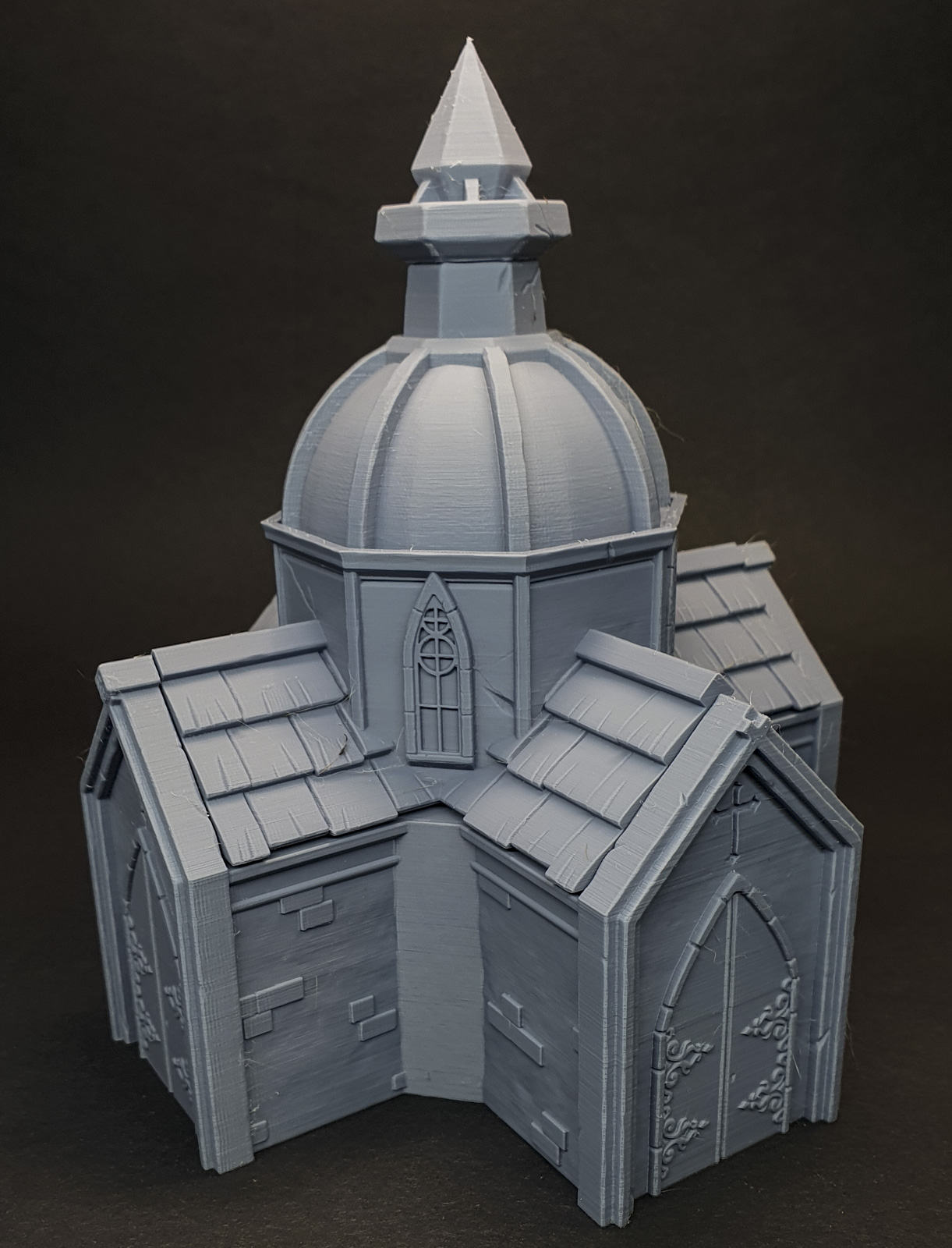

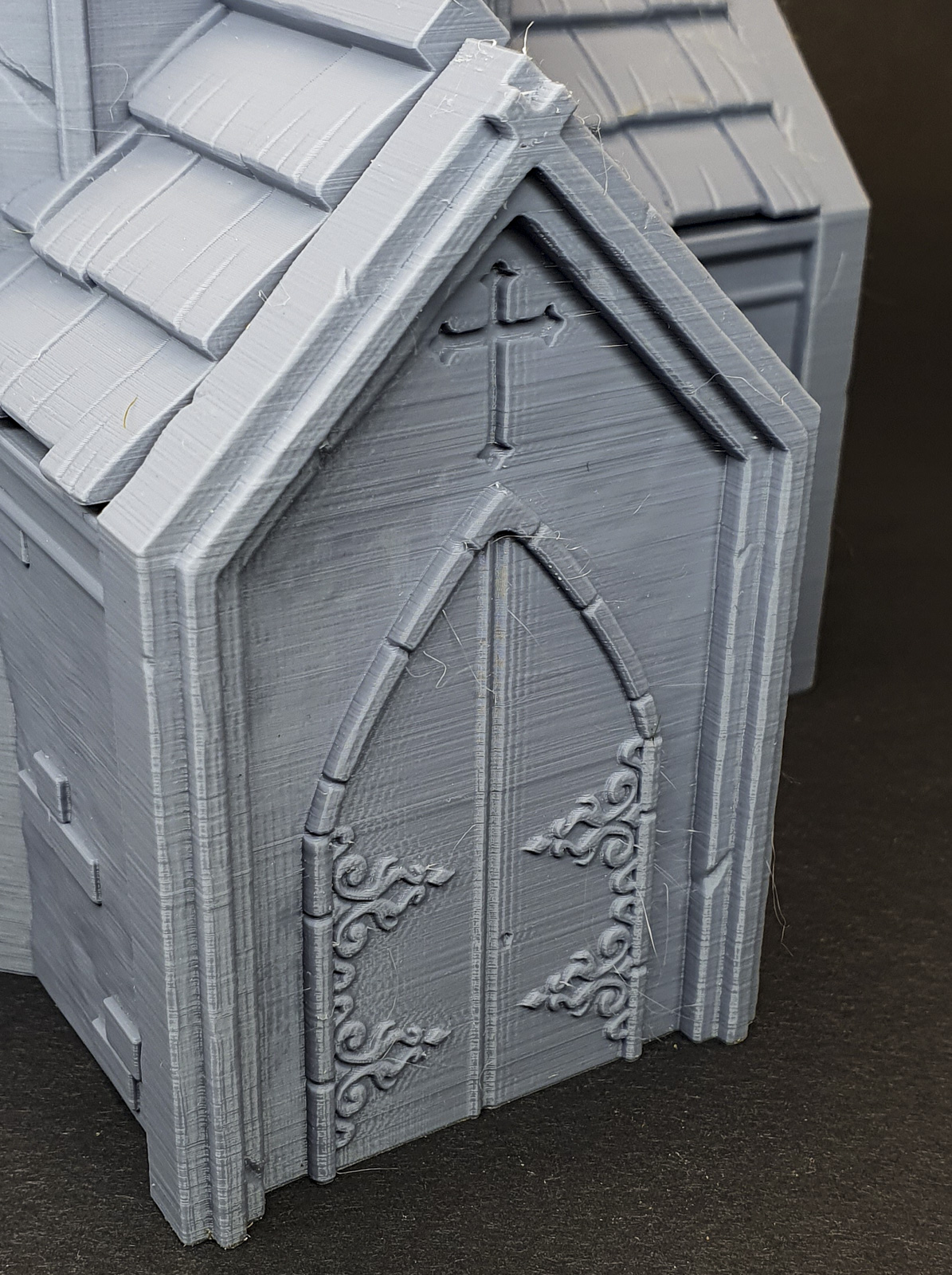

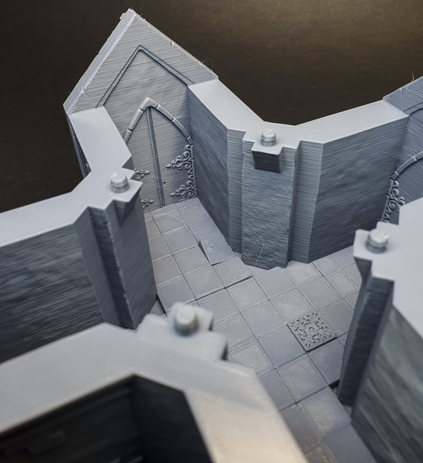

Here an example printed on the Prusa, this is straight off the print bed with no prep, it needs a bit of sanding and some clean up. Would it be better printed on a resin printer, yes, is it good enough for my needs, yes. The cost is probably around 3-4£ in materials.

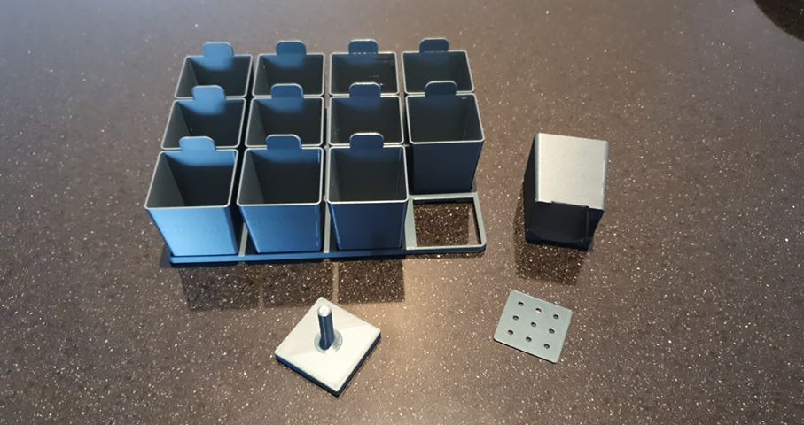

And here are the seed planters :grin:

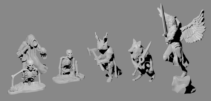

Now these are nice, and show one of the benefits of 3d printing. Designers can take a risk with designs without the massive financial gabble.
Would love an army of these for Kings of War.
There’s also this guy who is sculpting whole armies as modular minis for Kings of War. He did the whole Varangar and Sylvan kin lines already.
