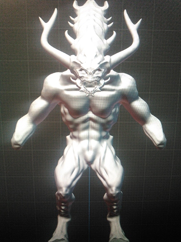

I’m working on my first sculpts, a Bloodletter for 40k:

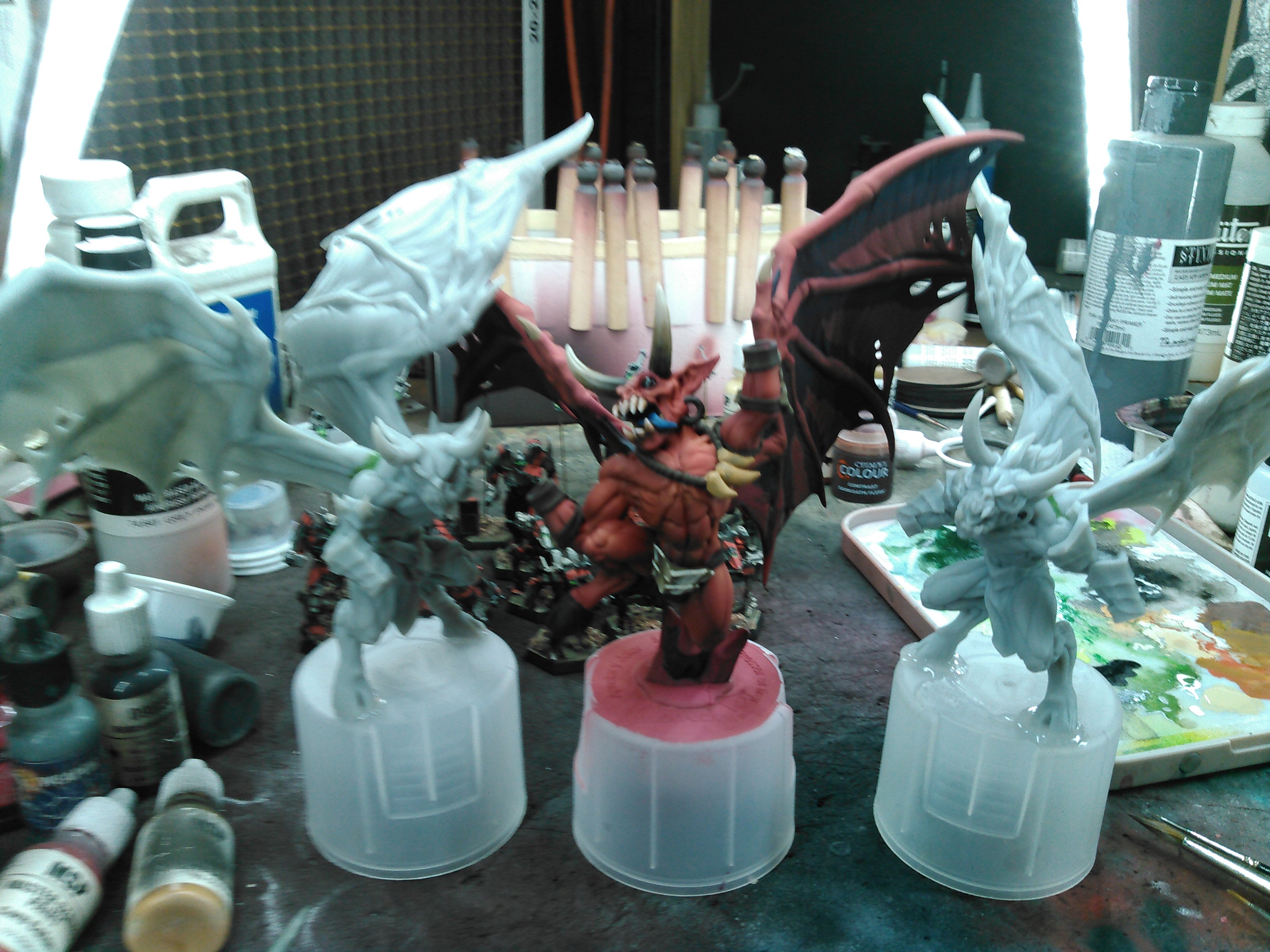

Also remixed some Bloodthirsters.
Impressive! I like the stockier bloodletter.

Thanks! I’m satisfied with it so far as my first sculpt.

Nice upscaled Arty Guild demons (pretty sure!), great smooth paint as well. Bloodletter is looking great!

Yes, the Artisan Guild minis scale really well. I added some wings from another file from Archvillain I believe, possibly Comet Lord (can’t remember off hand).
