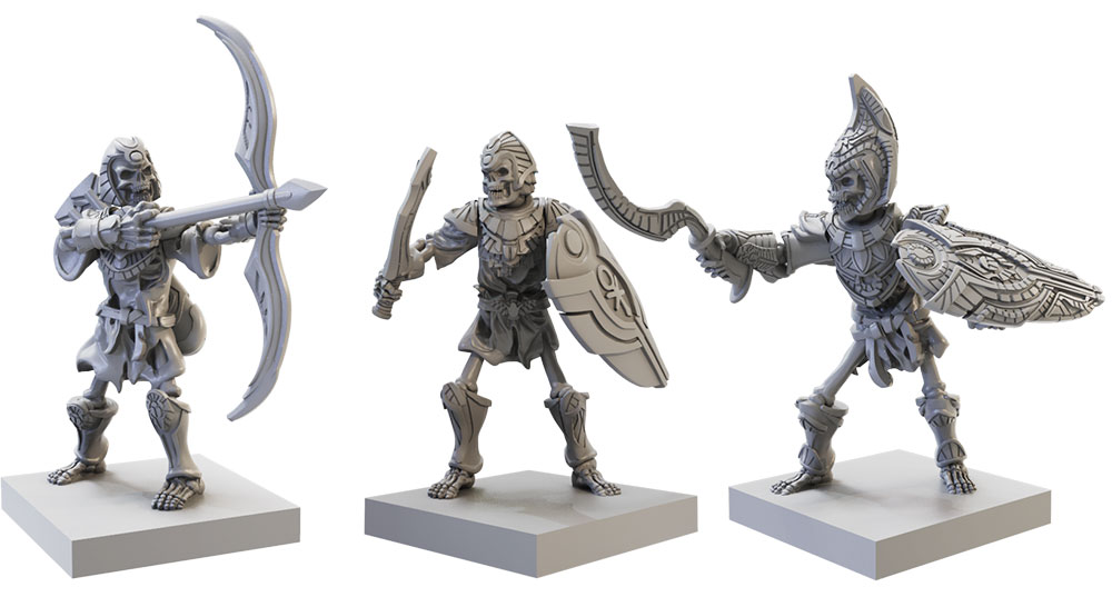

hard plastic EoD is unexpected, kind of
as being the last metal-plastic hybrid army and Mantic replacing metal with resin, that something is coming up was expected, just not a full plastic release
but finally having EoD plastic horses makes conversions for chariots easy, can’t wait to see more of those
Anything that means we don’t have to cast those metal pieces any more is awesome

Plastic skeletal cavalry is great news.
