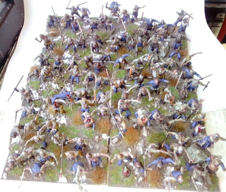

Tend to build most normal infantry in regiments, light or shooting units in troops and a handful of stuff is built straight as hordes.
These are zombies/draugr built as a horde, 3 regiments and 2 troops which can be combined- so can run 4R/1H, 2R/2H, 3R/1L, 1R/1H/1L
Don’t do anything fancy if combining - just temp stick together with masking tape under the bases
Model numbers wise, most of my infantry regiments have 14-16 bodies, 6-8 for troops but tend to have reasonable amount of scenery on the bases.
