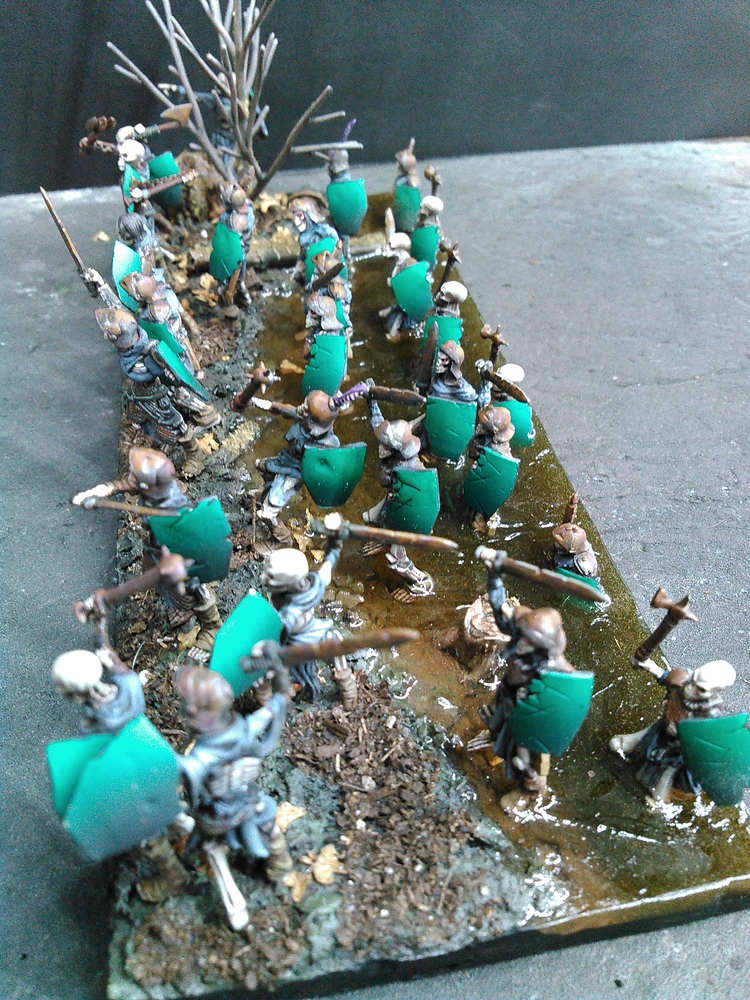

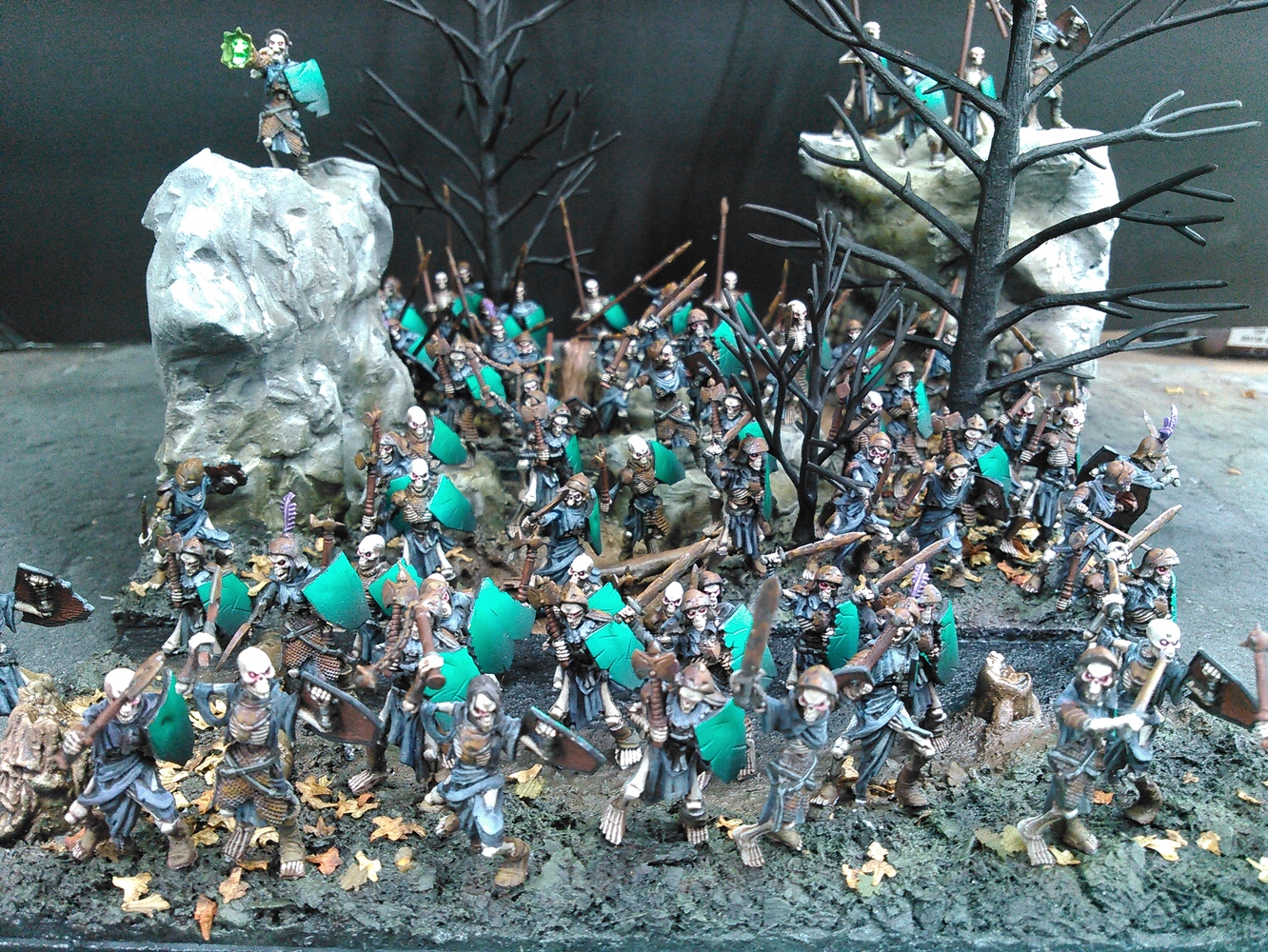

Most of my undead have crippled feet, because I cut them of off their bases. You won’t notice when in troops or regiments. See for yourself:
Thank you, that’s exactly the idea I’m aiming for! Those look brilliant!
Did you hack them off with clippers and xacto knive?
Thank you! I used an xacto knife. It works quite good. I accidentally cut off half the foot a few times. Those models qualified for middle to back row.
The round bases have to come off. This is a serious disadvantage of most Mantic models compared to Citadel. Here’s my recent undead after multibasing and here before.
Note that the paladin foot guard (which these vampires are made from) have feet which extend from the round base, making cutting them off quite easy. At least easier than -for instance- those darn goblins. cut my fingers a few times cutting these loose.

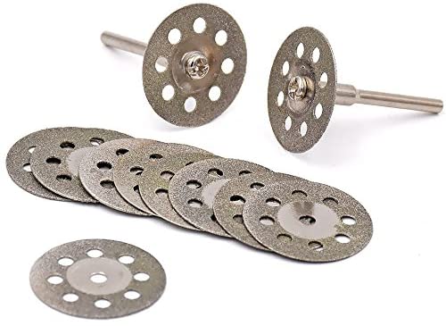

These powered by a Dremel go through them like butter. I’ve done close to 200 miniatures and am still on the first cutting wheel.

Those look great! I like the leaves on the ground, what did you use to create those?
Edit; I did not realize this thread was 3 years old, the date just said May
Thanks! I used a leaf punch, I think one of the Green Stuff World ones. The material was coffee filters that I colored with diluted paint/ink and let dry before punching the leaf shapes out
