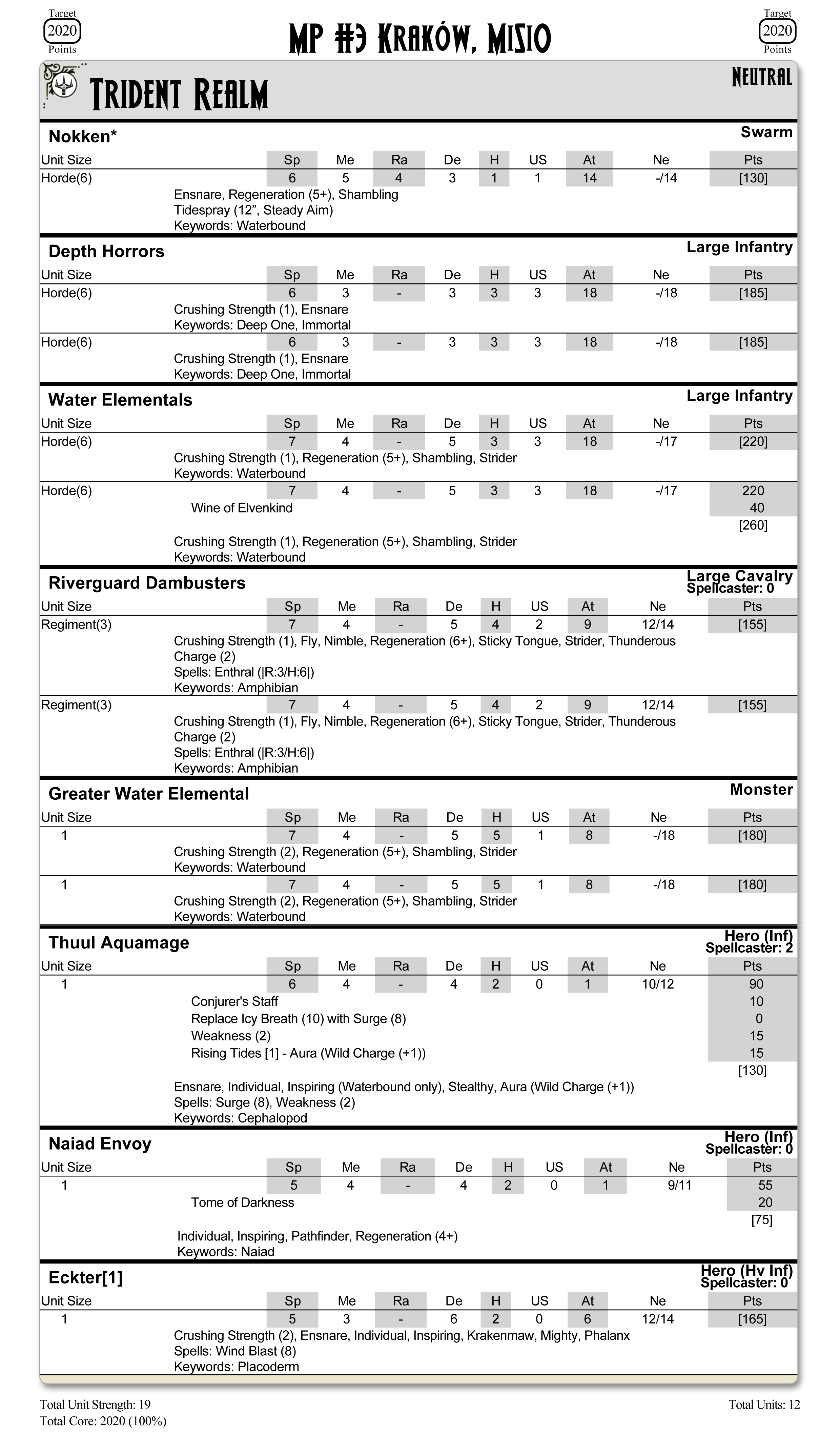

2020 pts
Riverguard Treeleapers (10) Troop [1 US, 110 pts]
Depth Horrors (06) Horde [3 US, 185 pts]
Water Elementals (06) Horde [3 US, 260 pts]: 40 - Wine of Elvenkind
Riverguard Dambusters (03) Regiment [2 US, 155 pts]
Greater Water Elemental [1 US, 180 pts]
Knucker [1 US, 150 pts]
Eckter [1] [165 pts]
Siren [135 pts]: 10 - Conjurer’s Staff, Drain Life (6), Weakness (2)
Thuul Aquamage [160 pts]: 40 - Wings of Honeymaze (Individual), Rising Tides [1], Surge (8), sub, Weakness (2)
As someone playing against trident realms, I have to say, Knuckers are the most annoying unit in the list, cheap enough to take quite a few of them, and it gets really difficult to cover flanks against all possibilities late game, especially when multiple units are set up in a way that limits where you can move without taking a flank charge.
Knuckers are nice tools. They do very little damage but can take a counter with CS1 and ensnare and either re-position or strike again.

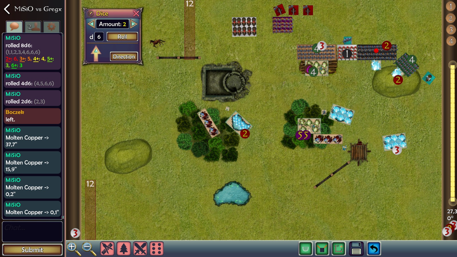

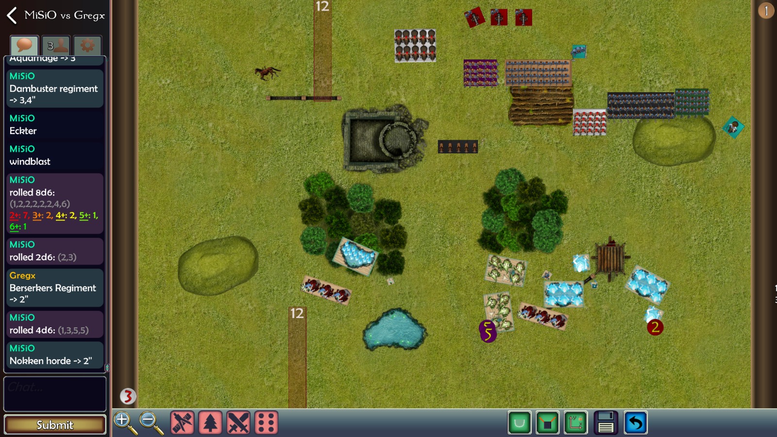

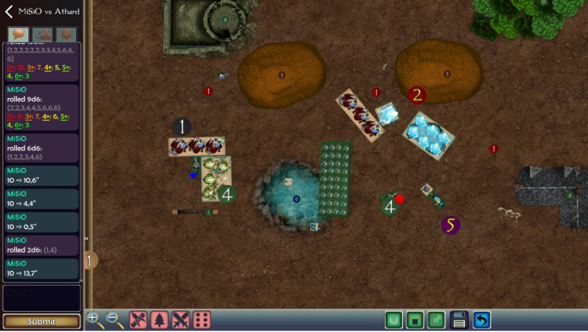

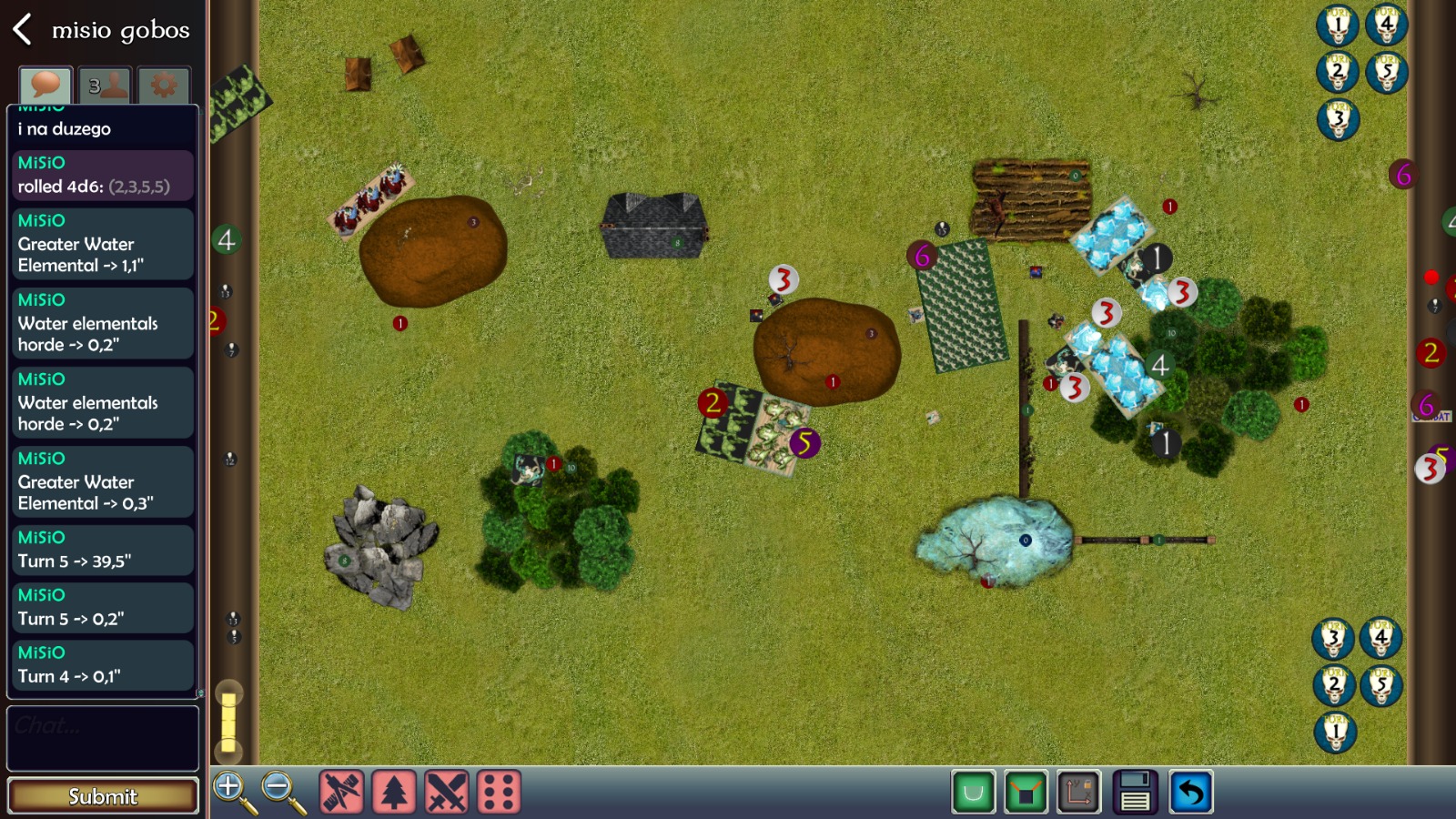

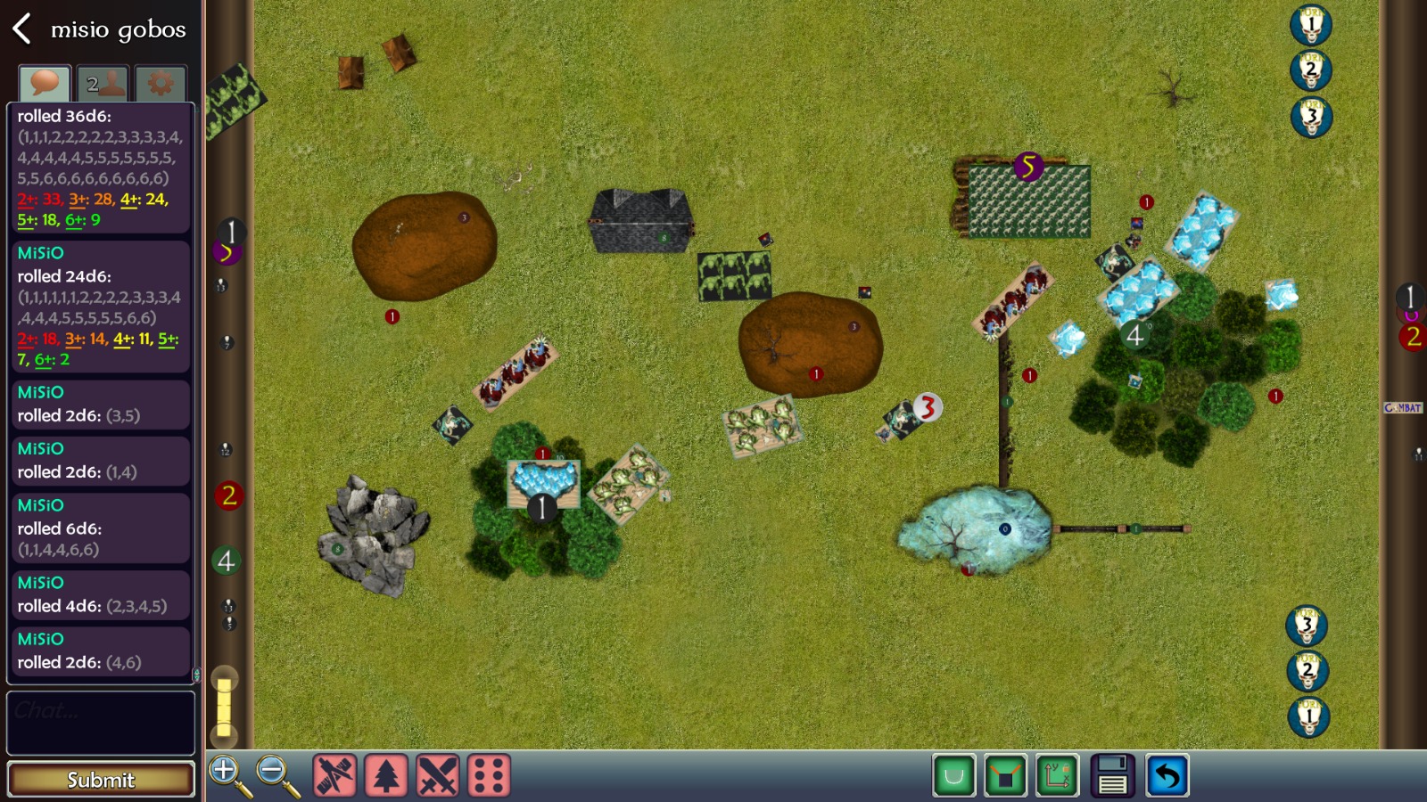

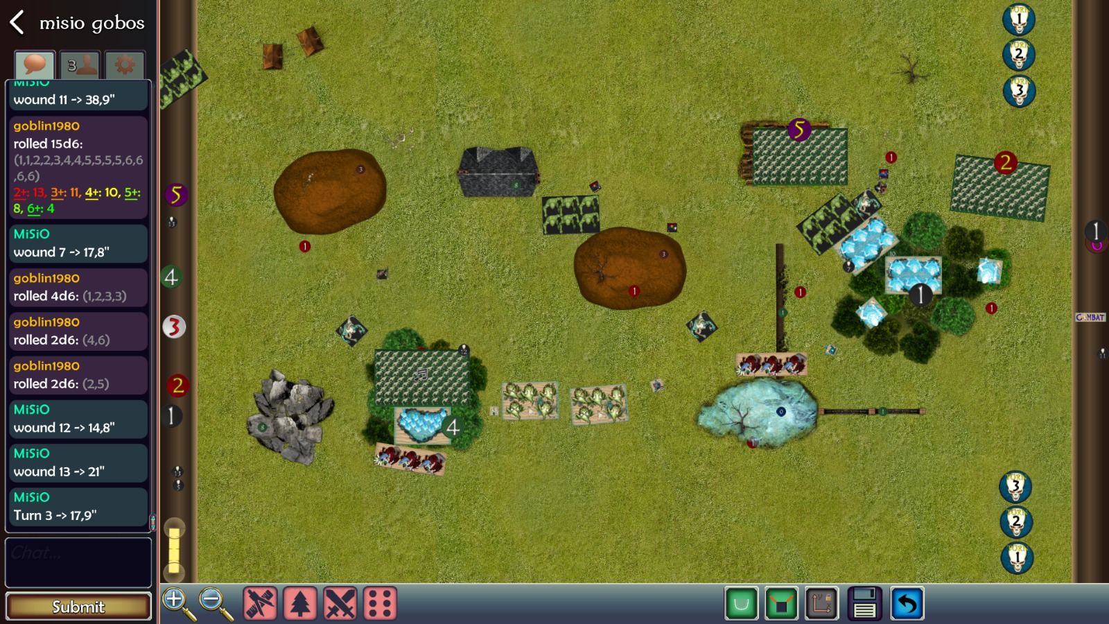

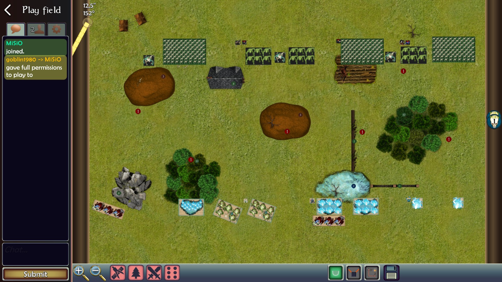

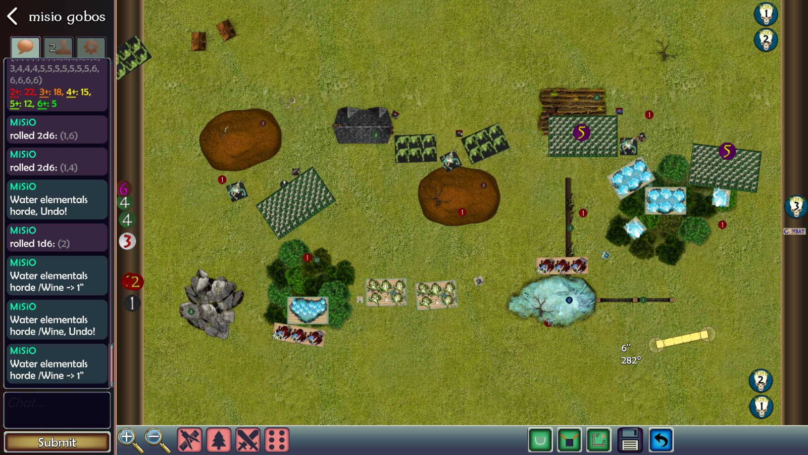

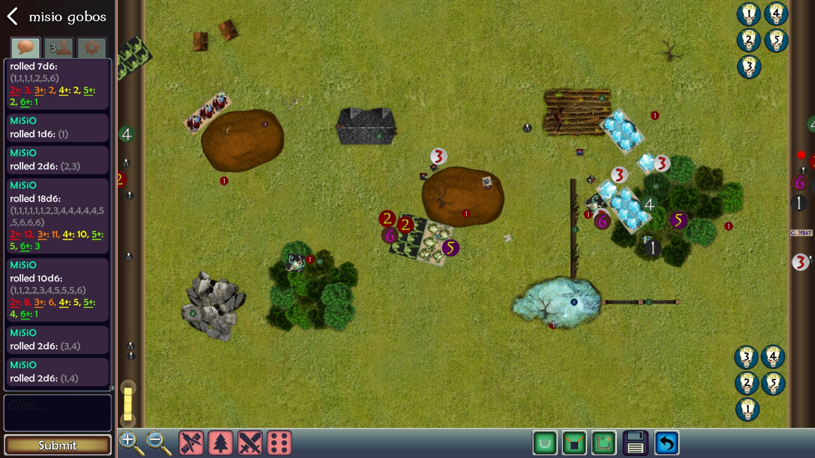

Scenario: Kill (unfortunate for me). I did some weird deployment choices but this was a test game to learn how this army should deploy. And I have learned a lot from it too. I miss 2nd Weakness but cheap surge (4) is a good replacement.
I have no idea why people did not like cannons when they came out. They are AMAZING. Sitting behind infantry, popping lead at anything H3+ hey can see :smiley: They did some serious damage tun I and II to my depth horrors. 10 wounds each is a lot and most combat was done by elementals. I was unclucky with cannon rolling to hit (50%+) and had some bad combats where berserker regiment with a lord took out WE horde in one round in the middle but it was a good game.
Ended up in a 10:10 tie so nothing to complain about.
What I have to manage better is indivudual placement (surge range, aura radius etc.). Boots of Levitation would be awesome on an Aquamage but there are no points for them.
Nokken will replace heartpierces as my shooting support even outside surge lists. They are great on defence and does better damage than heartpiercers at 12".

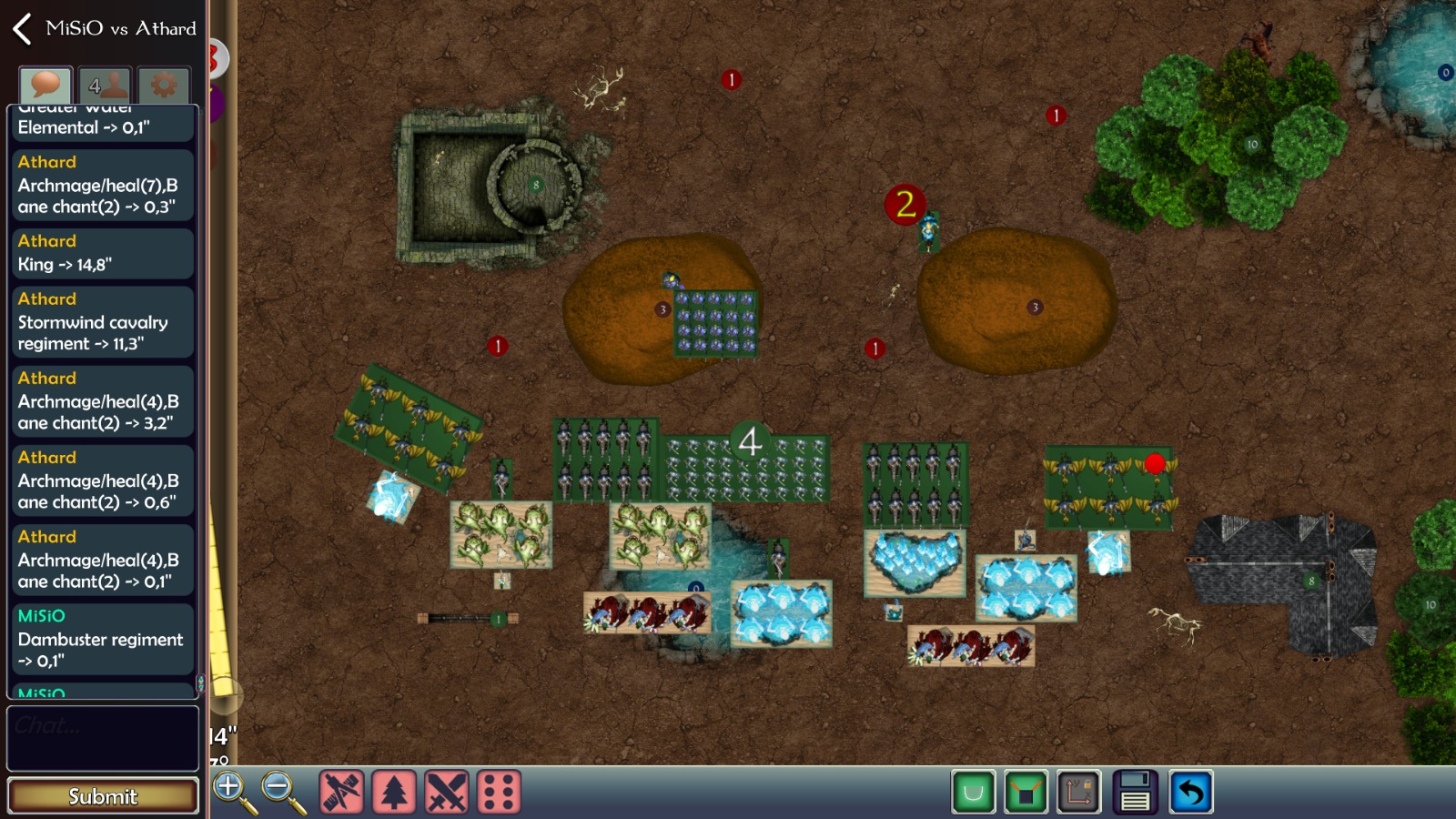

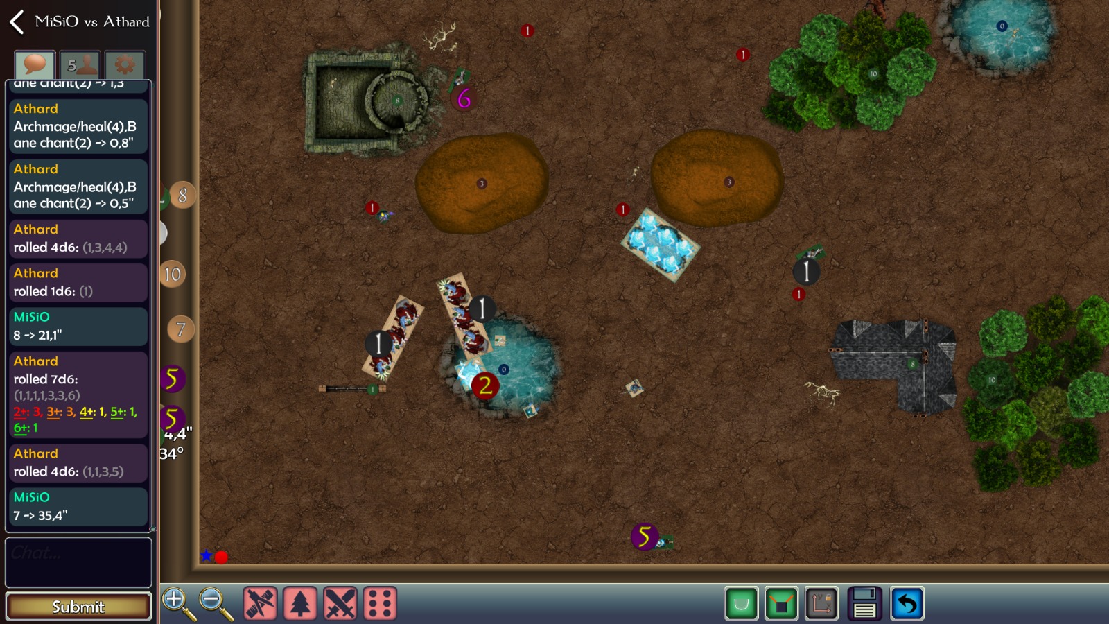

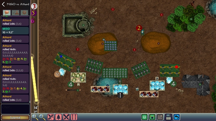

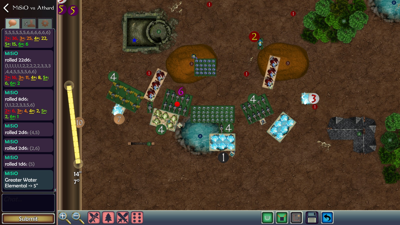

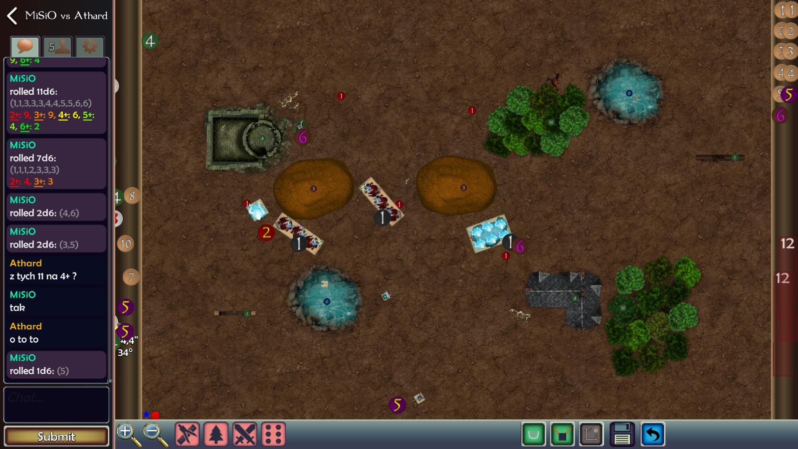

Had a 2nd UB2 tournament game today. Against elven alpha strike.
  • Horde of Palaceguard, sharpness
  • Seaguard regiment,
  • 2x Stormwind Cav regiments,
  • 2x Draconrider hordes,
  • 2x elven prince, one with duellist, mounted
  • 2x elven mage, heal(4/7), BC, one mounted
The idea is to hit hard with Cav and flyers and then kill what is left with palaceguard (heal heals a lot to survive shooting/counter-damage).

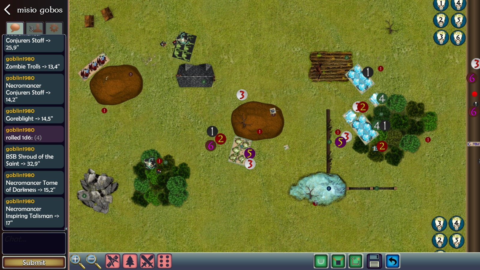

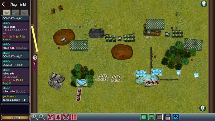

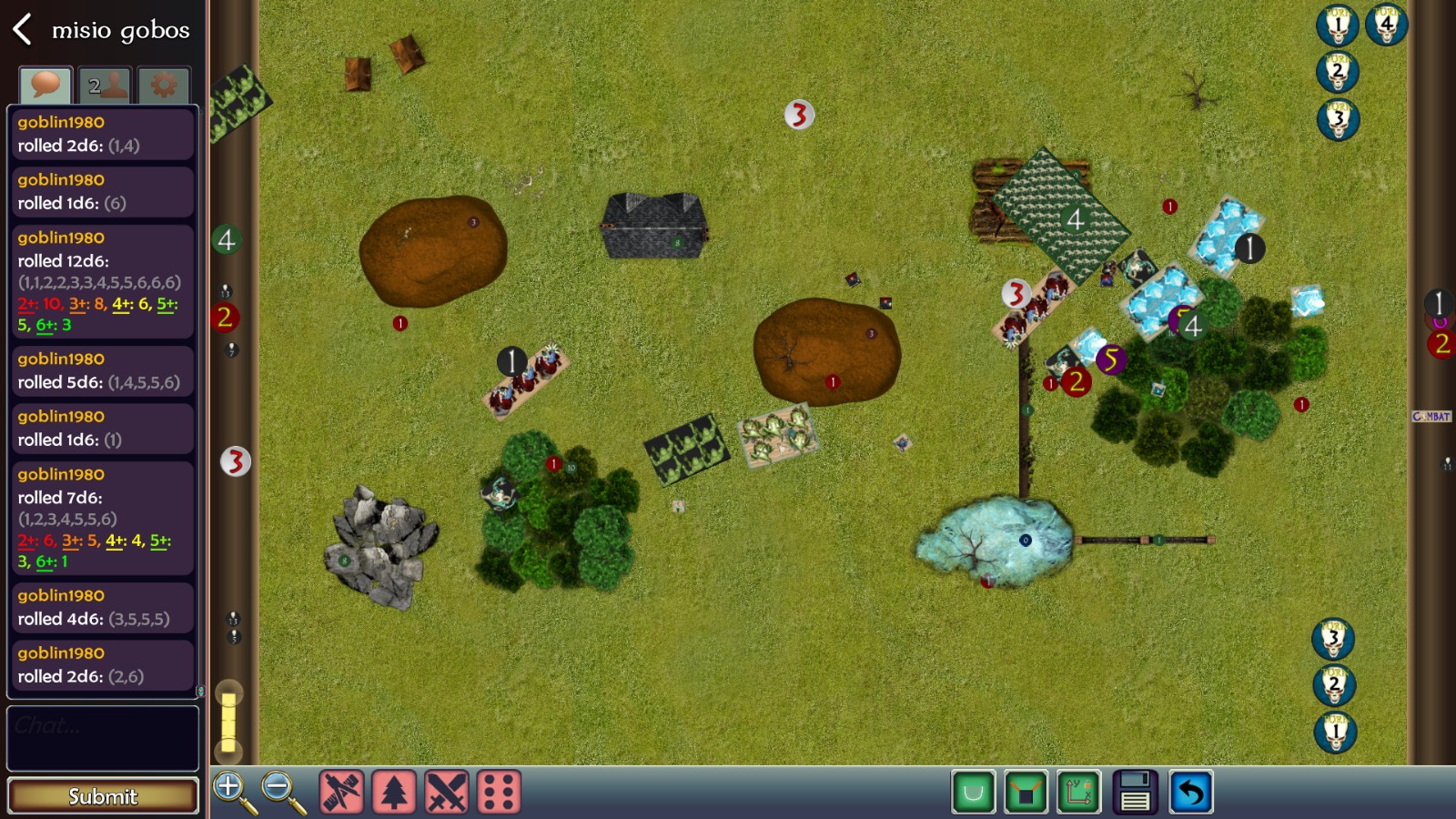

I have played the last game of our small UB2 tournament. On the TOP table!
It was a game against Undead built around zombies, zombie trolls and Goreblights (all with vicious from necromancers). We were playing Salt the Earth scenario. Interesting part was that we did not burn a single token as we were hoping to get control over them or were not in range. I was hoping to start the game with dambusters on the left to move 14" and pivot to burn far left token but Undead took the first turn so I had to reposition.
I was able to catch few flanks this game due to unexpected +1 charge range running Aquamage provided (my first charges of the game). Undead were unable to one-shot my units as his charges were single charges or hindered charges. I did a good job regenerating and grinding.
WE proved to be a bit swingy as always. I did take a legion of zombies from a combined charge from a horde (flank) and a GWE but was unable to take one legion out in one go from the rear charge with 54 attacks. It costed me a regiment of dambusters. Sadly. I should have front charged with them as well. To be sure.
This was also the first game where I used both surge casters. I had to withdrawal a GWE from the combat with a Goreglight and side step him to make room for a WE horde to be surged into a Goreblight. I then surged GWE back to the fight and took pesky monster down… in 2 turns :slight_smile:
The game ended with massive TR victory. I have lost only 3 units and almost cleared the board. 1 Necromancer fled the field alive and one Gorblight was hiding in the woods.
I still feel I need another Nokken horde for some short range shooting. I also like BC more than I like 2nd surge but I am not sure if replacing a WE horde with nokken and a better caster is the good way to do it.
