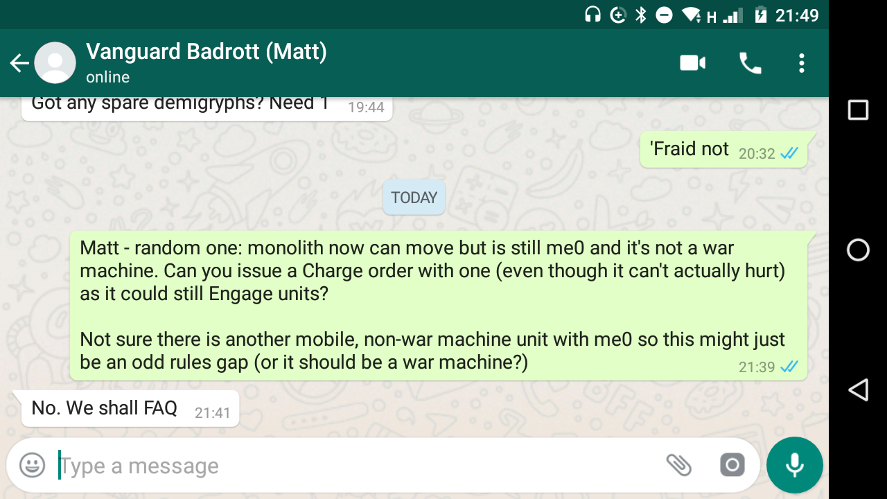

It could contribute if it was able to engage from the flank while others engage in the front, or vice versa. Even if it does not strike, it would count as taking away the option to Withdraw for the enemy.
I donât think there is another mobile, non war machine unit with me0, so likely to be oversight (when unit changed in v3 from being immobile) than intent?
The âbeing able to engageâ part of the charge is now much more important than in v2, even without doing damage - so a single odd unit that could do it would seem strange?
Weâll see. The questionâs out there for consideration one way or the other.
Its an oversight!
Wonât count as an official FAQ but hereâs a WhatsApp comment from Matt in the RC!
Thanks for providing the information here. Good to know the answer. I am still curious how they FAQ it. I think the Monolith should be treated as war engine but the RC may come up with a different solution.
