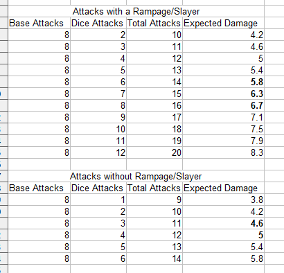

These reports have convinced me to rethink my auto-cleaver stance with Giants. I do think that’s the default with some Giants (like Coral Giants, where Kraken have rampage already) but there’s a lot more cav in the game, and the logic that Giants are already good into big stuff is sound. Those things also have lower nerve than the infantry hordes that you need more attaks to chew through.
Anyway! Thanks for the report! Nice list :wink: That rat army is great and I really enjoyed reading his blog, so thanks for linking to it as well. Wish I had a way to put it on a feed? And I can’t find a subscribe button either :confused:
Thanks for breaking down the Giant’s charges @DarkBlack!
If you roll super hot for everything, getting an outfitted Giant fighting against their preferred target can go very, very well, but if I mathed right on average the expected damage only looks to be about 2 above an outfitted Giant fighting the wrong target: Hitting on a 4+ really bottlenecks those extra attacks.
@Boss_Salvage is also dancing around the thought I was struggling to express in the conclusions: I think the target’s Nerve probably has been an unacknowledged factor in the perceived effectiveness of Giants and Slayer. Many monsters and monstrous units tend to top out at around 17-18 Nerve. Kitted out and fighting the ideal target, Giants could wallop these with some lucky dice. Quickly cutting through infantry hordes with around 22-23 max Nerve though was harder to do. However, lots of normal cavalry have 15-16 for their top Nerve (elites like Soul Reavers get up to 17), so Rampage Giants with hot dice can look really well fighting cavalry regiments, like my one Giant did here in this game.
Reading through the math here, just drives home how much I’ve been misusing my Giants. I think every game I run them I say I should support them and then don’t. Off they charge, by themselves, blending as good as they can and trusting in their high Nerve… but banking on extra attacks and good rolls is not a good idea. They should be supported better. We’ll see if I actually manage to do that next game.
