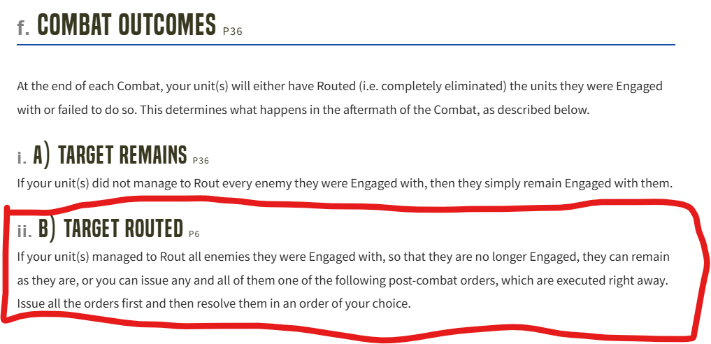

When a unit routs all enemy units engaged with it except a yielding individual, is it counted as having routed all enemy units and can do a post-combat order?
as yielding individual can be ignored when moving and shooting (even if Engaged with it), so is a post-combat order considered moving and therefore can ignore the yielding invidivdual?
An example would be I’m charged by a goblin rabble horde in front and flaggit on the side. I ikilled the rabble horde, but not the flaggit. Do I get my post-combat order or did the flaggit successfully pin me?
