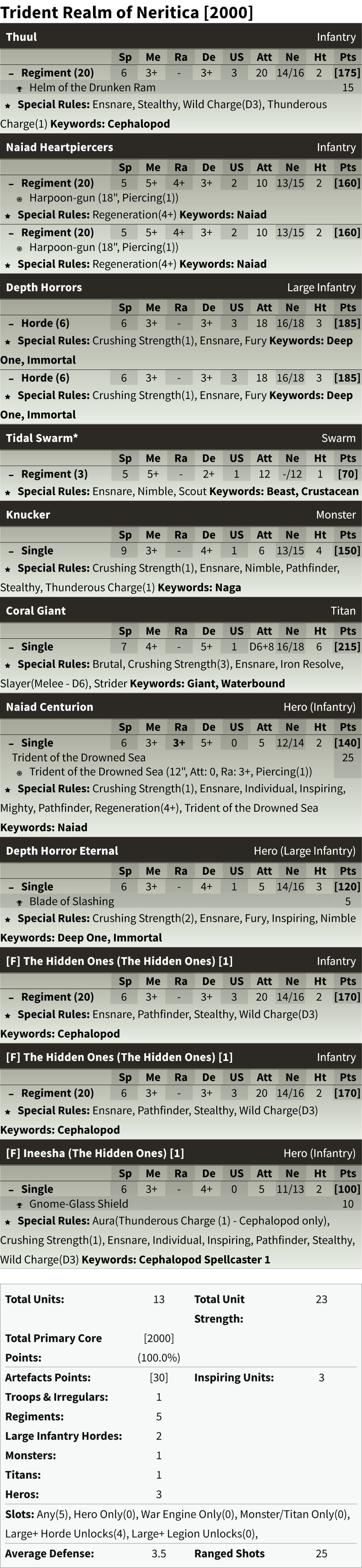

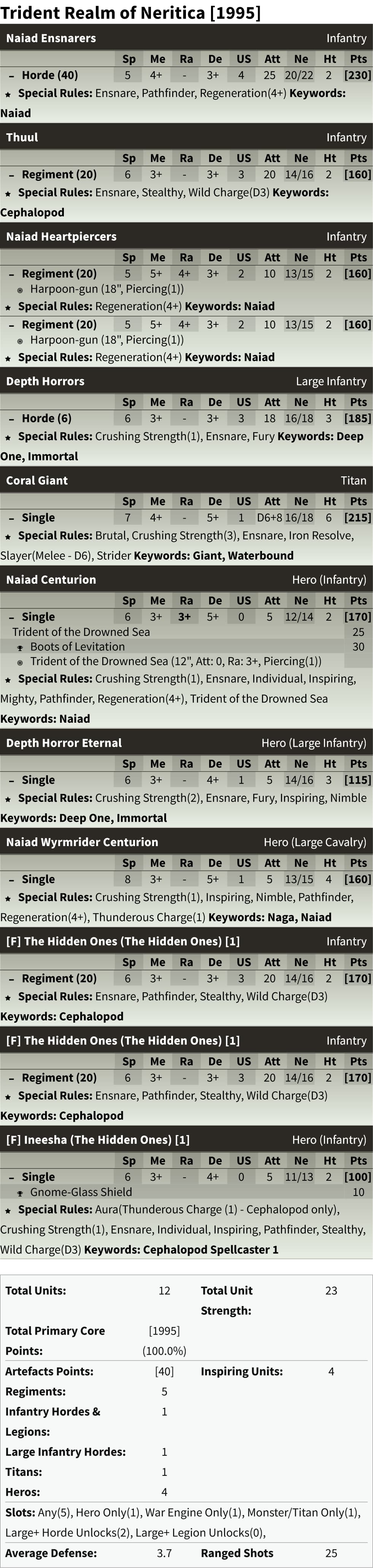

This is a list I took to a local tournament and finished #1.

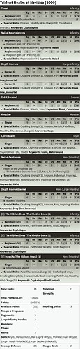

This is a version I would like to try out. Switched a Knucker to a NWC. We will see how she works.

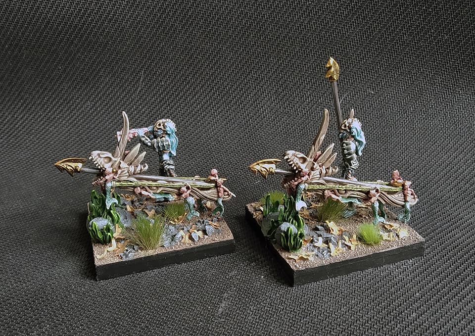

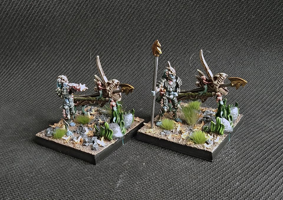

Also decided that it is time to finish painting (after like 5 years) my naiad horde to try this one (I will add 2 banes and maby a swarm or two in a 2300 version):
What do You think? More staying power… (would be even better with an Aquamage with barkskin!)

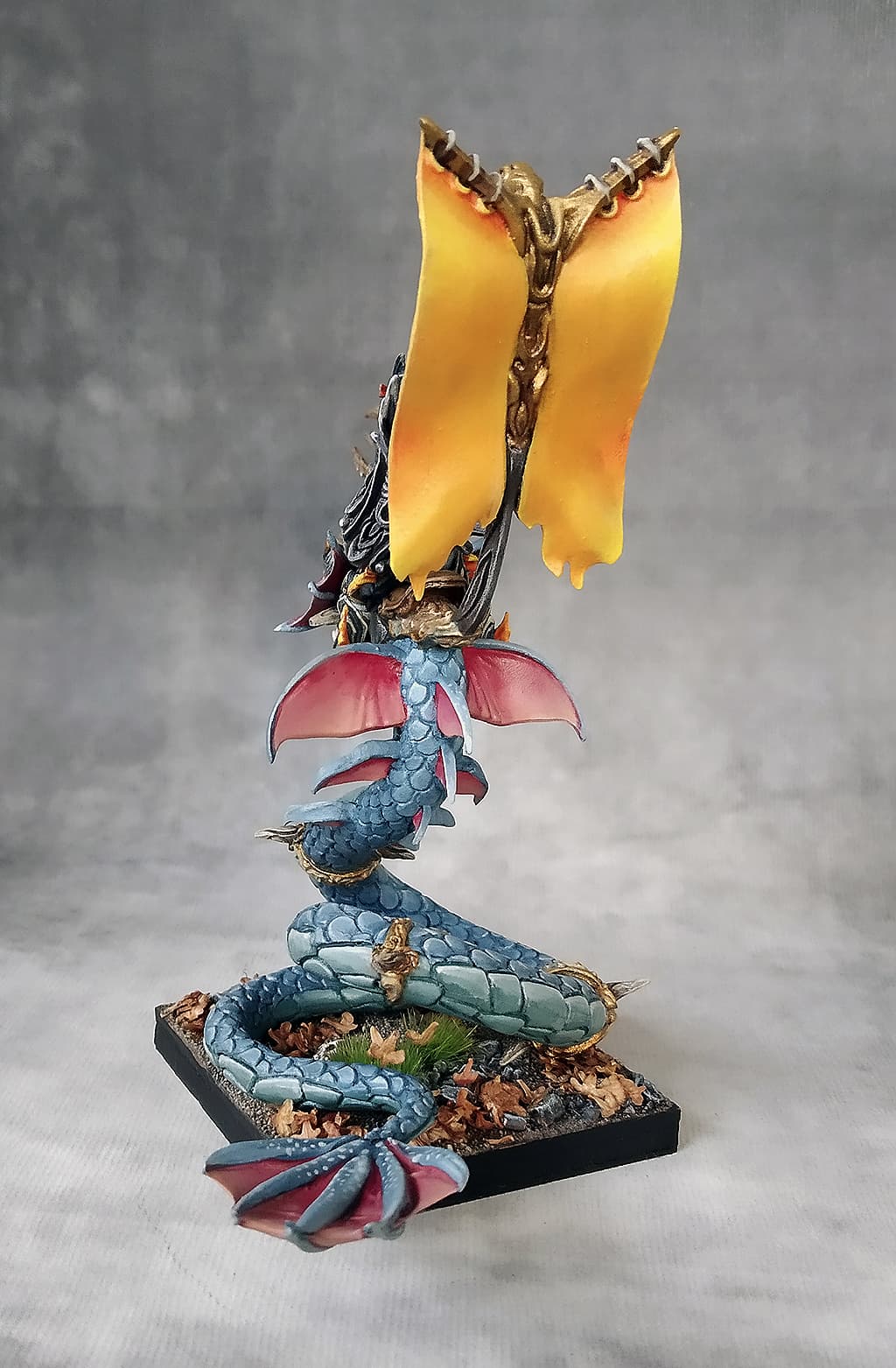

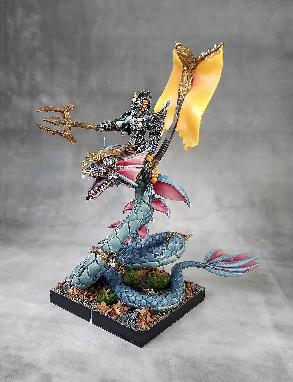

Really beautiful!
Awesome @MiSiO_1 ! Really well done (and very clean)! Colors really pop on those.
I especially like the shading on the scales and contrasting colors
