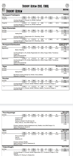

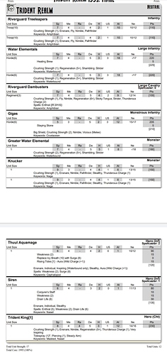

Anyway. CoK is out. I was shifting away from using 2 hordes of DH anyway. This is my recent list idea (2 versions). And an evolution of a list I use since 3.o came out.
What do You think about it?
I think I like the version with the GWE better, but I’d be temped to get another Surge in that version. I think both would also be better with Eckter instead of the Siren, but I respect wanting to play with Enthral.
I do not really care about Enthrall on siren. She is there to heal and weaken enemy units. (5) is not high enough to make It work. Dambusters will not add to the trick really. Maby It I had Dambuster Sentinel…
Well… Eckter is ok but I do not want him on every list. He is expensive and his best ability is windblast which I replaced with king’s Breath.
I think I like GWEe better but there is no way to get another surge if I want an option to heal. I could replace Siren with Aquamage no 2 with Weakness and surge and Icy Breath. Not a bad idea. With Shroud of the Saint.

Aquamage: Spells: Icy Breath (10), Surge (8), Weakness (2), Rising Tides [1] - Aura (Wild Charge (+1), Conjurer’s Staff
Aquamage: Spells: Icy Breath (10), Weakness (2)
I could also remove one Icy Breath and take Heal (3) item.
Pros: Extra inspiring. Icy Breath (20) or (10) and Heal(3) (I do not think I need 2 surgerers)
Cons: No Enthrall, no Drain (6).

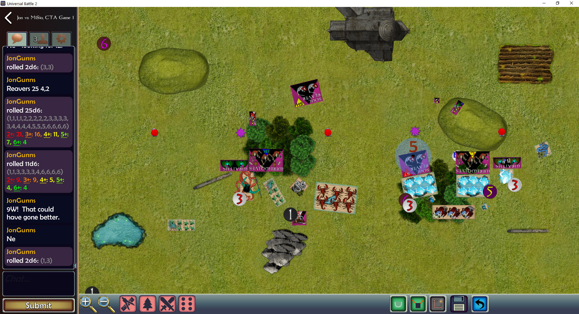

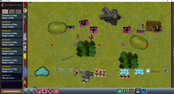

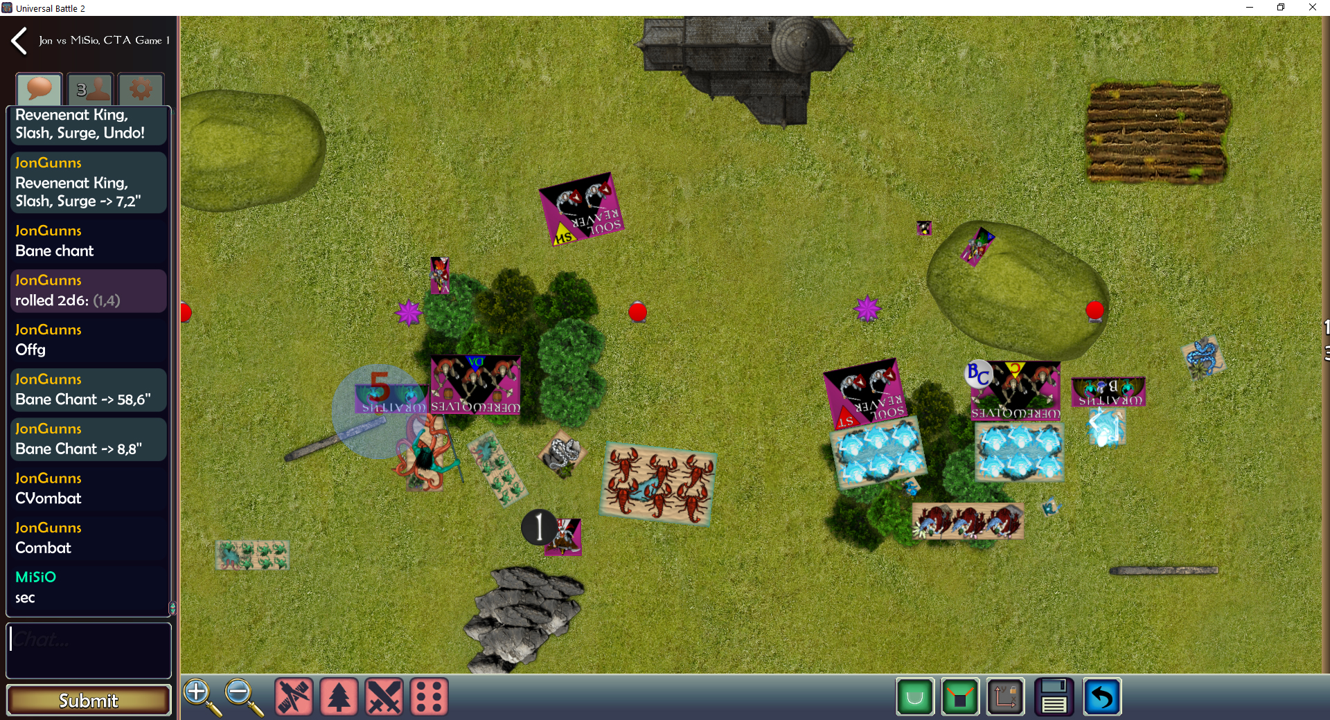

My first game was against Undead:
2x Soul Reavers (Sharpness, St)
2x Warewolves (Headstrong, Catepillar)
2x Wight troops,
1x Mounted Vampire,
1x Vampire of Pegasus (Beastslayer),
1x BsB (Lute),
1x Revenant King on a horse
I have used a WE/Riverguard list.
Undead resigned after turn 4. Last scoring unit was wavered. Final score 24:6.

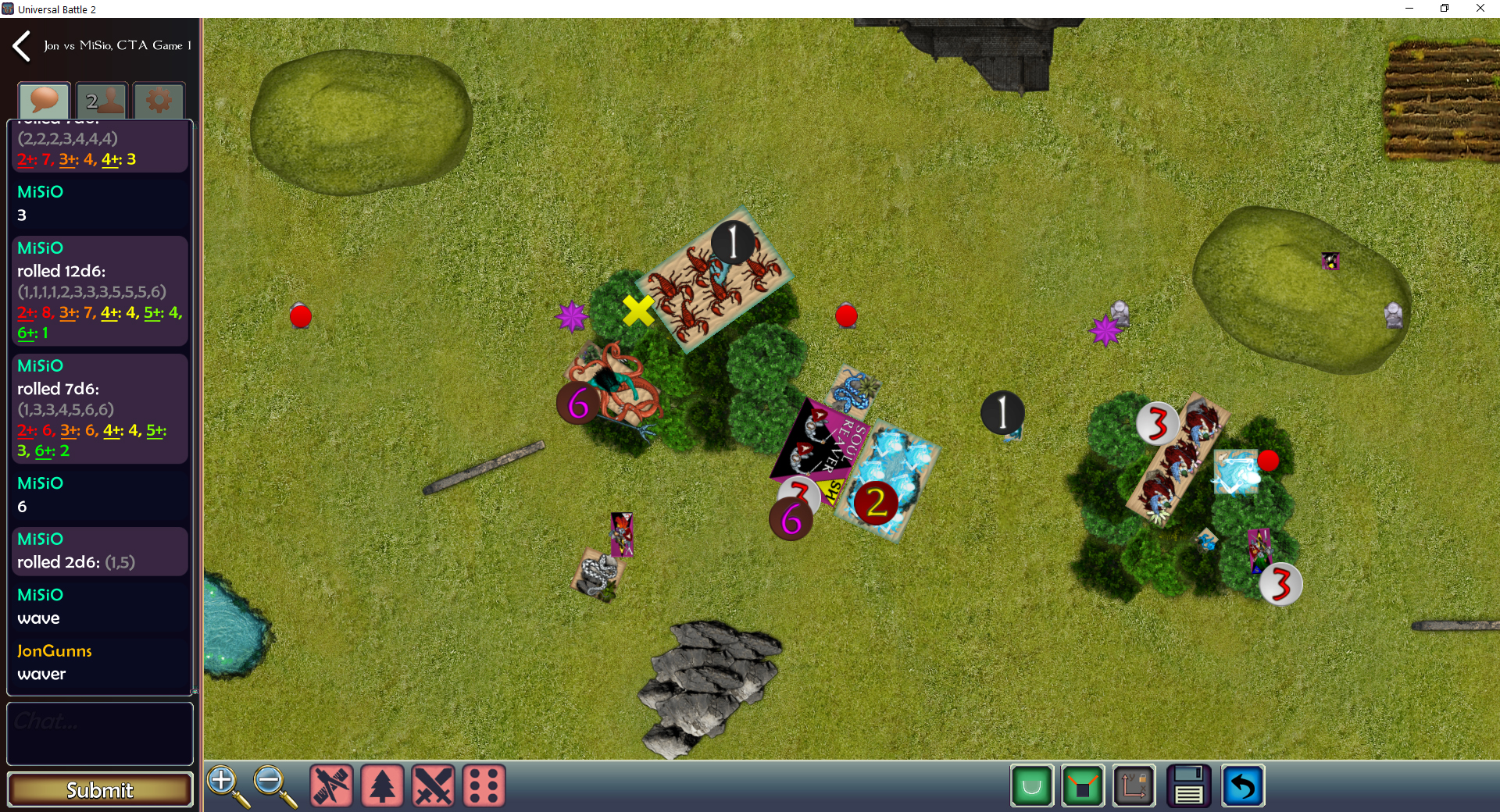

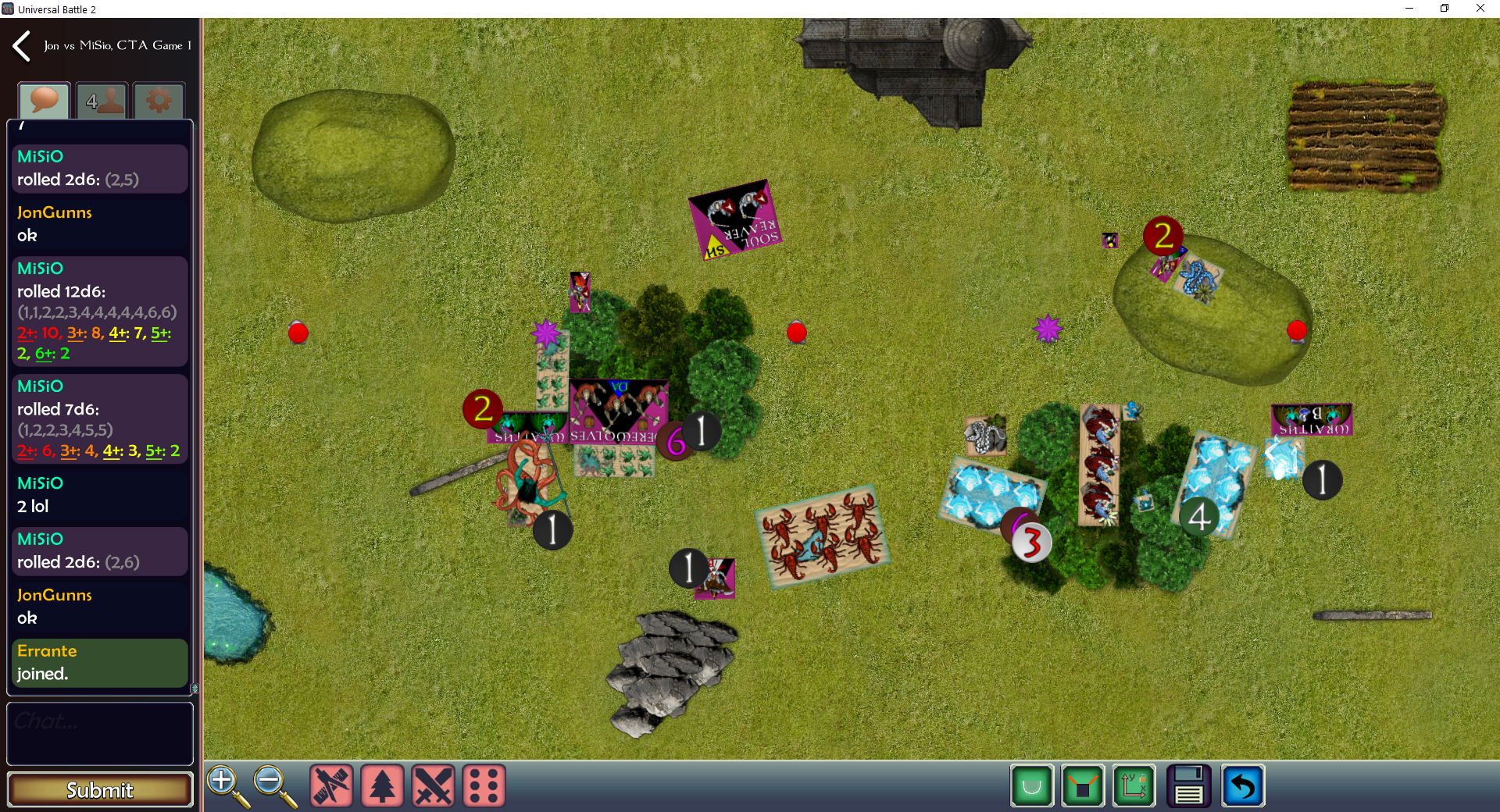

I did ok but wampires are H2 and once or twice was unable to Weaken them with a spell. Must have that in mind. Also I have to cover my arcs just a bit better. Minor things but could potentially harm me next game. I was able to control the amount of damage I take. Even a vampire horde can not one shot a -/17 horde (especially weakened). Rushing Tides helped too as I was able to pull an unexpected flank charge on a pegasus.

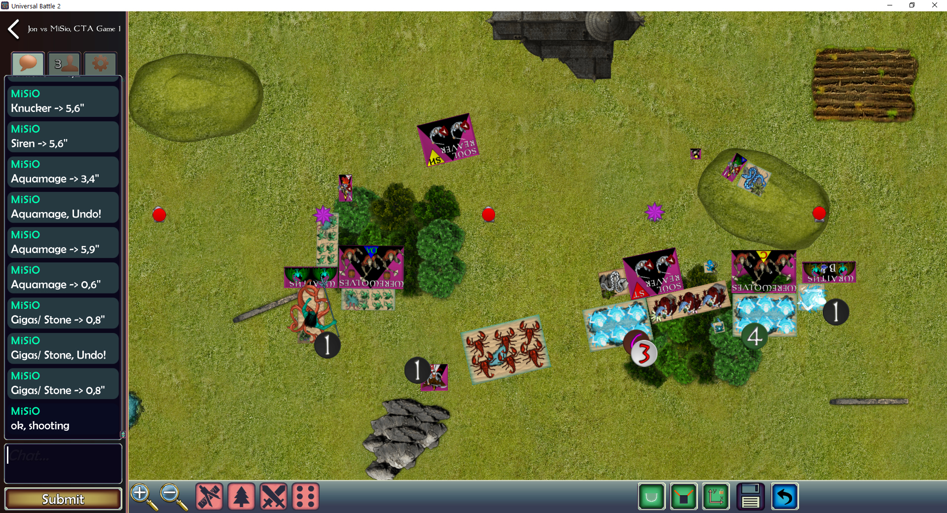

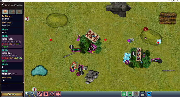

Thanks for the report! I like your list, because it uses elements that I’ve been thinking about including. Nice to see how you use them. I especially like the Treeleapers as a reserve to plug holes and prevent flanks.

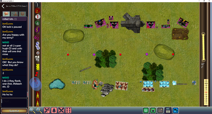

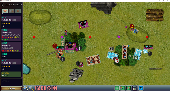

I think your opponent’s biggest mistake was spreading out their charges - doubling or tripling up on the water elementals is a must.

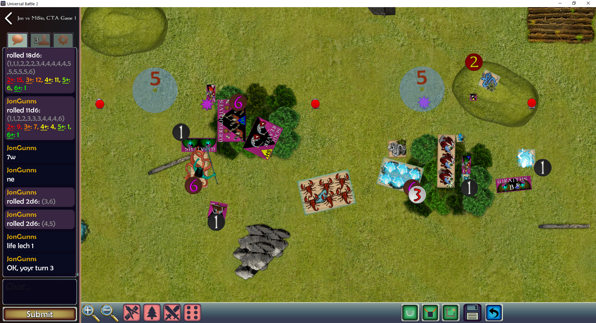

Thst was the threat I had to face. I gave him single charges. His soul reavers were less than 12" from my WE horde. He could back a bit but never enough to avoid WE Charge (15") and a Knucker to the flank. I forced him to Charge. His warewolves were faster than my right flank (except for a Knucker) but the rest was faster on my side.
Oh I assumed the werewolves could have combo charged! Not used to looking at UB, sorry.
No. There is a hilo that limitem their los.
As I also view it, the single charges were a mistake. Most likely, the best option the undead played had was to double charge the GWE with wraiths and werevolves. That way, only the wraiths could have been attacked by the WE, maybe killed but the werevolves would finish the GWE next turn. I would also not charge with the soul reavers, just reposition them to anticipate the knucler and WE charge to their front. The central-left werevolves and soul reavers could be prepared to charge next turn into the second fight. Sure, it would be a completely different game then. :slightly_smiling_face:
I was thinking this might happen too but I had several answers as WEs can deal with Warewolves long enough (especially with Drain support) for a Knucker to rear-charge. Not to mention dambusters. They add a lot of punch vs high def troops. 3-4 wounds makes a difference.
Dambusters could also flank Charge Warewolves. WEs could Charge wights to the flank (surge). Dambusters and GWE could counter Warewolves. 10-12 wounds with Drain support could easly waver them.
This flank was tricky. Also my favorite to set.
Thanks for Your analizis guys. This helps a lot.

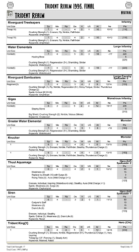

Anyway. Next round is a 2300 so I decided to expand existing build by adding some inspiration and something to force opponent moves into my charge range.
Decided to include:
  • Dambuster Sentinel (to work with Treeleapers and/or Dambusters)
  • Heartpiercer regiment (I was also thinking Treeleaper regiment but I think I need a main line unit and some shooting). Those few extra wounds are crucial for WEs/Toads/King to break units in one charge.

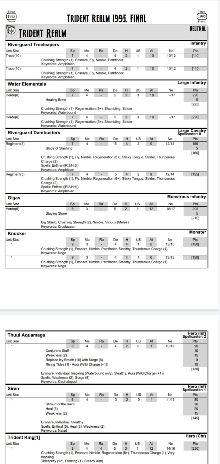

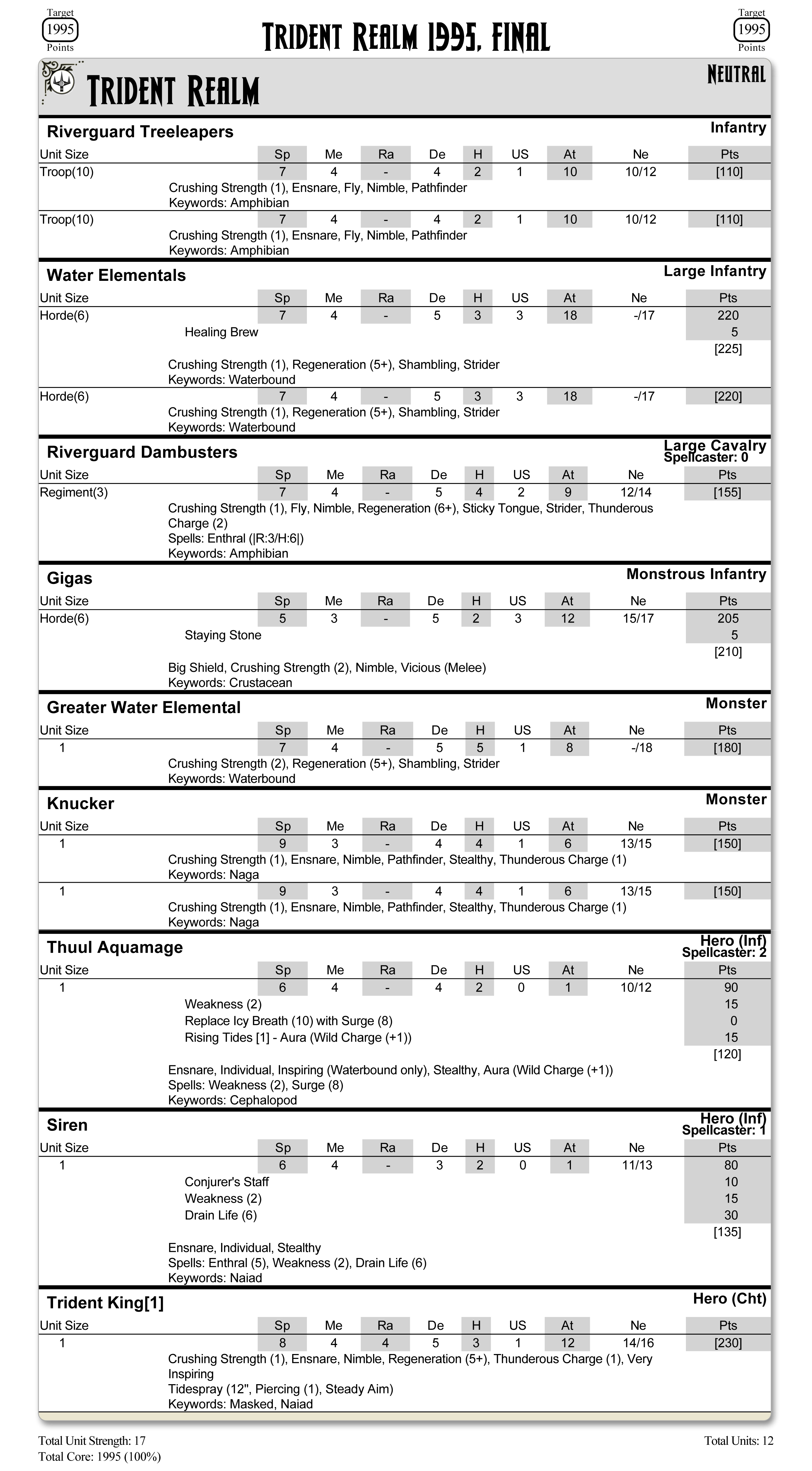

The list looks now like this:
Naiad Heartpiercers (20) Regiment [2 US, 160 pts]
Riverguard Treeleapers (10) Troop [1 US, 110 pts]
Water Elementals (06) Horde [3 US, 220 pts]
Gigas (06) Horde [3 US, 210 pts]: 05 - Healing Brew/Staying Stone
Riverguard Dambusters (03) Regiment [2 US, 155 pts]
Greater Water Elemental [1 US, 180 pts]
Knucker [1 US, 150 pts]
Riverguard Dambuster Sentinel [1 US, 150 pts]
Siren [135 pts]: 10 - Conjurer’s Staff, Drain Life (6), Weakness (2)
Thuul Aquamage [120 pts]: Rising Tides [1], Surge (8), sub, Weakness (2)
Trident King [1] [1 US, 230 pts]
