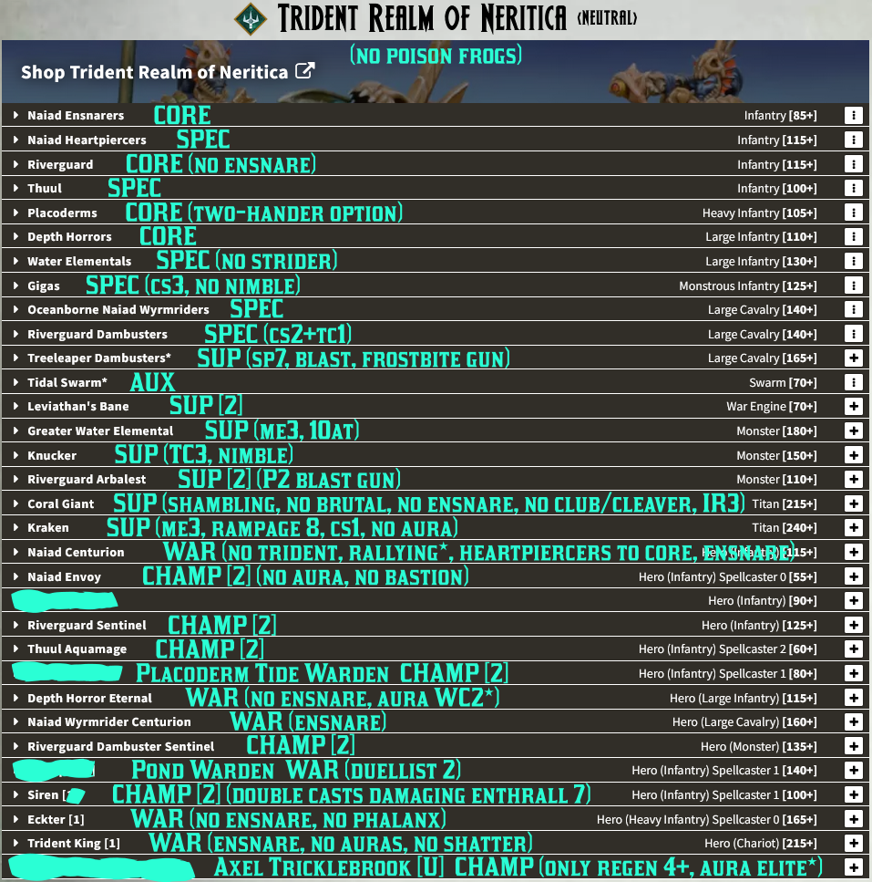

I pulled the transcript of the MUP TR coverage today and filled in as many points changes as they mention or infer:
| Unit Name | Unit Size | Pts | Role |
| Tidal Swarm | Troop | 60 | AUX |
| Naiad Ensnarers | Troop | 85 | AUX |
| Regiment | 115 | COR | |
| Horde | 210 | COR | |
| Riverguard | Troop | 125 | AUX |
| Regiment | 155 | COR | |
| Placoderms | Troop | 115 | AUX |
| razorswords | |||
| Depth Horrors | Troop | 110 | AUX |
| Regiment | 185 | COR | |
| Naiad Heartpiercers | Troop | 115 | SPE* |
| Regiment | 145 | SPE* | |
| Thuul | Troop | 120 | SPE |
| Regiment | 155 | SPE | |
| Water Elementals | Troop | 130 | SPE |
| Regiment | 205 | SPE | |
| Gigas | Troop | 140 | SPE |
| Regiment | 200 | SPE | |
| Oceanborne Naiad Wyrmriders | Troop | 150 | SPE |
| Regiment | 215 | SPE | |
| Riverguard Dambusters | Troop | 150 | SPE |
| Regiment | 225 | SPE | |
| Treeleaper Dambusters | Troop | 185 | SUP |
| Leviathan’s Bane [2] | 1 | 95 | SUP |
| Greater Water Elemental | 1 | 225 | SUP |
| Knucker | 1 | 225 | SUP |
| Riverguard Arbalest [2] | 1 | 100 | SUP |
| Coral Giant | 1 | 195 | SUP |
| Kraken | 1 | 235 | SUP |
| Naiad Envoy [2] | 1 | 105 | CHA |
| Placoderm Tide Warden [2] | 1 | 145 | CHA |
| Riverguard Sentinel [2] | 1 | 150 | CHA |
| Thuul Aquamage [2] | 1 | 95 | CHA |
| heal 3, lb 3, surge 8; lib | |||
| Siren [2] | 1 | 155 | CHA |
| enthrall 7 x2; lib | |||
| Riverguard Dambuster Sentinel [2] | 1 | 165 | CHA |
| Axel Tricklebrook [U] | 1 | 185 | CHA |
| Naiad Centurion | 1 | 195 | WAR* |
| Naiad Wyrmrider Centurion | 1 | 230 | WAR |
| Depth Horror Eternal | 1 | 170 | WAR |
| Riverguard Pond Warden | 1 | 195 | WAR |
| Eckter [U] | 1 | 210 | WAR |
| wind blast 8 | |||
| Trident King [U] | 1 | 315 | WAR |
Points I’m not sure of in italics. I’m still shocked at how expensive heroes are, as much as I intend to make envoys still do something ![]()
EDIT: I am just realizing that the army has no access to bane chant. That’s kind of rad from a balance perspective, and certainly puts more emphasis on order use (give vicious, for example).
Maybe people get some ideas/inspiration from that one
Thanks! I’ve used the points they mention to flesh out the table above. At this point we don’t know about Ensnarer troops or hordes, Water Elemental troops, and how much Aquamage’s spells are (but thus far caster spells have been very similar to 3.5E).
Also worth noting the changes to Tidal Swarms. They lost ensnare, nimble, and the shooting option, but kept scout and changed to Sp 5+, Me 3+, De 4+, Att 9, Nv 15, H1 large infantry. For 60 points. That’s pretty wild IMO and, as MUP points out, you can give them the enthrall command to be even more annoying chaff.
